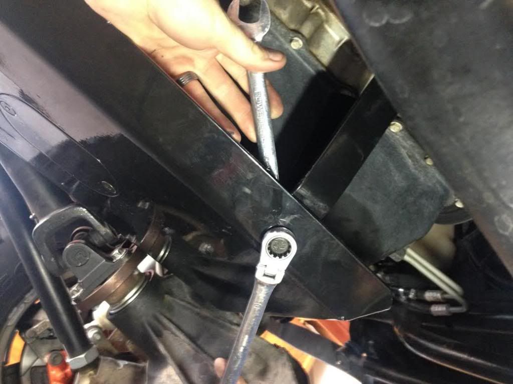

Step 10
Remove the M10x30mm hex nut, washers, and nylock nut from driver side bracket so the front part of skid plate drops down again. Now use drill and the 7/16” drill bit and drill a hole where you made the mark on the inner skid from Step 8.
Step 11 & 12
Using (1) M10x30mm hex bolt, (2) flat washers, and a nylock nut, attach the support bracket to the driver side skid plate. Only screw in a few turns, do not fully tighten. You will use a 16mm & 17mm wrench to tighten.
Repeat Passenger side

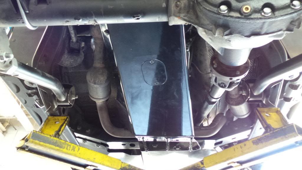

Step 15
Tighten down the 2 skid plate bolts to cross member and torque to 55ft lbs.
Congratulations!! You are now done installing the Rugged Ridge Engine & Transmission Skid Plate
