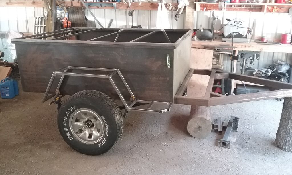

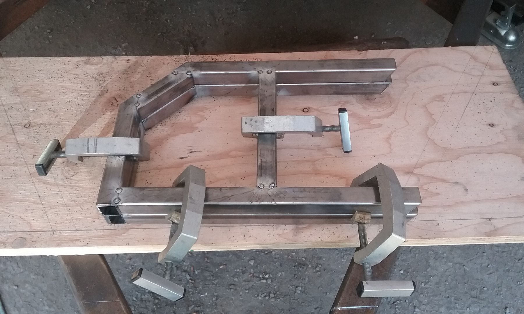

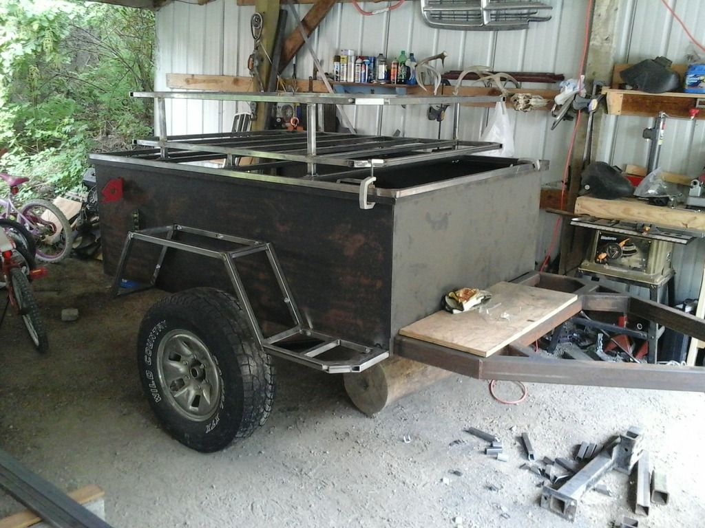

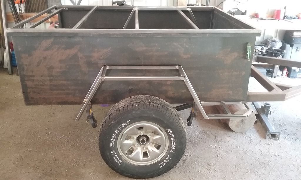

^^^I finished one side step, and got the second tacked welded together, I was pretty happy with my clamping method, the second step turned out a near perfect match...that's when I realized I needed to make it a mirror image for the opposite side so my 30° cuts where the steps meet the fenders are on the wrongs side..DOH! Luckily it's only tacked together, one of the peices I can flip over then re-weld, the other had a 45° angle cut on one end and a 30° on the other, so I'look have to recut that peice...always seems like one step forward and two steps back.
Here's a pic of the passenger step in place.
It didn't take long to burn through 80 feet of 1" square tubing, I have just enough to fix the driverside step and add some braces between the stringers on the lid to tie it all together and make it all little stronger.

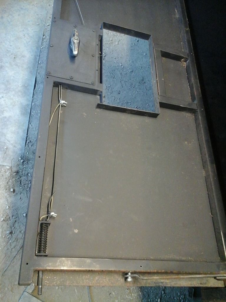

Anyone have some tips or advice for skinning the lid? I was thinking of starting by welding short beads starting in the middle of the lid on the stringers and working my way from the center out, I'm hoping that would prevent the lid from warping further, what do you guys think?
^^^The other idea I had was to drill a series of holes through the 16 gauge sheetmetal spaced every couple inches around the whole lid parameter and across all the stringers and then plug weld the holes welding the sheet to the frame. When its done it would kind of have that rivited look to it....

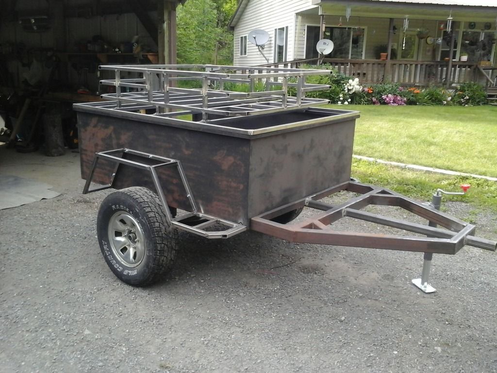

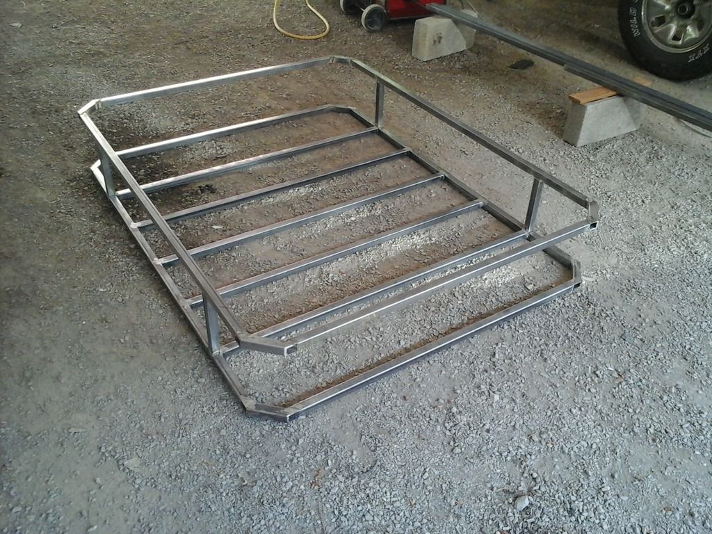

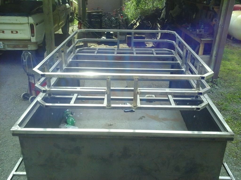

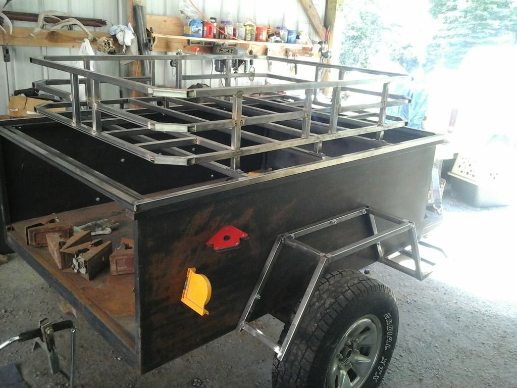

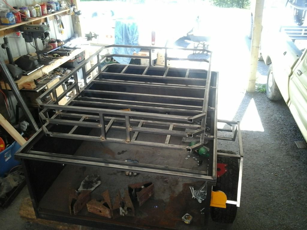

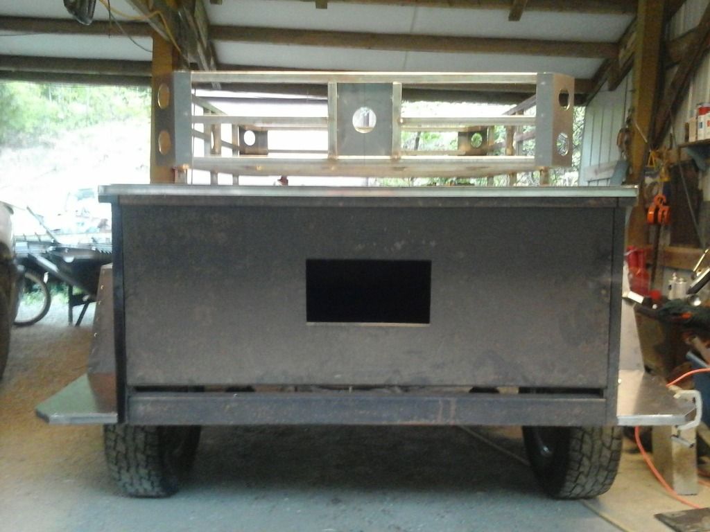

I received all the electrical parts listed above, also picked up 100' ft of 1" square tubing. Started building the cargo rack for the hinged lid. My brother wanted it 4' wide by 5' long and 10" depth... here is where I'm at so far. Still need to add some braces, and finish welding it up. I'm also going to add some sheet metal to wrap around the 45° corners to close off the square tubing and give it a more finished look.

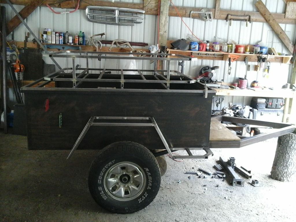

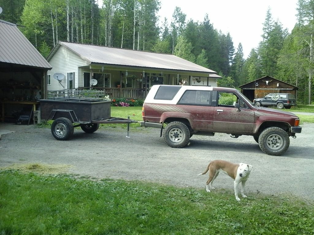

I got a little more work done on the trailer today.
^^^I got the safari rack mostly done, added more cross bars for support, just need to wrap the 45° corners with sheetmetal to give the exposed cut 1" tubing a more finished look, and weld up the rest of the seams. Switched gears for awhile and worked on the the trailer tongue.
^^^I didn't like the way I originally built the front portion of the trailer frame for the tongue. I built the frame a few years back, and before having discovered this forum. Since joining I have gotten alot of good ideas from other people's threads (there are alot of things I would have done differently on this build...maybe on the next one!) I welded in a temporary brace (not shown) to keep the frame rails true, and cut off the end of the tongue A frame. Then I notched out the frame rails for the new peice to fit in, by doing it this way the ends are boxed in, and should be stronger. Then I cut out the square hole for my 2" by 1/4" wall tube to slide through. I'm alot happier with it now. pics below of the revised tongue. Still need to finish up welding the tongue and the receiver.
^^^Reworked the trailer tongue, got it nearly finished, also got the tongue jack mounted.

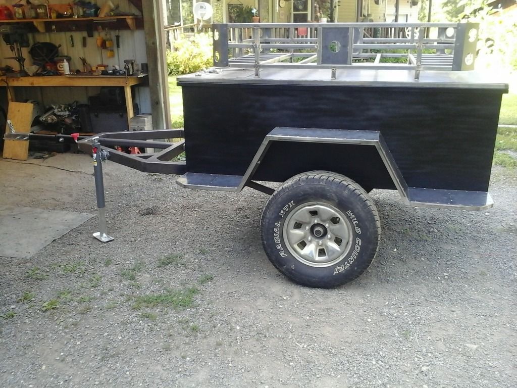

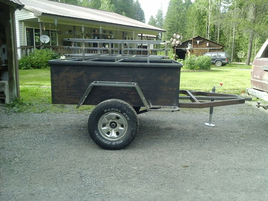

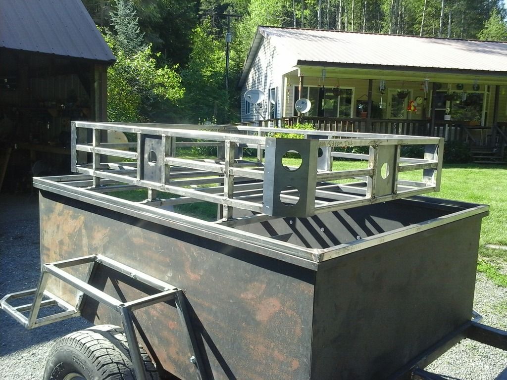

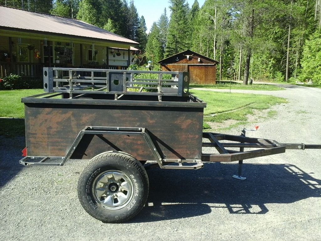

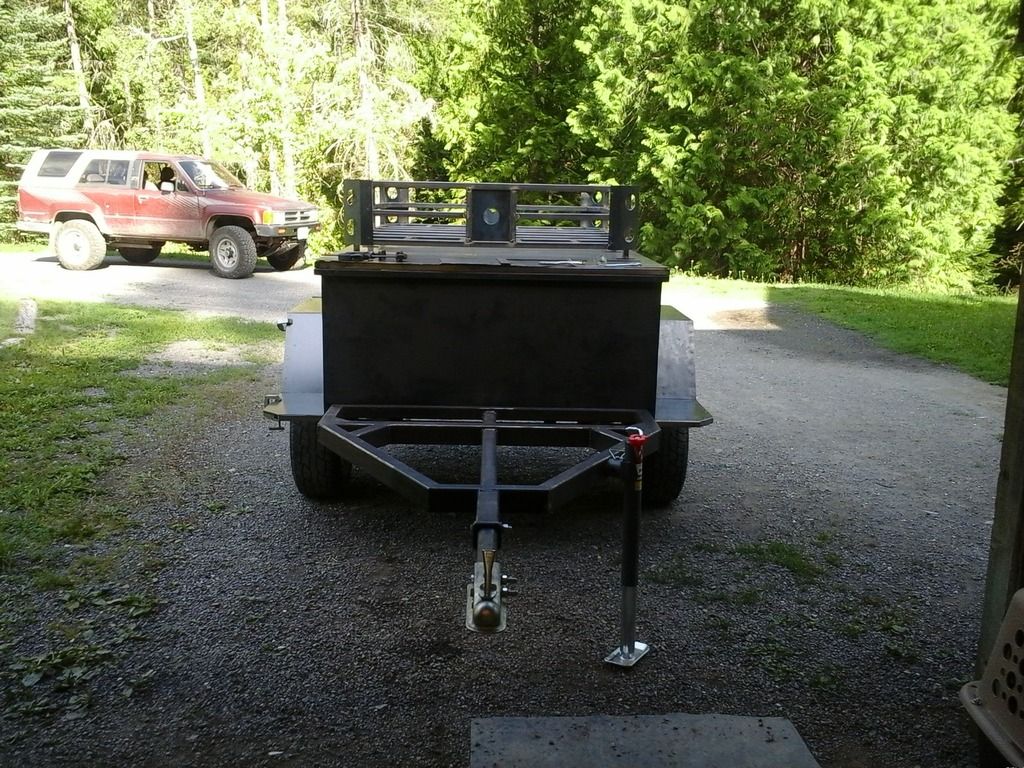

I got a little work done on the trailer today, not nearly as much as I hoped. I got the cargo rack finished, wrapped the 45° corners with 16 gauge sheet metal. I thought it looked kinda plain, so I got out the hole saw and cut out some 2-1/2" holes. I really wish I had a press and dimple dies, that would have really given it a nice look, but I'm pretty satisfied with how it turned out.
I also finished the tongue, got the receiver tube welded on and the ball/hitch bolted on, still need to add the safety chains. Added the rear steps behind the fenders, got both sides finished.

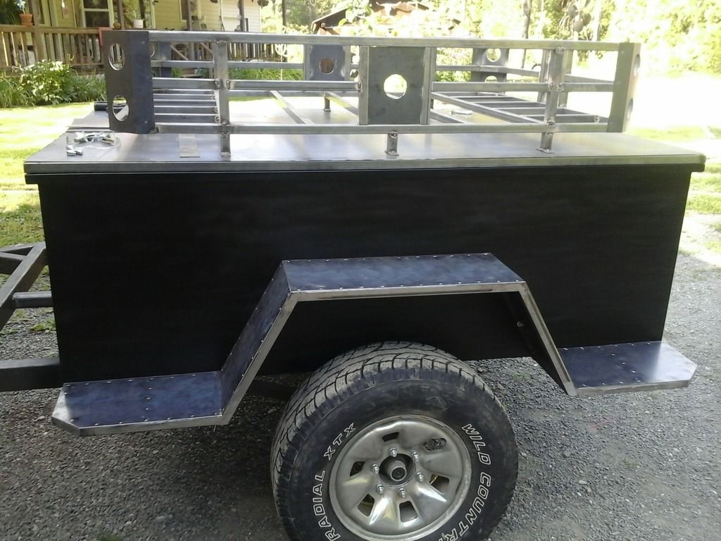

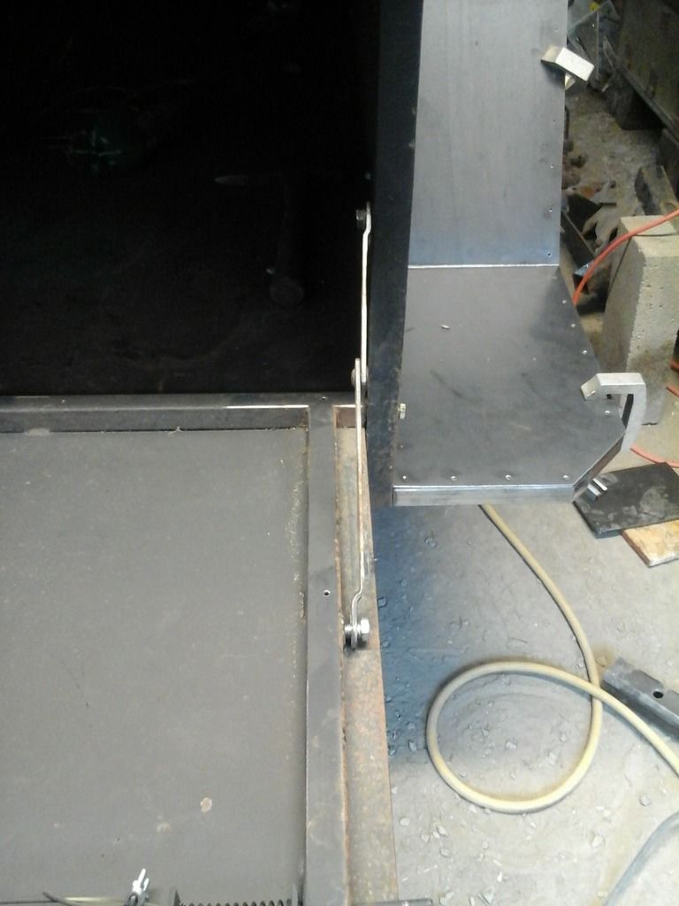

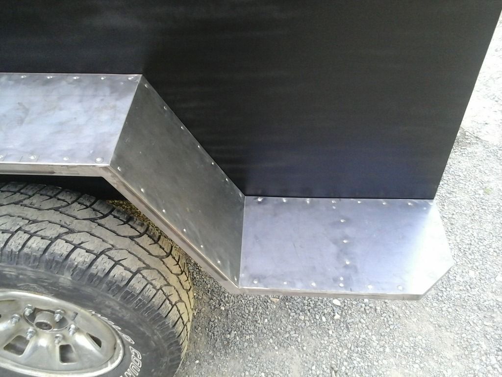

I started skinning the roof. I'm already quite a bit over budget on thus build, so rather than use the 3M adhesive that I was contemplating earlier I just went ahead on welded it. I'm not to happy with it, I started in the middle and worked my way out to the sides. I was just doing short 1/4" long tack welds spaced out every 4" or so. But it still warped pretty bad. I don't have any pics. It's not that noticeable with the cargo rack mounted, unless you squat down to eye level and look at it. I might see if I can borrow a torch and heat it up and try straightening it some. I think my brother is going to use bedliner on it anyway, so some texture might help camouflage it.
I didn't want to risk warping the fender skins, so I tried a different approach. I drilled holes spaced out every 2-1/4" then tack welded the sheetmetal to the fender frame filling the hole. I was going to grind down the welds, but I kind of like the look, gives it a riveted look. I might go back and do the outside parameter of the lid so it matches.
I also got the tailgate working again, I had robbed the cables off it for some other project, lol. Still need to modify the driverside tailgate stop (thing-ama-jig) they were originally off a first gen yota.
