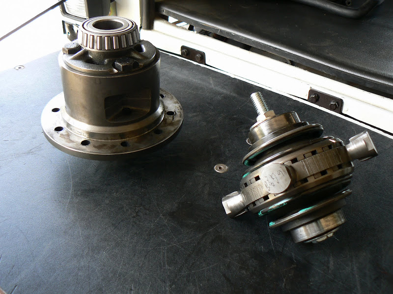

With the long wheelbase of the 109 the Detroit should be pretty quiet on the road.
The Detroit in my 110 is invisible. It's even better behaved than the one in my Disco.
And it's an easier install.
That's a TT on the left and a Salisbury DL on the right.
I still have my Detroit sitting on my bench waiting to install. The TT is slated for my front end but that is a ways off. I dont anticipate any issue with my wheelbase.
