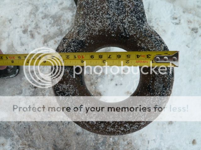

skids
Noy my picture but hope it helps
nick disjunkt
You will definately want a nato type hitch. Dixon Bate make the classic UK MOD pintle if you want to buy new, or the European type V.Orlandi UN 76 range is also specifically designed for the 76mm nato ring found on sankey trailers. Ebay will bring up a load of cheap Dixon Bate nato couplings.
You can use a standard pin hitch if you are just moving the trailer around your yard, but it'll bang around too much for general use.
The ring rotated on the narrow sanky I used to have
