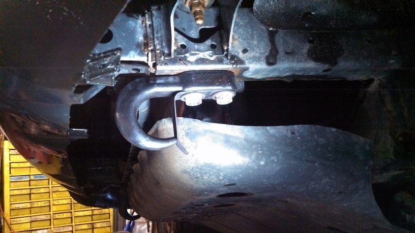

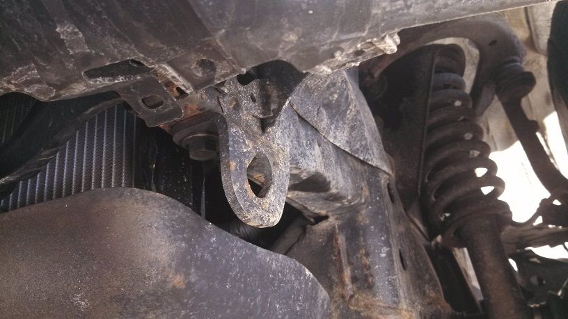

You could swap out your drivers side vehicle tie-down w/a 10K hook. Bolt holes line right up, but go to your local hardware store and get the correct length bolts.
Here's mine on my 01 DC Taco:
Before:
After:

Thanks! That's what I was thinking about. Your frame looks amazing... how the heck did you keep it like that? I'm thinking it was a frame replacement...
