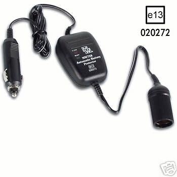

Looking for a simple DIY product to protect my FZJ80 battery from discharge when sitting or running accessories. I looked on the web a bit and found nothing. Any ideas?

You might try a small solar panel that sits on the dash and plugs into the cigarette lighter or other 12v socket. Not many watts, but works fine for a small draw, is inexpensive, and available from many sources such as Harbor Freight, Pep Boys, etc.
Like this:
http://www.harborfreight.com/cpi/ctaf/displayitem.taf?Itemnumber=44768
1.5 watts, $9.99
or
http://www.harborfreight.com/cpi/ctaf/displayitem.taf?Itemnumber=41144
5 watts, $34.99

You guys are great...
The Battery Brain is exactly what I was looking for - and simple (DIY) installation.
Many thanks to you all.

Thanks, Jim.
Always good to save some money. I think I'll do the remote control model.
Will using this device result in ECU reset when it isolates the battery? I expect so. Likewise with the remote control feature. Hmmmm.

Mike S said:
Thanks, Jim.
M
It probably would reset the ECU, but I have mine set up differently. I have the battery brain installed between my battery and aux fuse block, this way none of my accessores can kill the battery.
