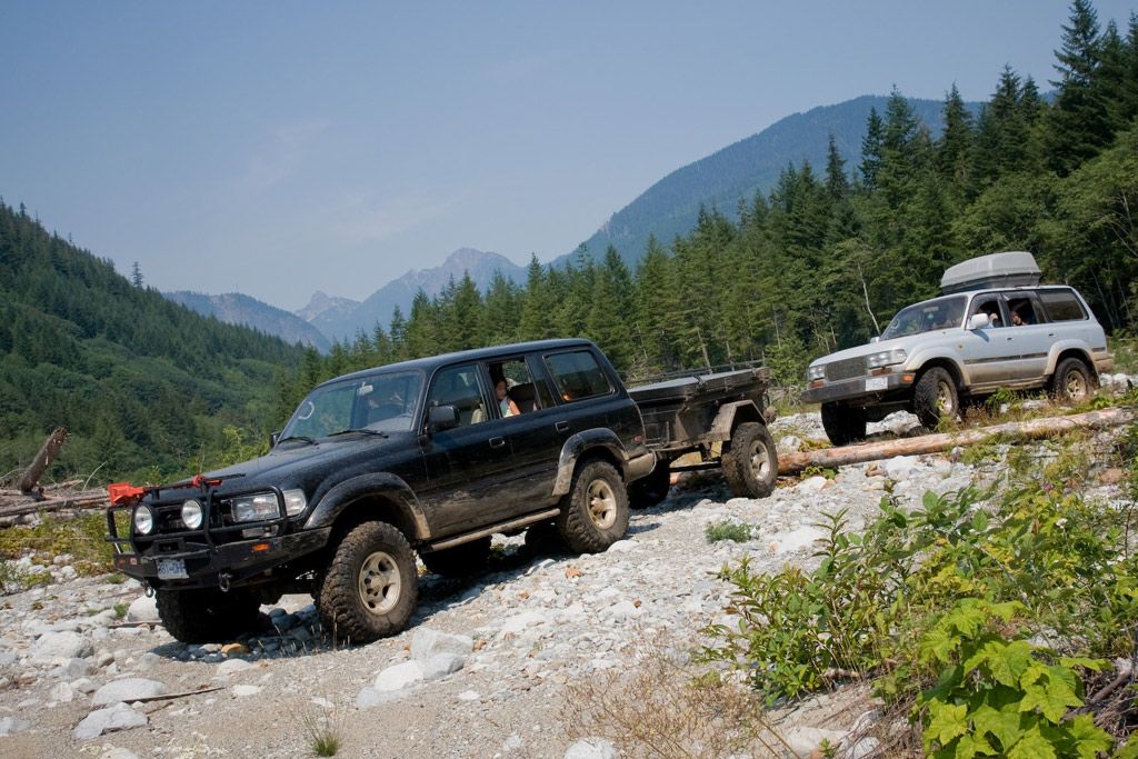

i run 315's on the 80, and 295's on the trailer. i had a pair of 315s on the trailer originally, but it was just too fat and bulbous for it without widening the fender. so i went 295 ATs. much better, still sits level, and can use as spares in a pinch. had a bit more room in the wells than the 315's did too.
the cdn m101 axles are 3500#. i switched out the oem 5 bolt drums to 6X5.5..got them from southwestwheel.com. complete with new bearings, seals, dustcap and lugs. it was a direct swap. most likely the axle youll be using will be able to use the 6 bolt hubs. did the spring over at the same time.
ill agree with kurt in that the close you can get the trailer tires to the to wrig tires, the better. makes following the lines of the tow rig easier. took my setup for a test run over some rough terrain...and was impressed how well it did.
and since we all love pics, heres my setup.
