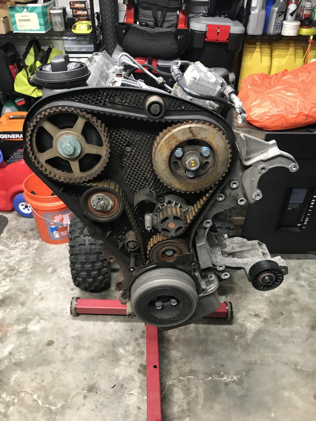

So I have a minor update. The deal with the AHU fell through, but happened upon a 01 ALH with 70K miles for $736 shipped. After weighing the pros and cons of the ALH vs AHU, I decided to go for it.
Still thinking MTDI using the Rover pump, which should actually be pretty easy to get mounted using the ALH bracket and pulley/ hub assembly. Hardest part is really going to be engine mounts and oil pan. Seriously considering throwing down for the FAS inline conversion kit. This would save the fab time for the oil pan and mounts, and would keep it below the deck lid. I could then use the gasser trans from my parts van and be able to sell off all of the diesel parts from the 82 to recoup some cash.
Any way, I managed to get it on the stand and cleaned a bit of the northeastern road grime off of it. I started striping it down to give the block a new coat of paint. Will finish next weekend and be waiting on parts again. Overall it looks pretty good, has a little more rust flaking on the block then I would like, but looks mostly cosmetic. Timing belt looks great, no cracks or dry rot. Will still be doing a full replacement of timing belt, water pump, gaskets and seals before putting it in the van. One thing that always stands out on egr equipped engines is the amount of soot in the intake runners. While probably no big deal, it bugs me to no end when I rip into a motor and see so much gunk in the intake. I will likely just leave the head alone and clean the intake, but man its tempting to pull the head and clean/ port the runners a bit.
