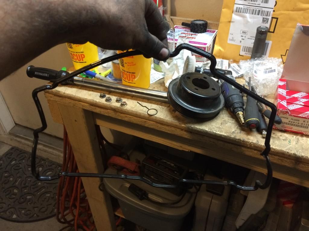

x3 on valve cover gaskets. They will leak down on the exhaust manifolds and give that hot smell. I changed mine at around 193K, they were so dried out they could pretty much stand up on their own.
