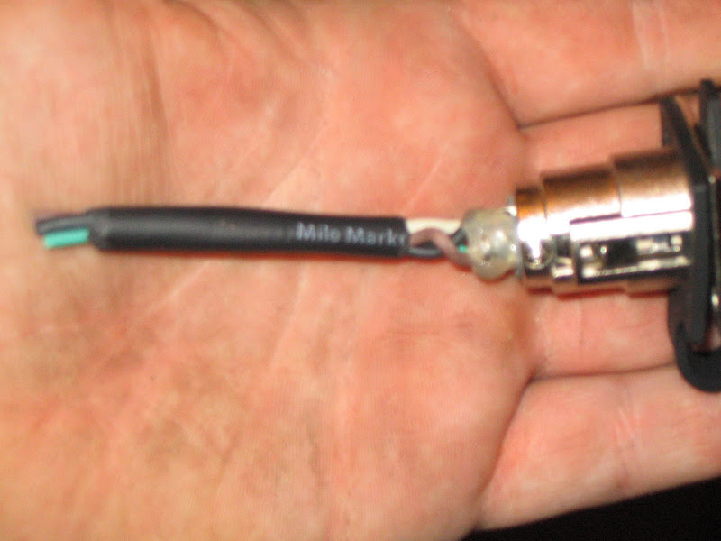

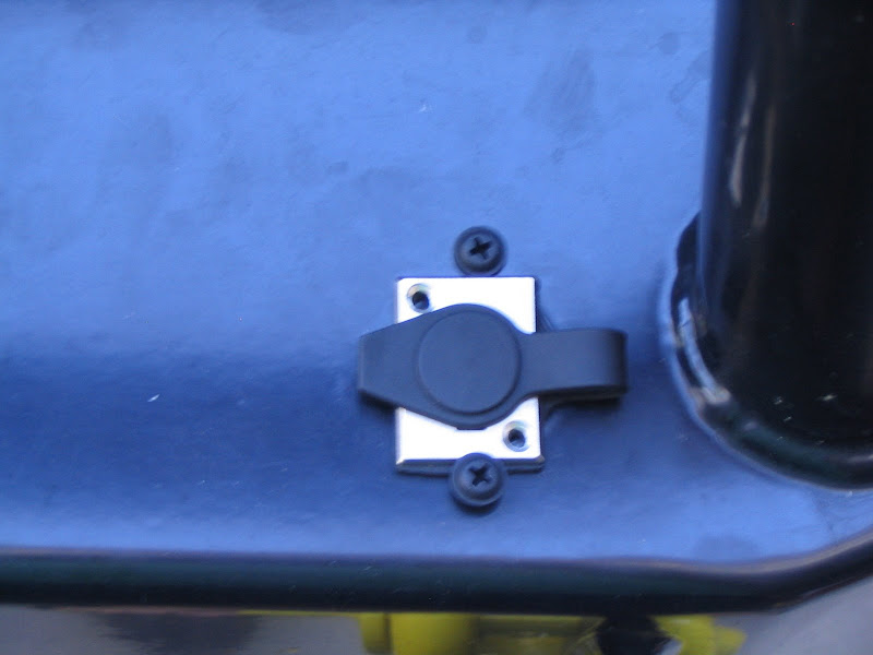

So true... The box is 3/4 size larger than the solenoid itself, the solenoid on the inside is 1/4 the size... We took ours apart and mount it on the cross member near the radiator, re-route your plug to where you want it and your good to go.
Here's the Solenoid:
Snip the plug:
Mount your plug in where you want and re-wire:
And your good to go!

Am I reading the one photo correctly? Does it say "Mile Marker" on the cable?
