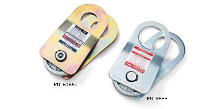

I have the Warn unit as well, which is also good, but lacks the ability to disassemble or grease.

I have the warn 61560 which is 19,000 lbs!!!!
