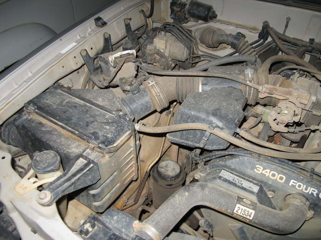

I have a k&n intake on it right now, bought it that way so I don't have any factory intake parts...I guess I'll need some of that stuff too. do you have any pics of your setup under the hood?

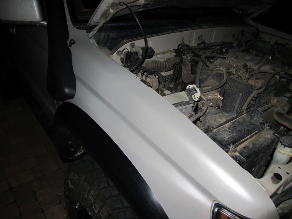

Hang on... I'll go snap one for ya!

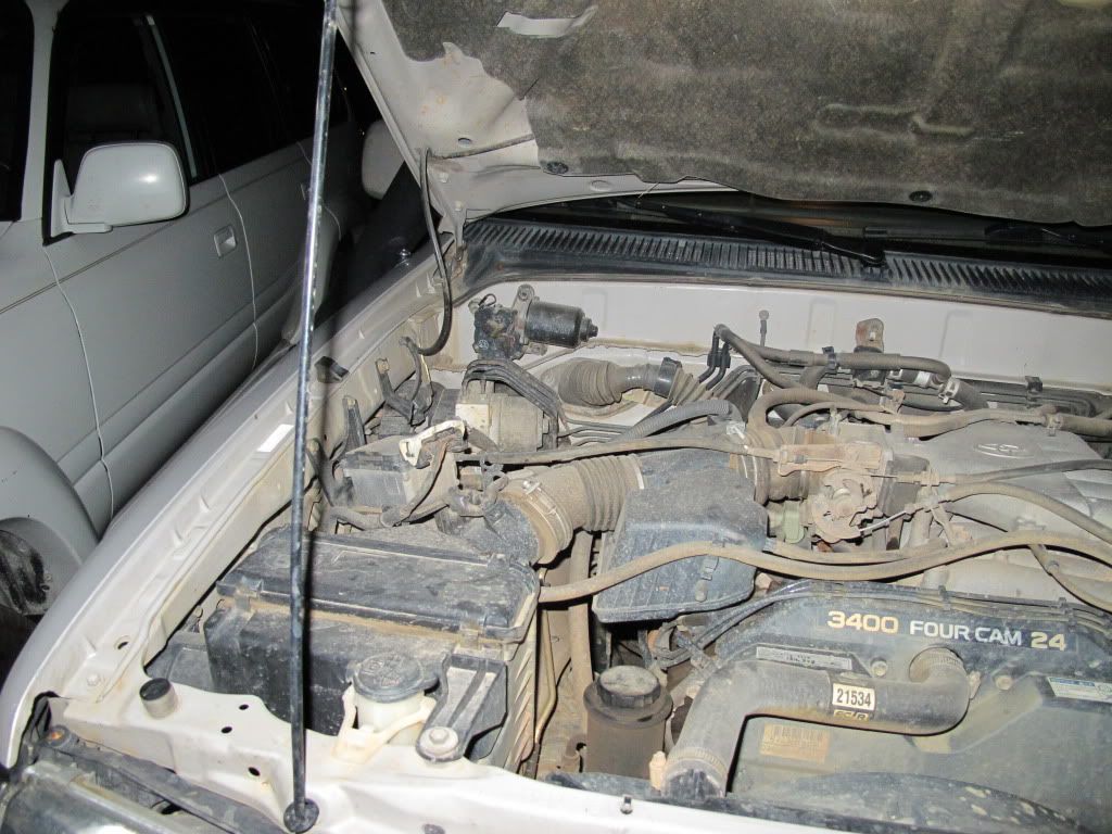

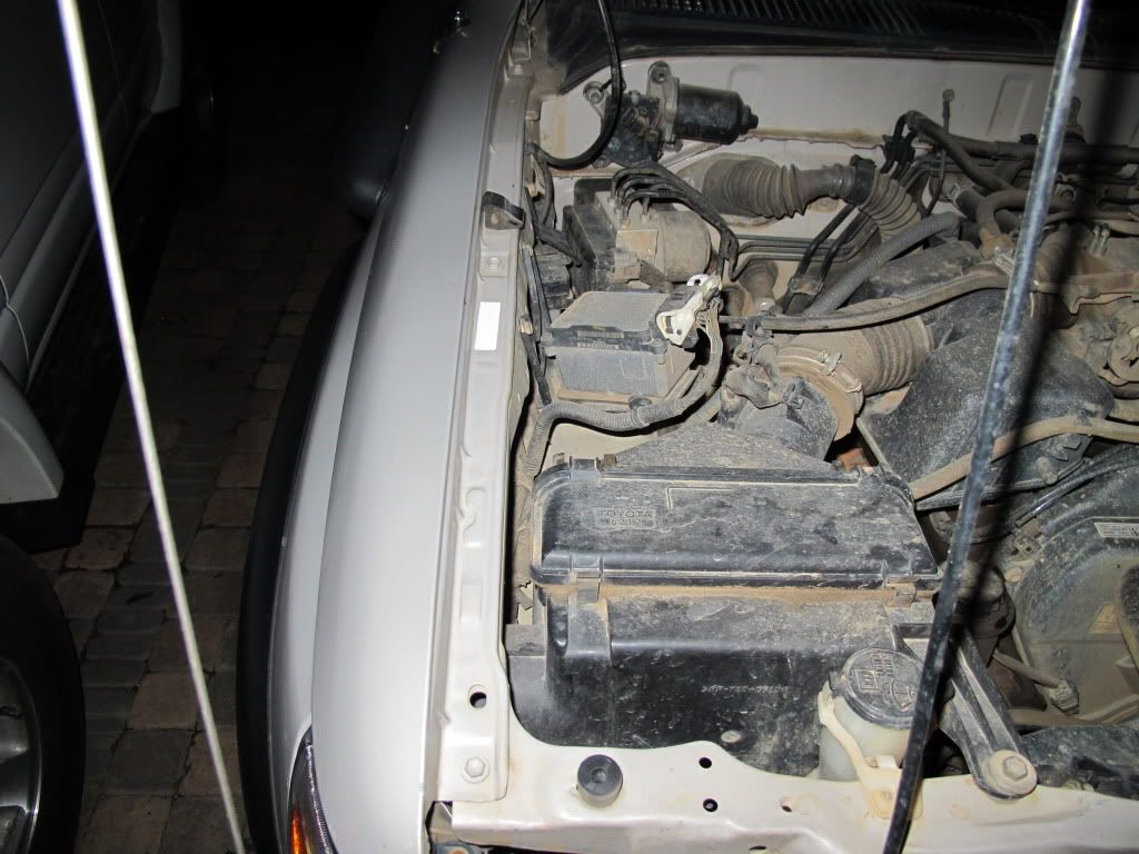

As you can see, (I'll travel backwards from the engine), the intake tube goes from the engine, through a small intake muffler (you may opt to use an airraid tube instead for better airflow), to the factory airbox and exits the engine bay into the front quarter panel. In stock configuration it ends there after a short tube. In Tacomas, this tube extends much further back... to the place where the snorkel is to be mounted, near the rear of the quarter panel.
Of course, my truck has a V6, but as long as the airbox draws from the same area, then the snorkel will work (which I'm sure it does). The only tricky part for you will be to find a stock airbox from a 4 banger.
Jacque at TRDPARTS4U can quote you one... or at least help you find part numbers.
