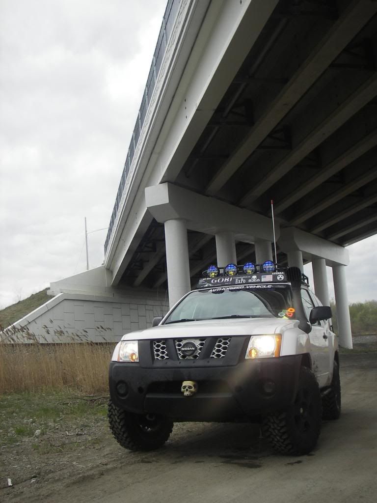

Question. I installed the Airflow snorkel on my Xterra a few months ago. So far so good, and no problems. In the directions, it says to never turn the intake so it's facing backwards. Causing negative pressure in the engine, maybe it's just for Nissans but I have seen a few pictures of trucks running snorkels with the head turned around backwards?
I was a little worried about rain water, but I drove through a really bad down pour on the highway for almost an hour with the snorkel facing forward, and arrived with a dry air filter.
So, just wondering why some are turned around, or if their even aware that it may cause issues with the engine in certain makes.

BTW, I like your little "dude" in your front bumper.

"BTW, I like your little "dude" in your front bumper. "
Thanks!! :)
