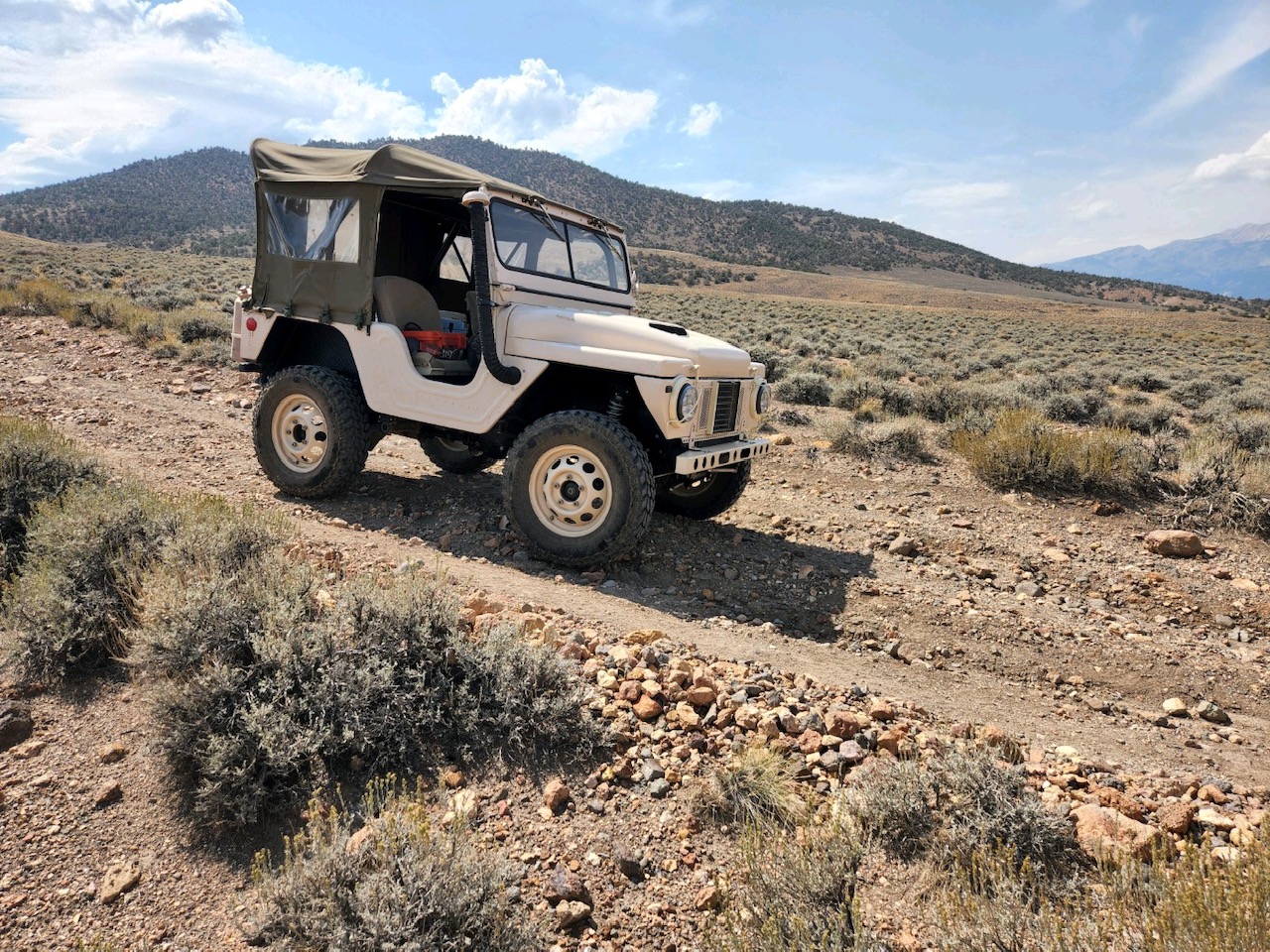

Ground-up, well-sorted build for desert trail exploring/camping and forest service roads. Driven with respect for the 1/4 ton independent suspension driveline, this has proven capable on the mining roads of Nevada. 2,500 miles since build was completed in 2016. California-title with current ‘23 tags. Cruises readily at 50-55 mph.
Drivetrain

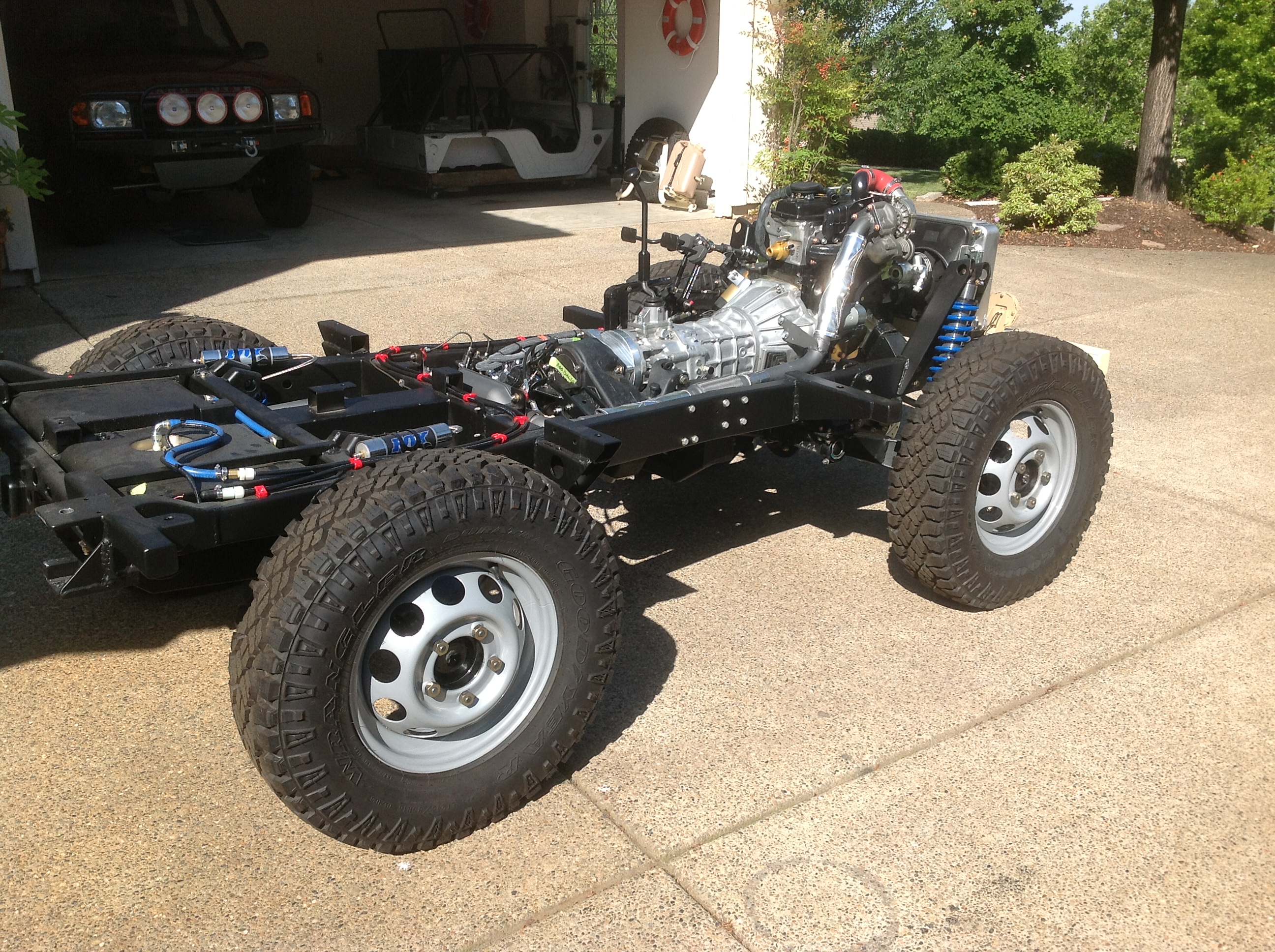

Built with a new VW 1.9L Turbo Diesel long block, new Bosch injection pump (modified by Giles Perf., Canada), stock VW K14 Turbo; and a new Jeep AX15 5-speed overdrive transmission with the 2” shorter Toyota R150 input shaft. Rebuilt Spicer Model 18 transfer case with 3.2:1 Tera-Low gearing. Utilizes Acme & Novak adapters. SPAL brushless variable-speed fan & custom aluminum double-pass radiator.
Toyota clutch assembly: 22RE-Turbo bell housing, pressure plate/disc & hydraulic clutch.

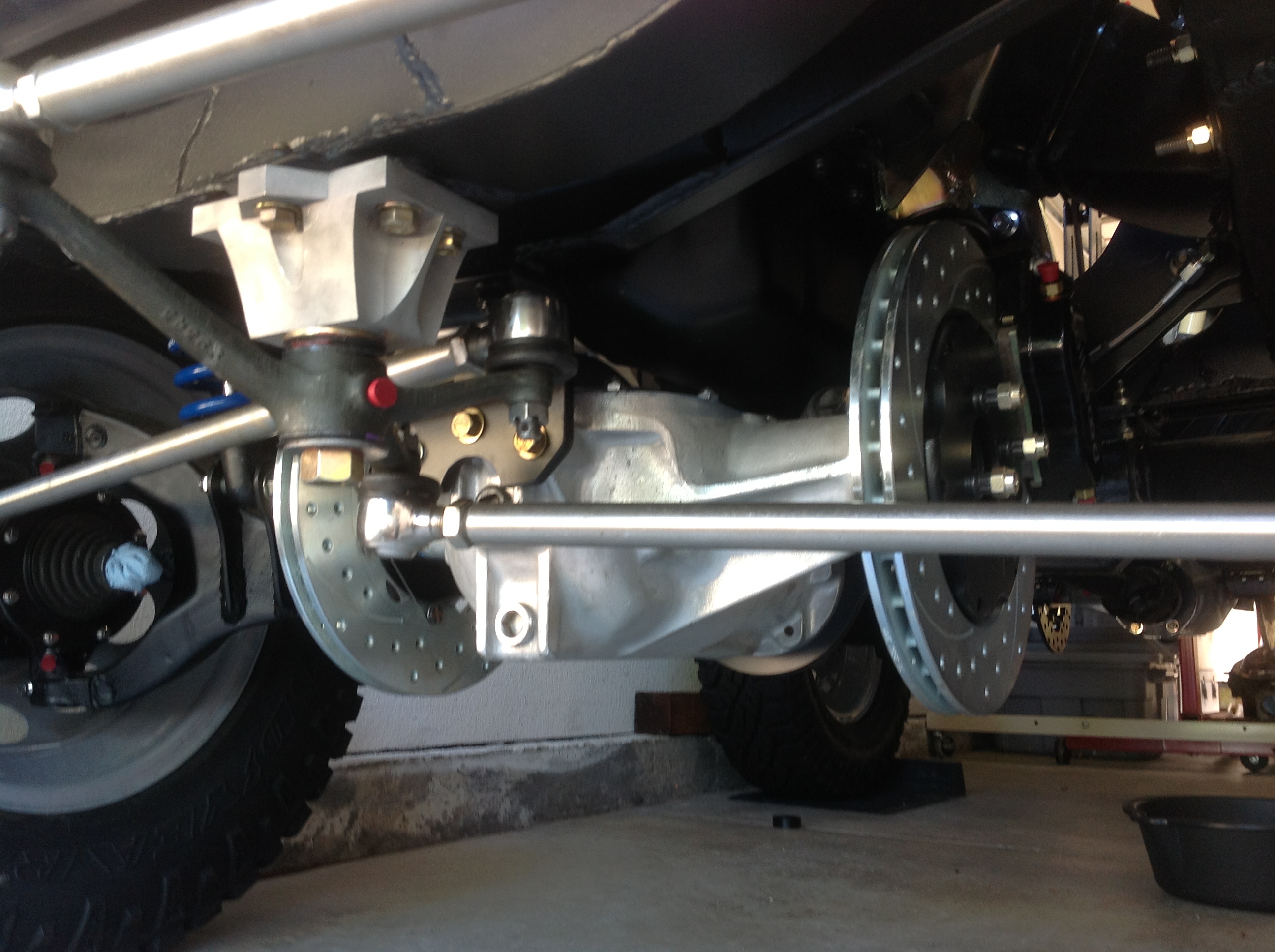

Front & rear differentials fully rebuilt with new: bearings/races, stub axles, yokes & Power-Lok clutch packs. Larger diameter Spicer rear-halfshaft assemblies.
Body & chassis

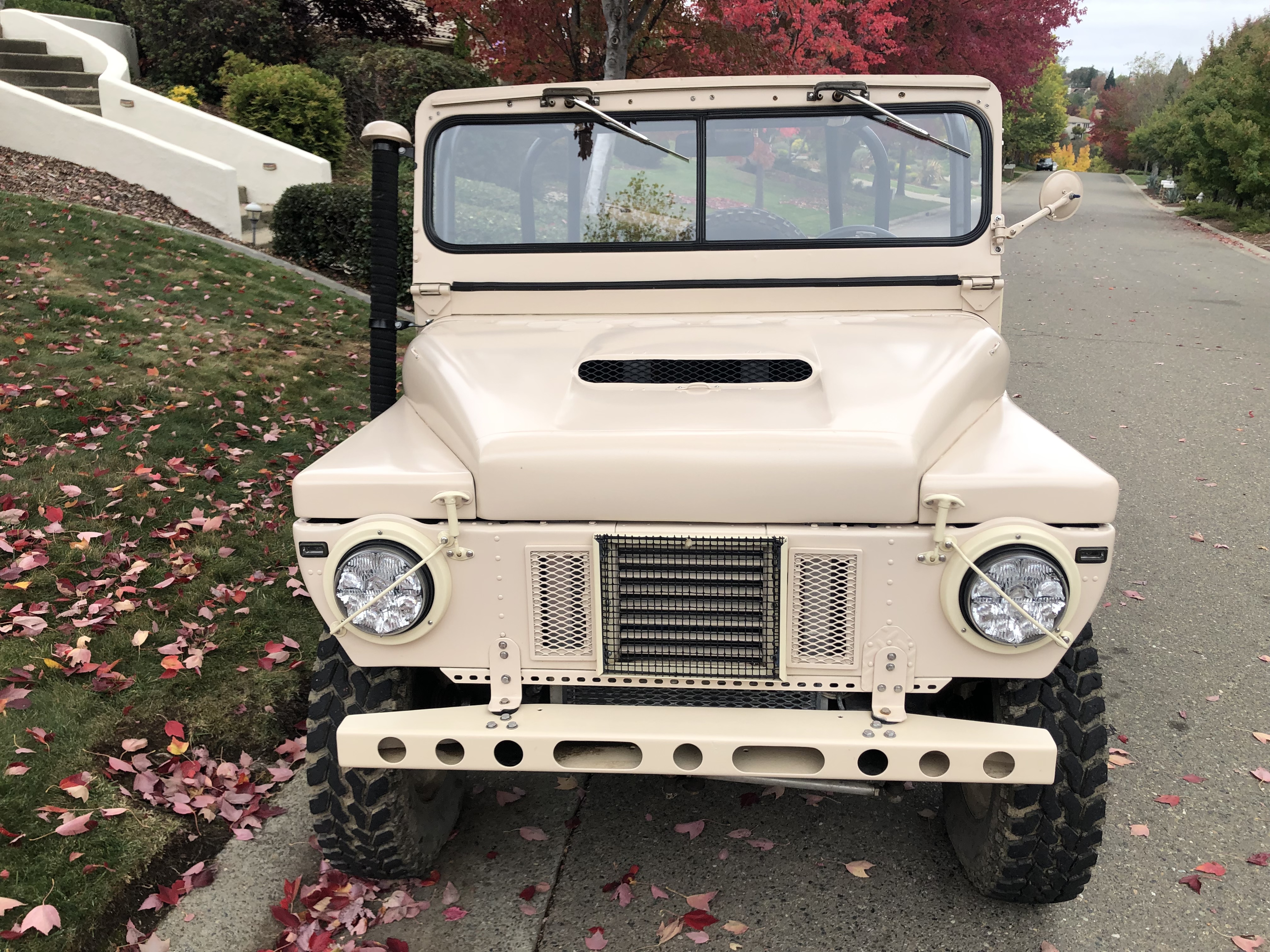

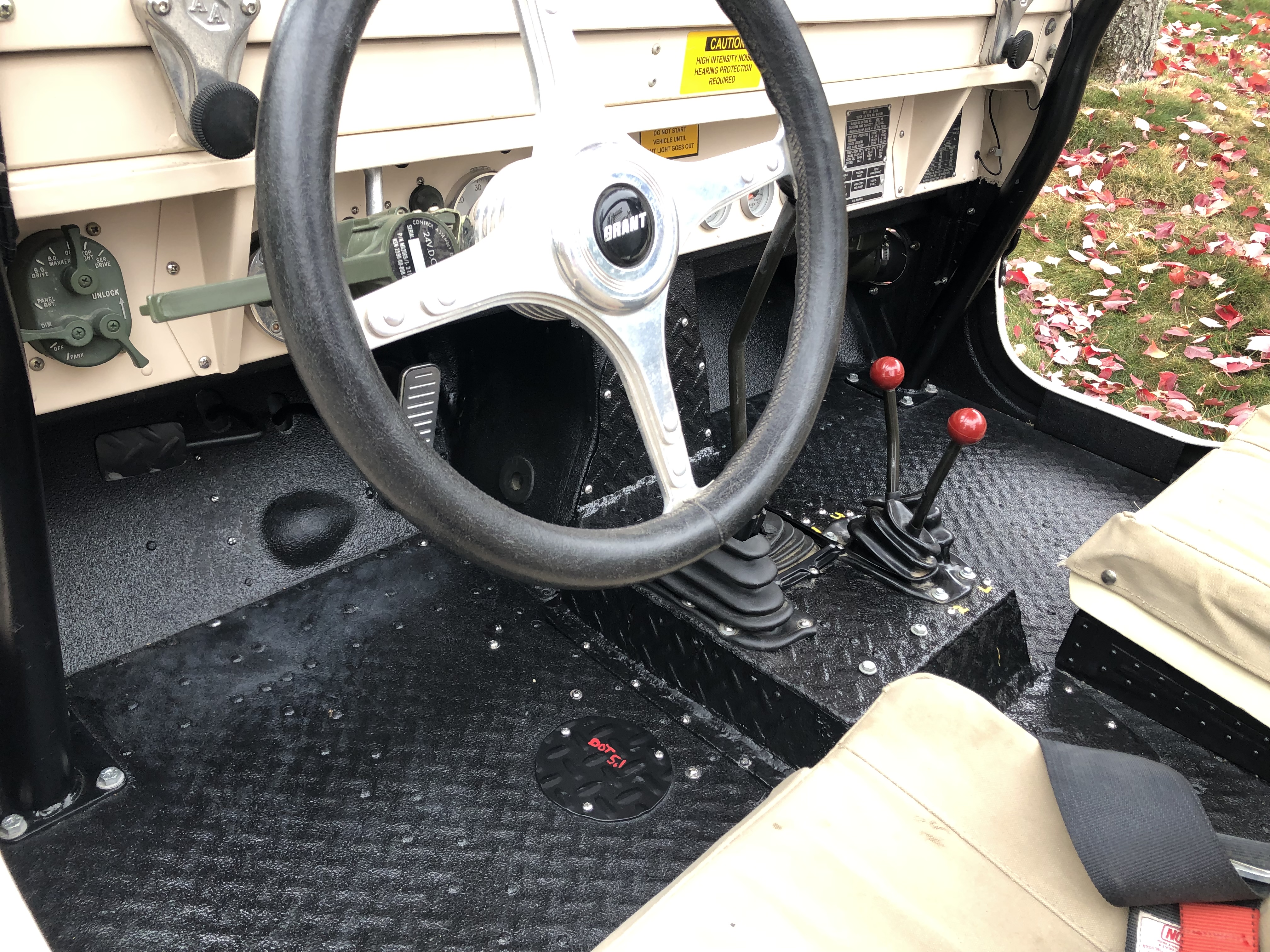

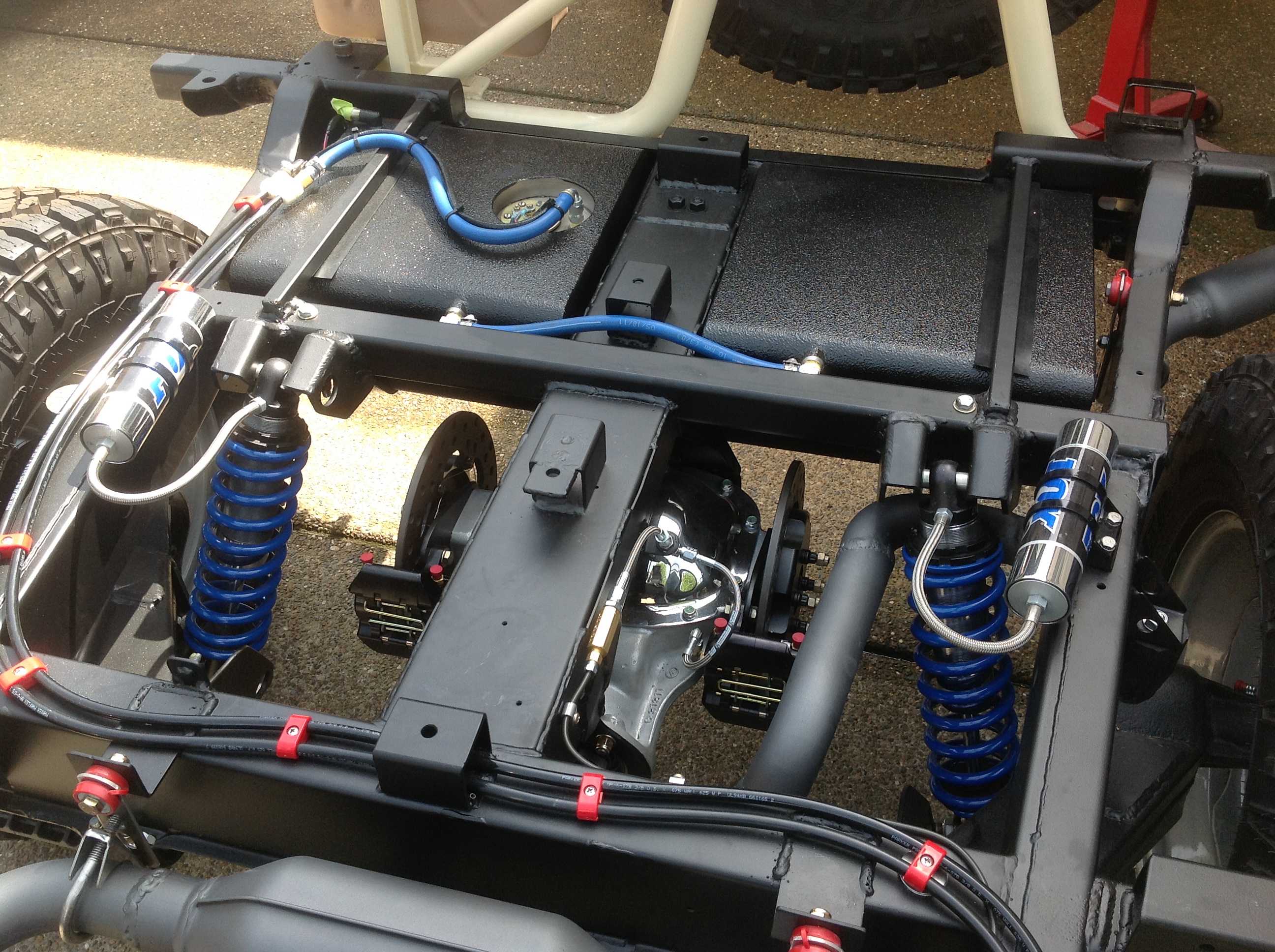

Leaf springs converted to coilover Fox units. 215x85-16 Firestone Destination MT tires. 2 spare rims & tires. Toyota 2WD truck power steering box, disc brake conversion with Wilwood rotors/calipers & GM hydroboost. Aluminum body, epoxy primer & urethane satin paint. Powder coated frame/suspension arms/roll cage & bracing/rims etc. Easy-to-clean SEM 2-part urethane bedliner inside & undersides. 12 volt system, dual AGM batteries w/marine combiner, Sealed fuse box, LED head & tail lights.
Reproduction Mite canvas winter top with side curtains & doors. Custom stainless fuel tank. Includes a plethora of spares. Well-equipped hauler trailer potentially available.
$25K. Located in El Dorado Hills, California (Sacramento region)
