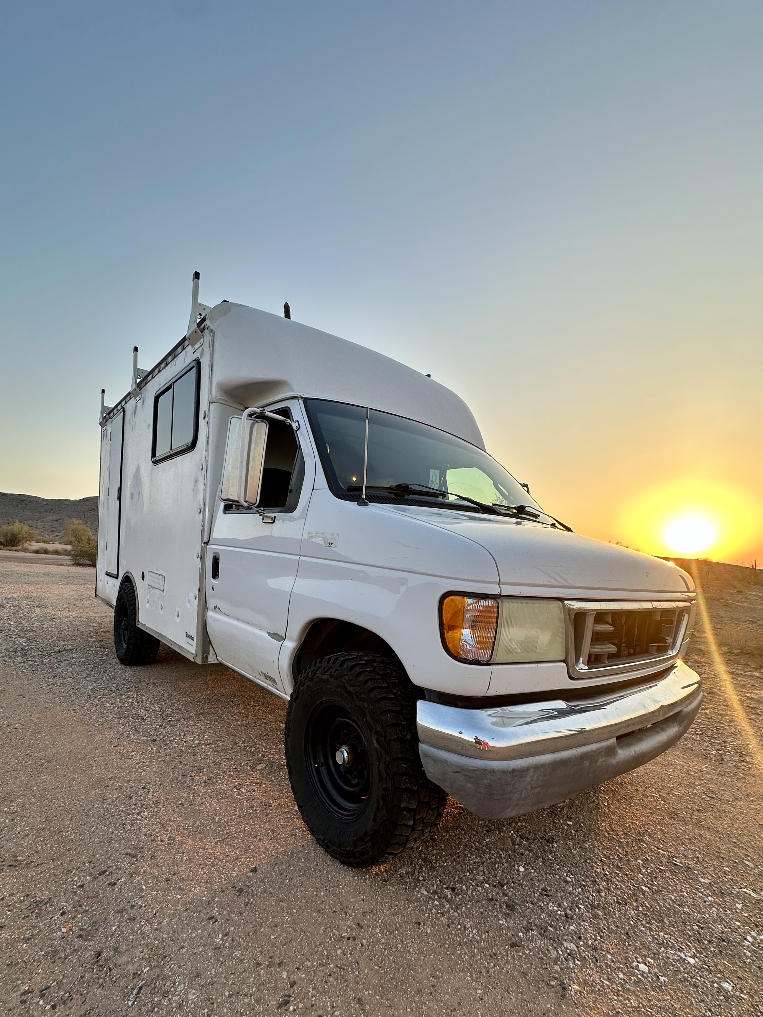

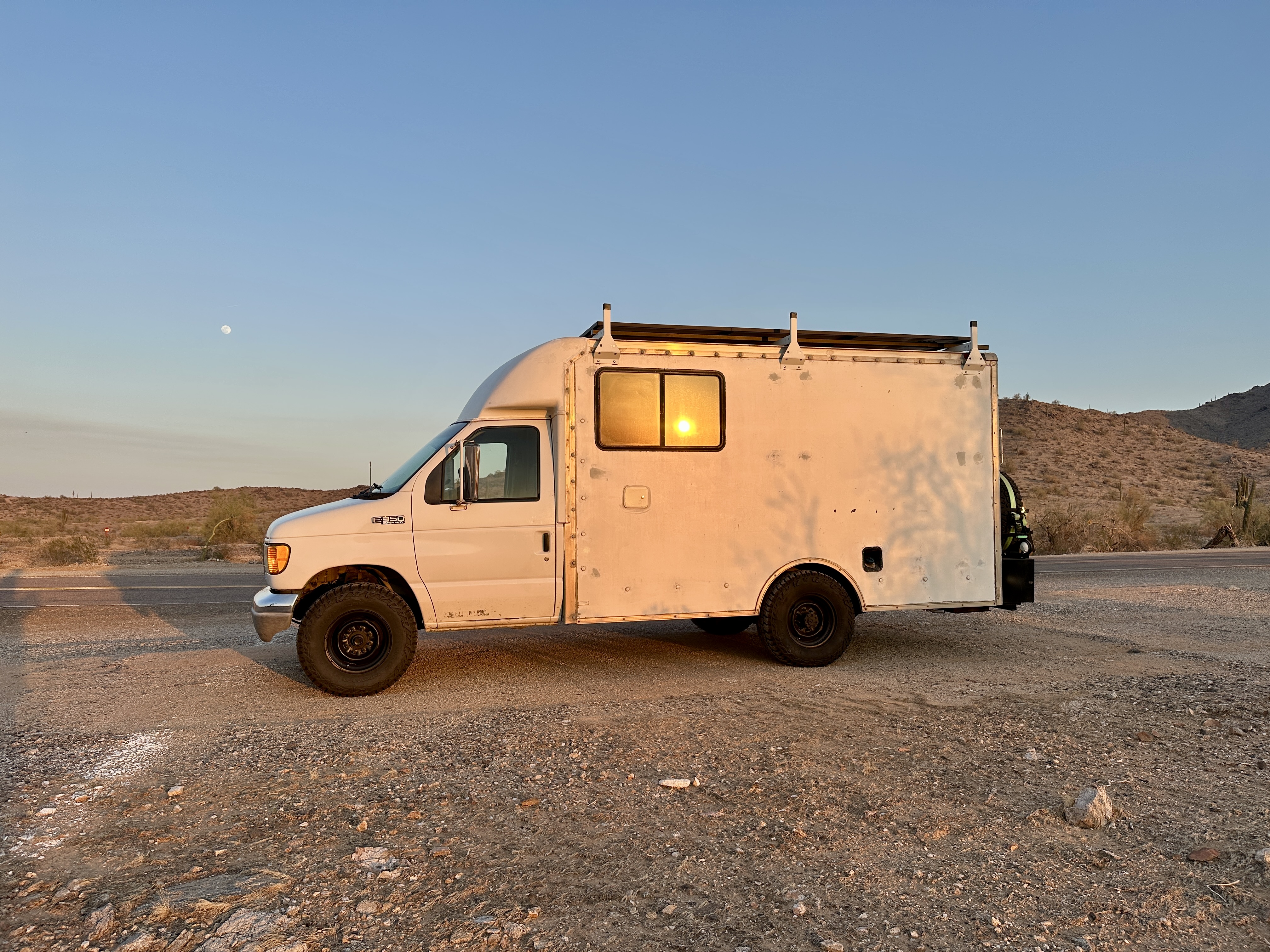

Meet Paul. Fully Built and Adventure Ready! Skip the build process with this decked out rig and hit the road today! Lots of love and hard work put into this build. Would love to see the next owner get many miles of smiles as did we.
2003 E-350 Super Duty (~144k miles)
7.3l Powerstroke Diesel / Automatic Transmission
12’x6’x6’ box
2.5" of closed cell spray foam insulation (~R17)
1200W of solar
600aH lithium batteries
3000W Victron inverter (+ All Victron electrical components)
75gal fresh water tank
Pioneer Mini split (9k BTU 21.5 Seer)
Iceco 65L fridge/freezer
Lavanar 2kW Pro Max Alpine Diesel Heater (adjusts air/fuel up to 12k feet) tapped into main fuel tank
Bosch 2.5-Gallon Electric Mini-Tank Water Heater Tronic 3000
Starlink
Butcher Block Kitchen and dinette table
Deep Sink, filtered water, faucet doubles as outdoor shower
Queen Bed
Dinette w/ strong Cass Hudson Steel Table swivel
Dinette converts to twin/full bed
Tons of storage under bed, dinette booth, and grandma's attic
Rear toolbox
Full size spare tire
Titled/Registered as an RV in AZ. We had it insured through Statefarm
Testimony:
- My wife and I have lived comfortably in this full-time for just over a year. It’s a beast.
- We have boondocked for a month straight, could go longer if you're a scrappy fella.
- Relax on the hottest of days thanks to the AC
- Get cozy on the coldest of days. We lived this entire past winter in Mammoth Lakes, lows of 0F and 280 total inches of snow this season.
- Full electric build, no propane.
- Can comfortably run AC around the clock. When running AC in the sun, solar input is greater than draw of AC.
- We have never ran out of battery. Can’t even seem to strain the system.
Feel free to ask any questions about the rig. We built it ourselves and can likely answer any of your questions.

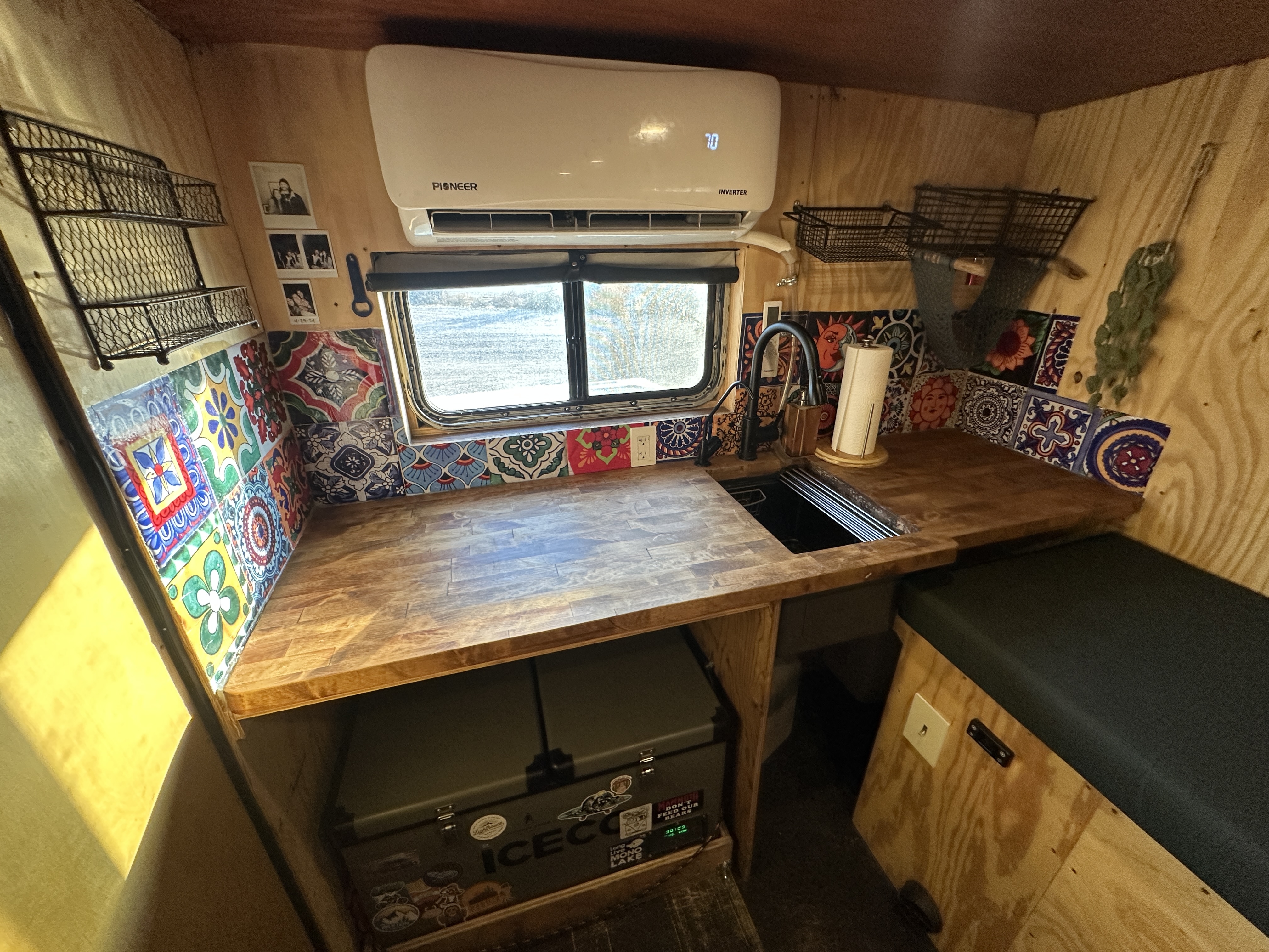

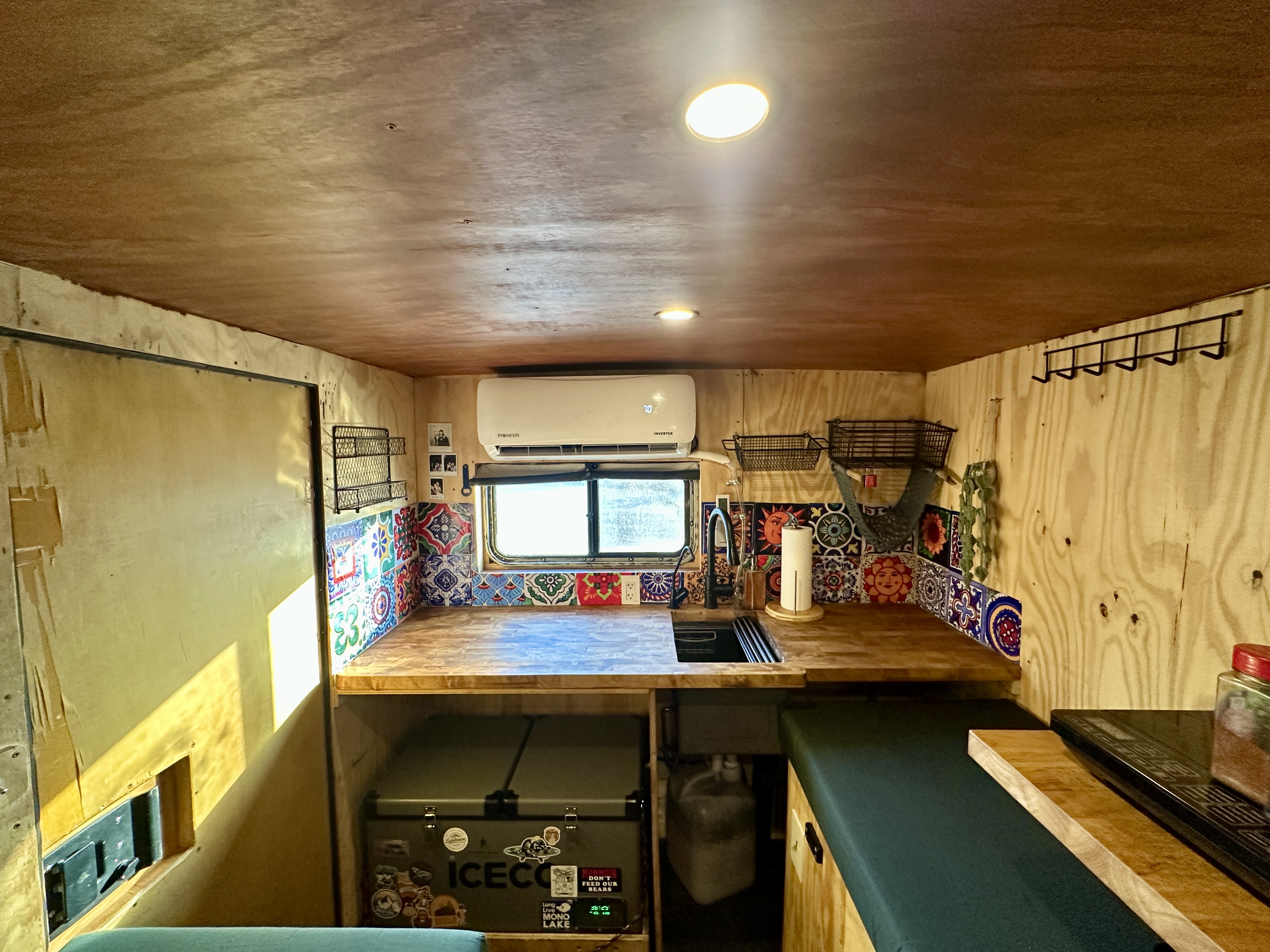

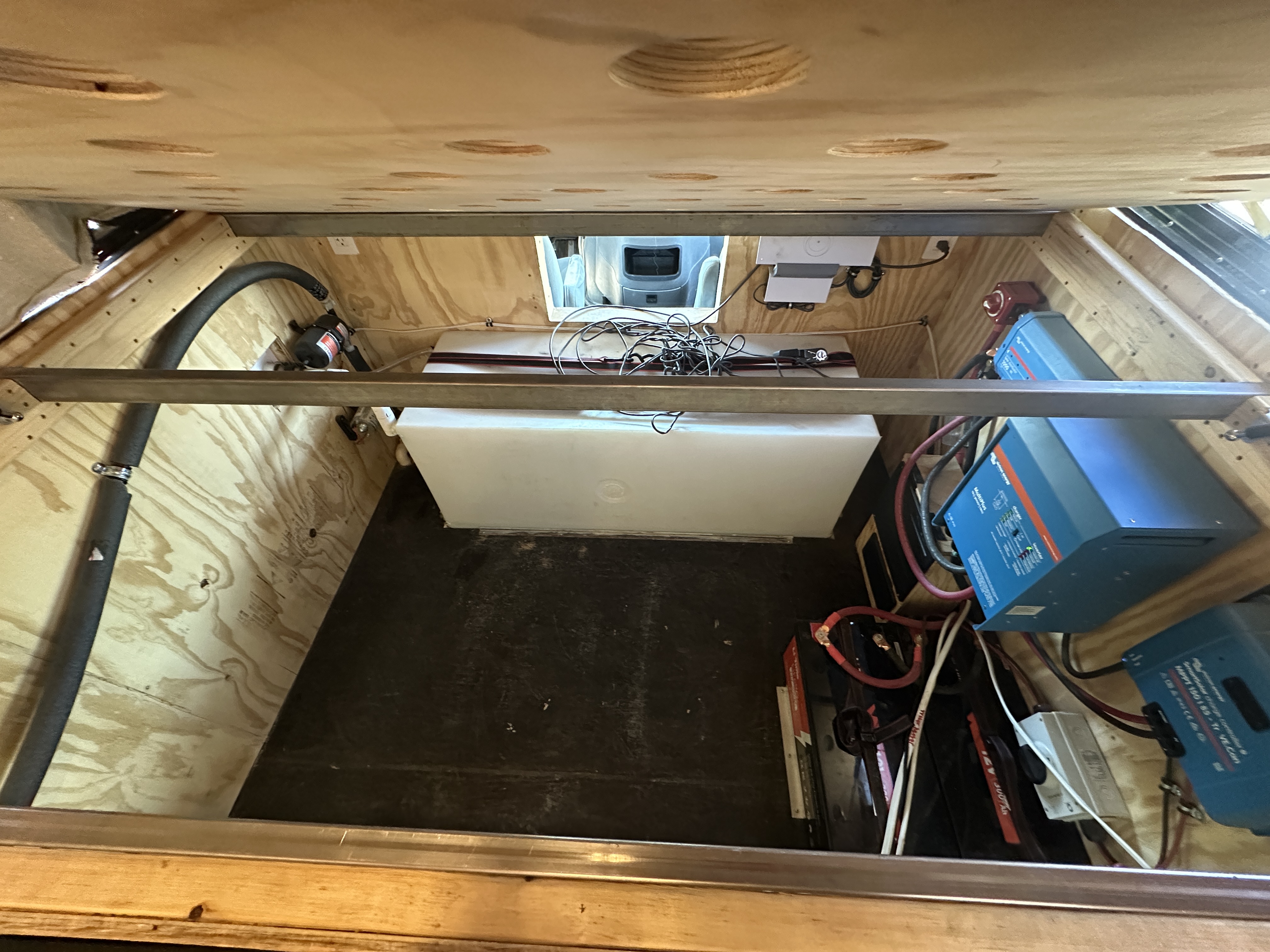

Hey, thanks man! Good questions.
1) Right now, the bed lifts via gas struts. We were able to store a lot down there: 3x27 gal storage bins, camp furniture, bouldering crash pad plus 75gal water tank and power systems, with space to spare. If you really wanted, a (large) hatch could be installed on the driver side to access the space. This might be the best option for you long term. The passenger side is where all the electrical lives and routes to, so driver side would be ideal for a hatch. You might be able to get bikes in and out as it is now through the living space, but I'd suggest a hatch with slide out platform.
2) We have a 2.5gal Bosch electric water heater and the kitchen sink head is long enough to snake it's way out the back window for an outdoor shower. There is enough space on the interior if you wanted to rig up a curtain and a catch pan for more privacy. We have a Trobolo compost toilet onboard.
3) We have Mickey Thompson Baja Boss A/T LT265/75R16 tires. They work so well in all conditions. We lived up in Mammoth Lakes this past winter and they performed very well in feet of snow. Suspension is stock, but suprisingly good. I’d say as good/slightly better clearnace than your average subaru. We only got truly shut down in technical rock terrain we didn’t want to drag our home through and found it best to turn around.
4) We would see 12-14mpg when fully loaded with mixed hwy/town/offroad driving. Pretty good all things considered. My buddy’s v10 triton shuttle bus gets 3-5mpg I think ☠️
Let me know if you have any other questions 👍
