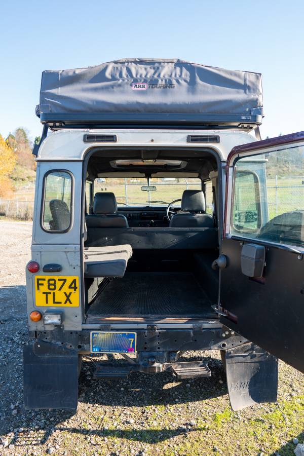

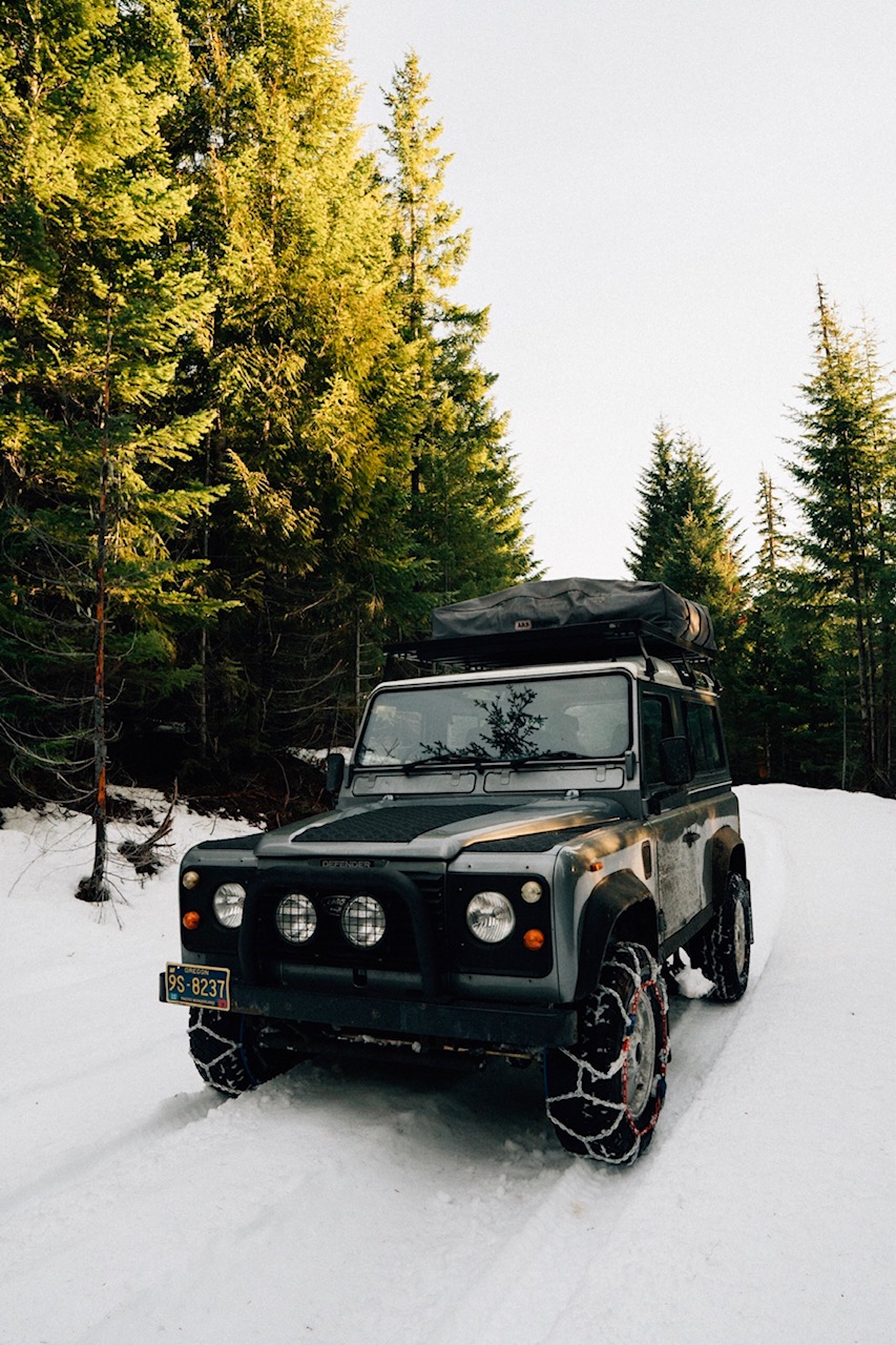

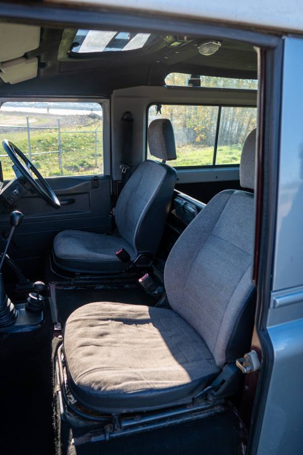

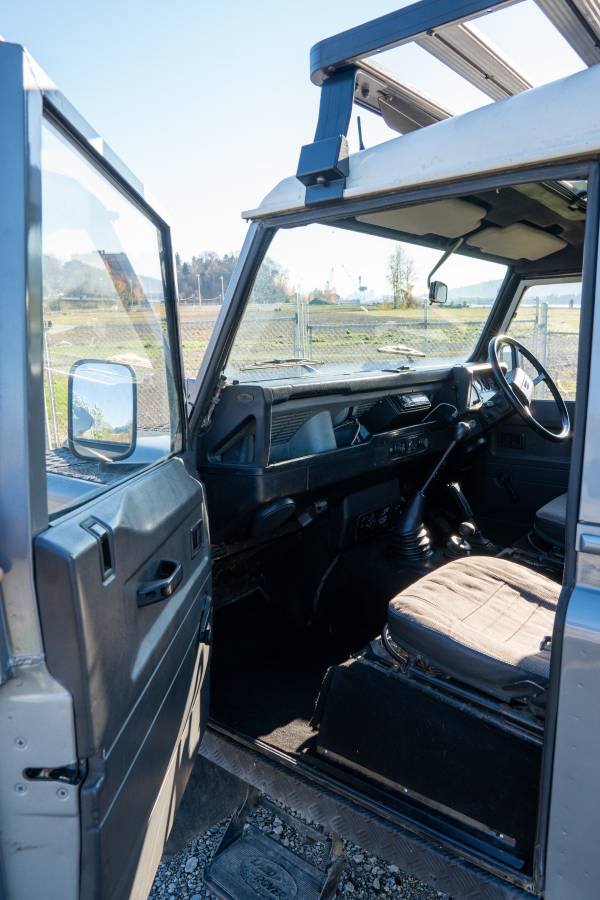

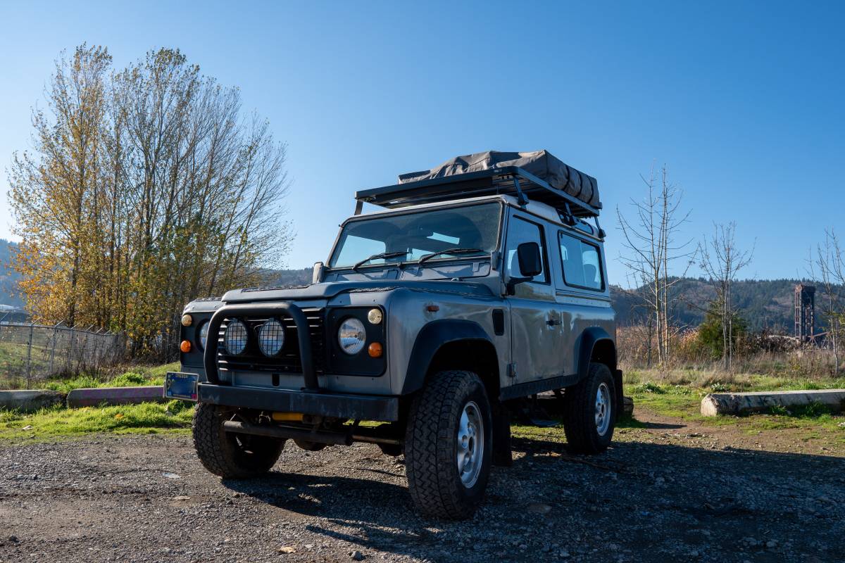

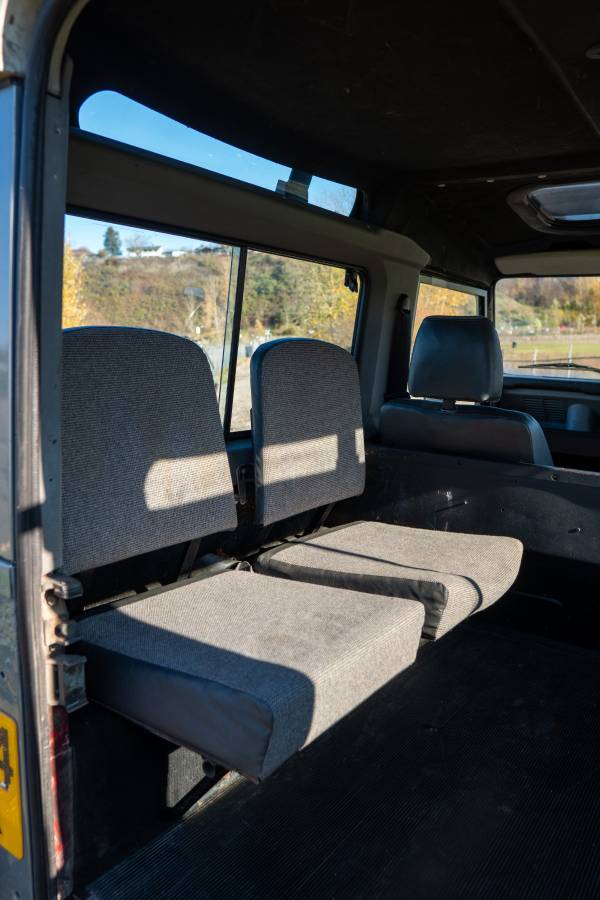

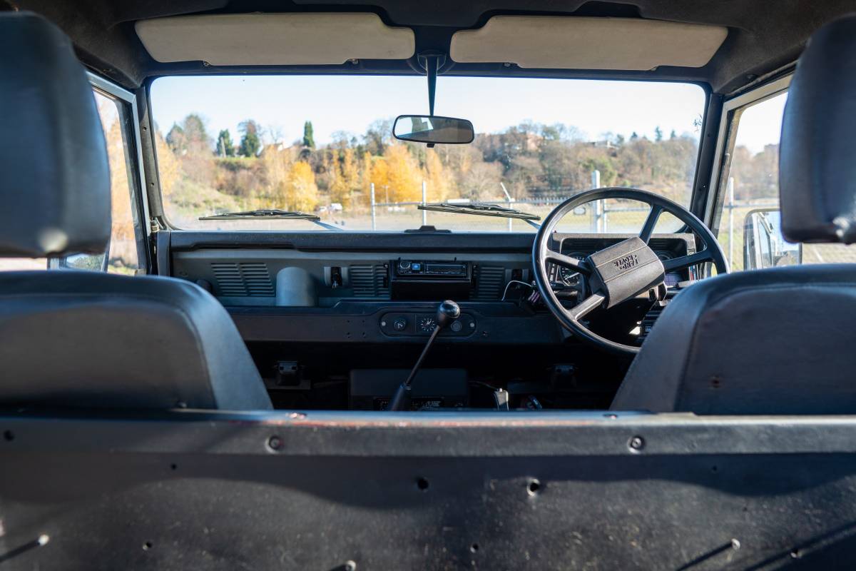

A little bump, with some more photos

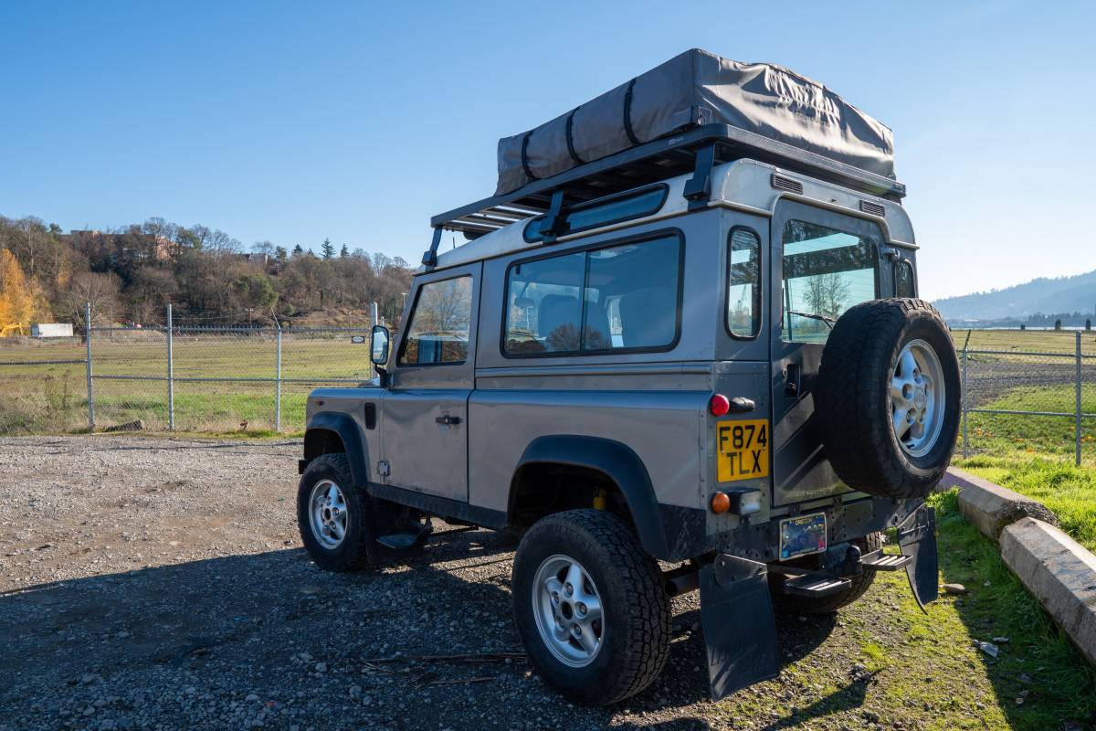

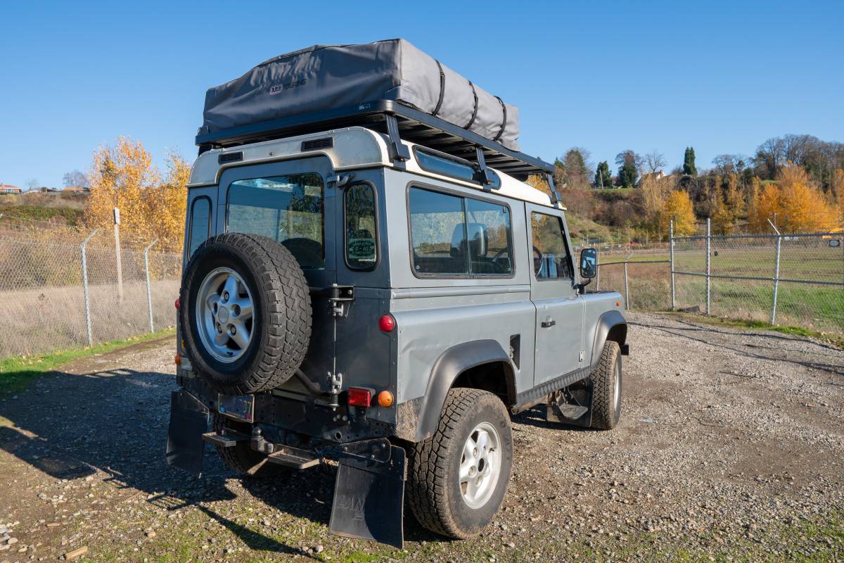

Plans for the next rig are moving quicker than anticipated, so dropped the price to hopefully move things along.
obselesc
Just took the rig on a ~600 mile weekend trip and it did great. Feel free to make me an offer, I am ready to get this sold.
