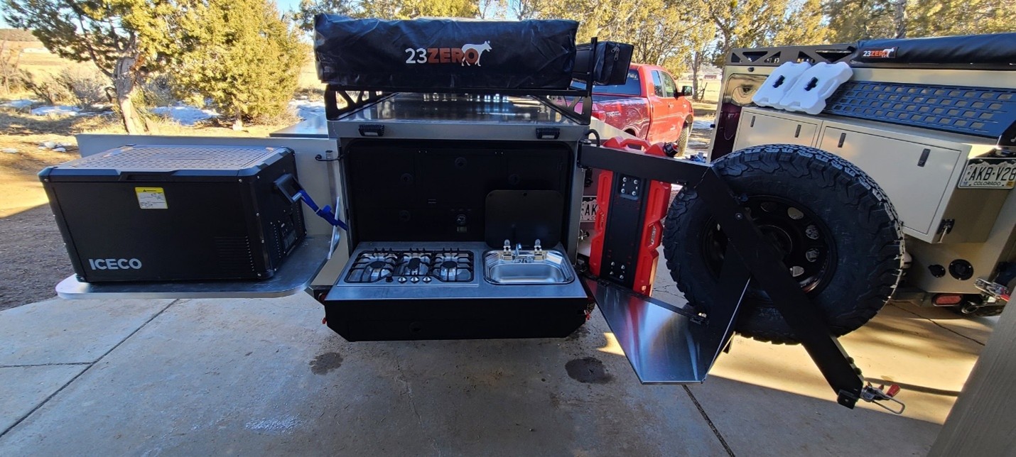

Sasquatch Expedition Campers is a startup camp trailer manufacturer set to launch this Spring. We are based out of Silverton, CO and have been designing and testing these campers for over a year now.
Up for sale is a field test unit for a line of campers we will launch this Spring. This camper has about 300 miles on it and has been camped in. This is not a back yard build; this trailer was modeled in Solid works through a collaboration between two Engineers experienced in trailer and race car fabrication, product development and manufacturing.
We are offering this for sale at a $10,000 discount at $19,500 OBO, without the 23Zero accessories. If you're interested, these can be purchased at dealer cost with the trailer.
CLICK HERE FOR MORE PHOTOS
Here are the build details:
  • Independent trailing arm suspension featuring Fox coil overs - Specifically engineered for our expedition trailers
  • Aluminum frame with black powder coat - lightweight and will not rust
  • Renogy 1000W inverter charger
  • Renogy 20A DC-DC Battery Charger, wired for low current charging while towing using 7-pin charger
  • BFGoodrich 285/70/R17 All Terrain T/As mounted on Method wheels with full size spare
  • Electric brakes with breakaway
  • Ark articulating 2" coupler
  • Ark 30” Drop Down Corner Steadies integrated into bumper

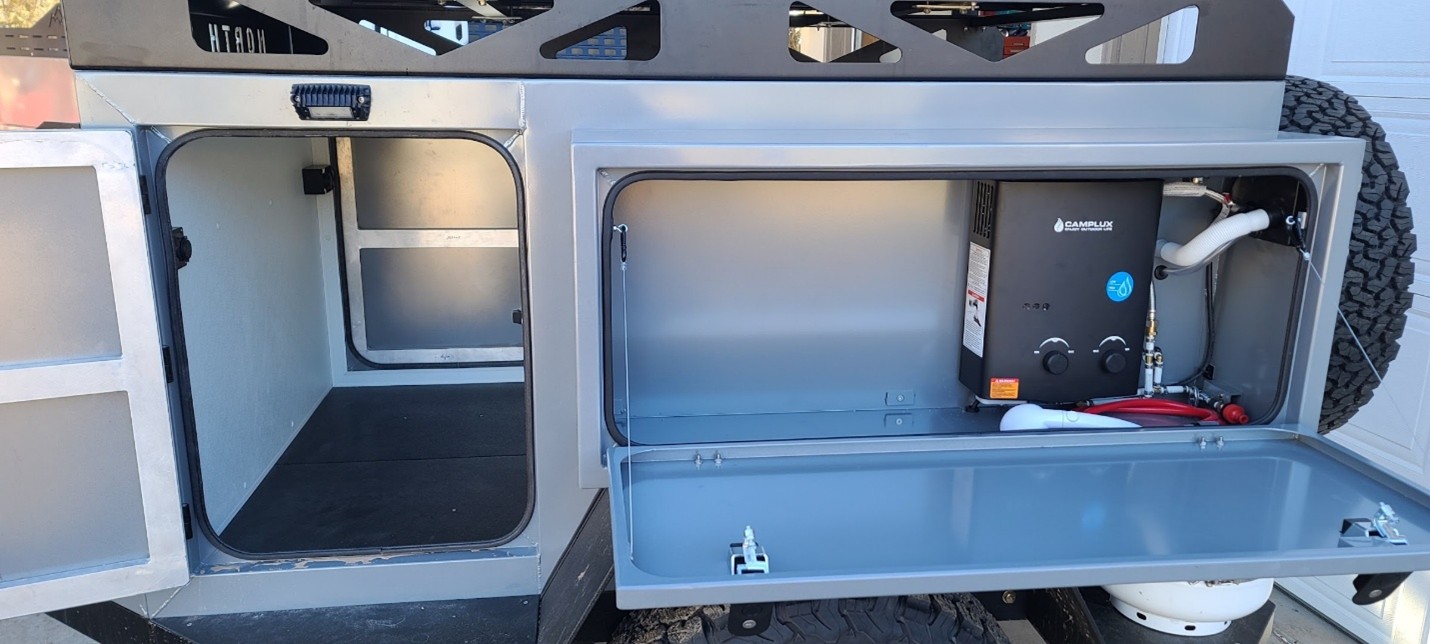

  • Two CNC cut custom fabricated side boxes with compression latches and premium weatherstrip seals.
  • Camplux on-demand hot water tank with shower hookup.
  • Interior Cargo Area
  • Interior cargo lighting, USB and 12v power sources
  • Bed lined 1/8” aluminum floor installed in cargo area
  • Two 11 lb propane tanks
  • 30-gal water tank with four baffles installed to prevent water from shifting weight around when off road

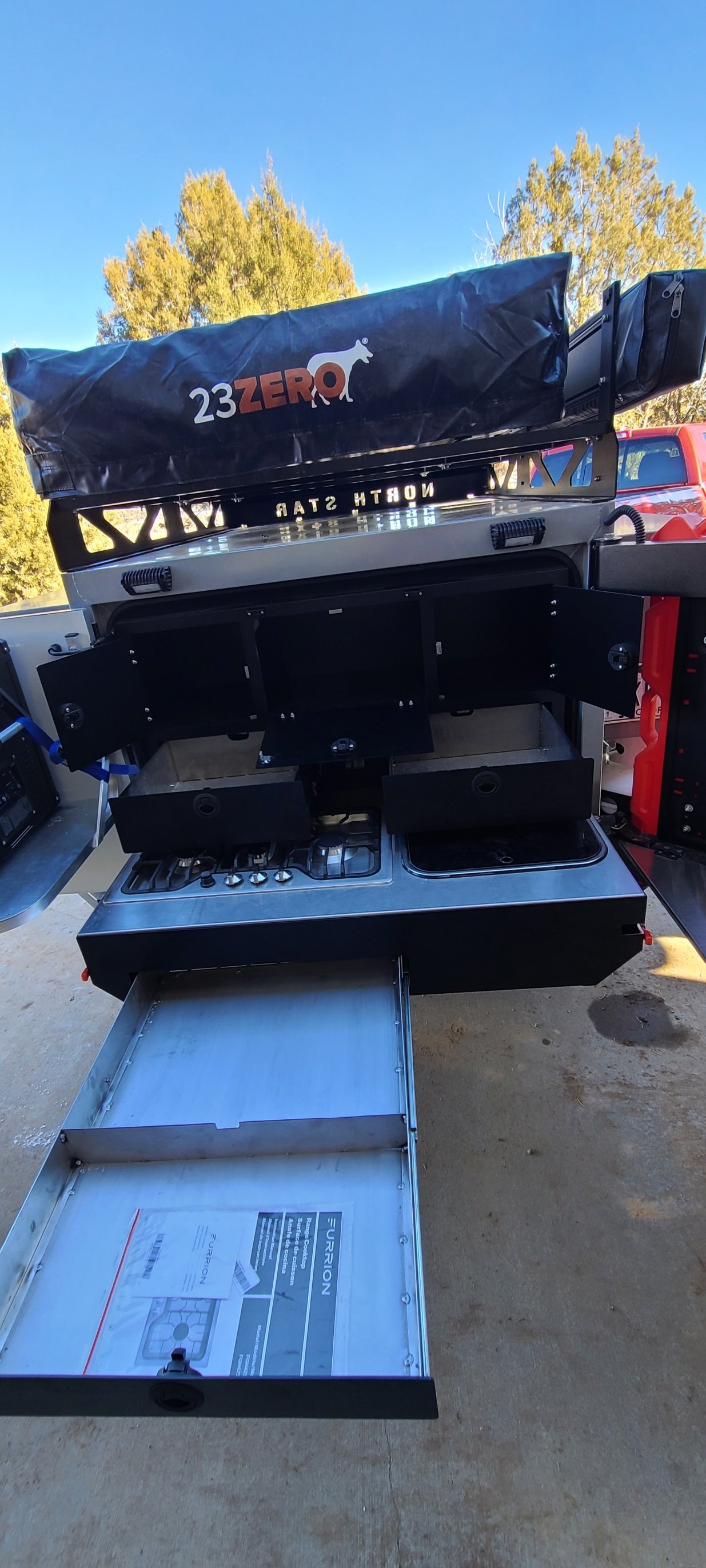

  • Furrion three burner cooktop
  • Fold down sink with glass lid
  • Stainless Steel Countertop
  • Laser cut aluminum kitchen cabinet system
  • 12v and USB power supply in the rear of the passenger side box
  • Led lighting both inside and outside of the kitchen
  • Iceco VL60 Pro fridge with stand and 12v power supply that is integrated into the door
  • Fold down stainless-steel prep table built into the spare tire rack.
  • Spare tire rack has integrated button to control rear exterior lights
  • 2" rear receiver hitch integrated into spare tire rack for accessories such as bike racks
  • Floodlights integrated into rear bumper that turn on (low setting) when vehicle is in reverse, and can be turned on to the high setting using a button that is integrated into the spare tire rack to light up your campsite when needed.
  • Rear recovery points with shackles.
  • Laser cut roof rack with four 1"x2" aluminum cross members, powder coated black

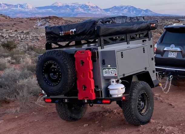

  • RotoPax 4-gal gas tank mounted to spare tire rack
  • 12' Length, 75" width, ~1100lb dry weight

What is the height on this with a RTT attached? and is the awning height adjustable?
The height with a 23Zero RTT is 83"
The awning brackets are not height adjustable; they were designed to hold the RTT window awning poles while the 270 awning was fully open.
