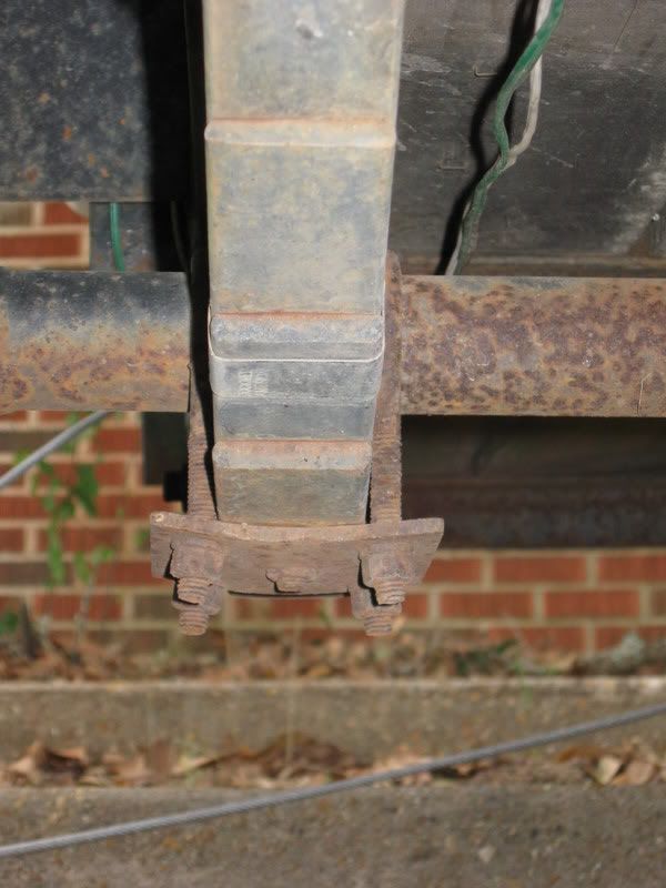

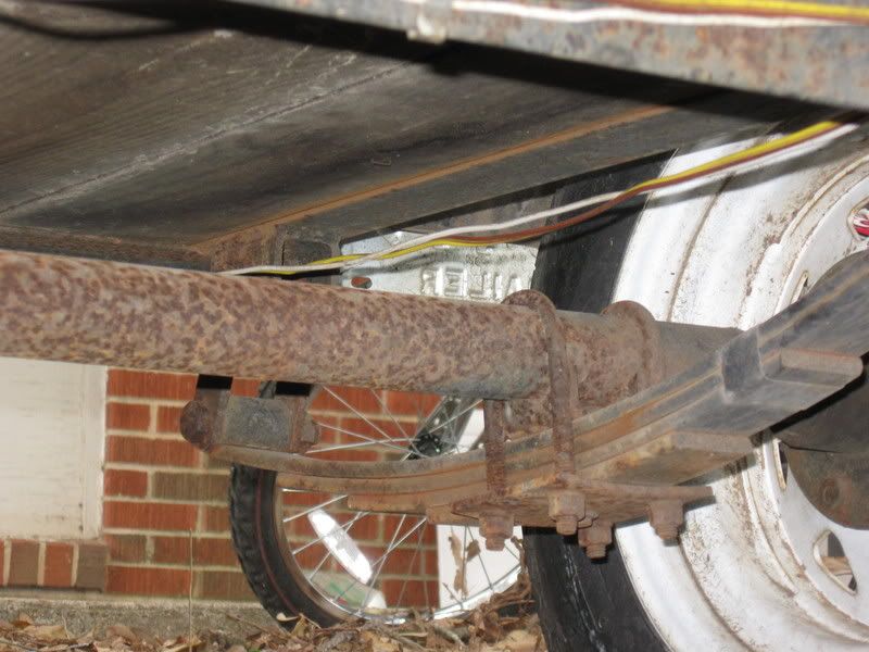

Ok, I have a well built 4x8 utility trailer which i use for transporting my motorcycles. It is actually a custom built trailer, made to pull behind a guy's crown victoria to haul custom cabinets. That being said, it is very low. When attatched to my vehicle, even with a drop hitch, it still has an odd angle to it. I'm hoping swapping the axle to under the springs will raise the trailer up and allow me to fit larger wheel's tires (second question).
So, can the trailer gurus help me out by looking at these photos to tell me what im working with/what i need to do?
What does it look like I ned to do?

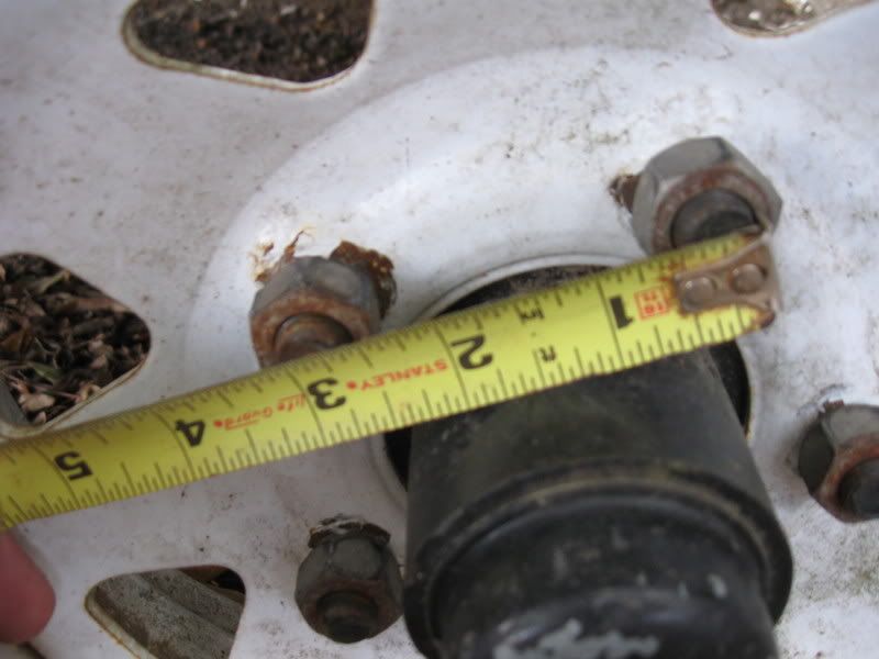

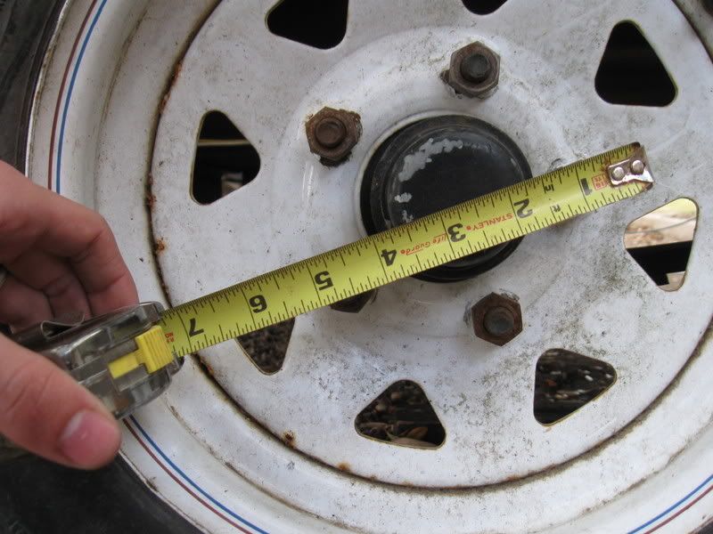

What I'd like to do is put 15" wheels on it, but not sure if the hubs are the right size.... how do I measure???

You can work out your bolt pattern here http://www.tirerack.com/wheels/tech/techpage.jsp?techid=92
I smallest common trailer 5 bolt pattern is 5 on 4.5

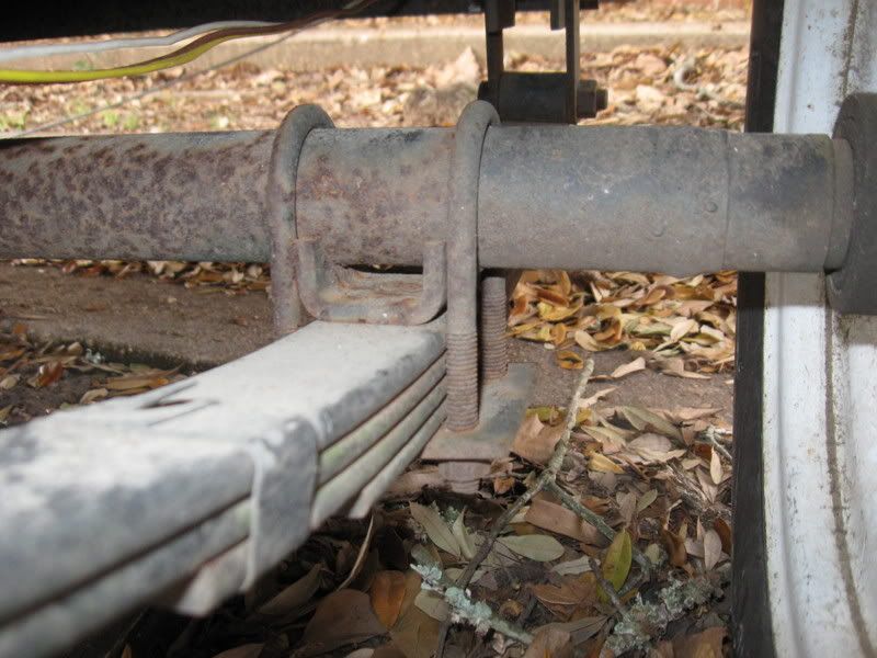

Start out by looking at the axle. Is it straight or does it have an upward arch to it?
If it's straight it can be rotated so the spring purchases are on the top of the axle instead of underneath. If it's arched you will need to have the purchases welded onto the top.
The spring should have a locating studs top and bottom that will correspond with a hole on the purchase and a hole in the plate on the U bolts. (or some combination of stud and hole)
I'd recommend replacing the U bolts and nuts.
A spring over should be simple, if the rust is just surface.
Replacement axles are inexpensive and in the long run may be a better bet for you. You can specify spring over, bolt pattern, weight capacity, and have all new bearings.

If it was me I'd get some from a trailer supply store.
The bolt stretch after they are torqued down, so don't forget to go back and re tighten them.

I did that conversion to my friends 4x6 version of that trailer. Looks like a TSC or lowes special. His was so light I flipped it over by hand and took one wheel off, then the u bolts and slid the axle out and stuck it back on the bottom of the springs. bolted everystuff back on and rooled it back to it's wheels. You may want to get another set of ubolts. I broke one and had to replace them. It sets nice now but the axle is still to narrow and the fenders are too small for larger tires. If it's like this one then you will need larger fenders and a wider axle to fit big tires on it. I orginally wanted to bolt factory YJ wheels to this one.
The axle was straight on this one so there were no issues. but if it's bent in the middle as Martyn is asking you will need to weld on new spring perches too.
