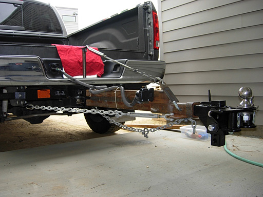

Hi FullFlex
I built my own extension/truss which fits my SuperHitch.
Here's a few photos.
Cheers,
-Mark
