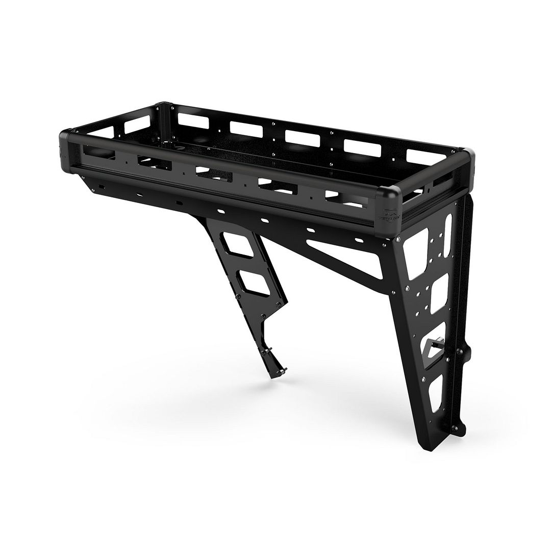

At SEMA Teraflex introduced the Alta Cargo Rack that attaches to the carrier, due in January. It might hold your Thule box & grill, but would likely prohibit climbing in from the back. Published weight spec on the rack is 75 pounds.

An update....though I really (in my heart) wanted the LOD Destroyer setup because it looks awesome, I went with the Teraflex HD and installed it a couple of weekends back. That thing is hella solid! I think I'll add the Alta rack in a couple of months.
