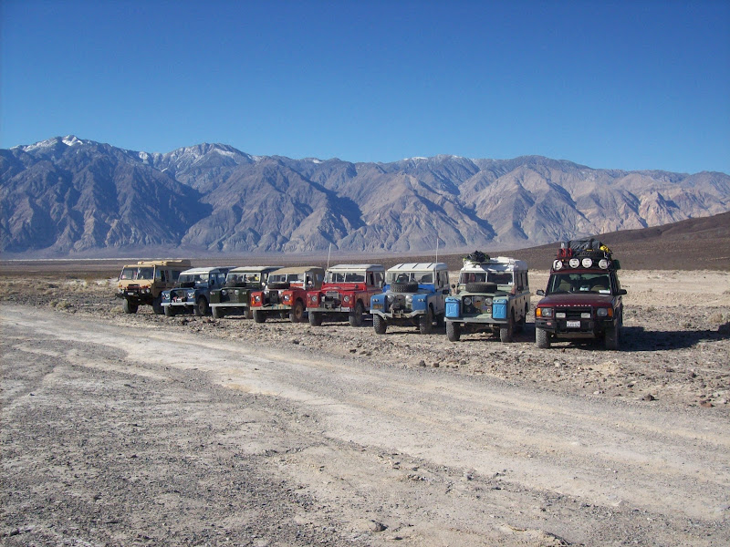

Cheese and crackers! You all are a tough crowd. I get home, and would just assume go to bed, but I go through the trouble of letting you all know how it went, and you complain about no pictures! :REExeSquatsHL1:
Well, here are a few:

Dear LR owner - we are happy she's up & running again. Thank you for posting the photos from Death Valley. You are back in the good graces of your fellow ExPo people. Looks like quite a group in Saline. Much obliged!
