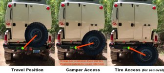

If you are concerned about getting it positioned in regards to the lug studs, a standard full size shovel under the tire makes it easy-breezy. Tons of leverage up/down and wiggle side to side. No problem with the 46" XZL (300+ lbs) on my 1017AF
If you have a pivot point type spare mount (below is planned for my Power Wagon with 40s), then smooth all the way, up and down.
