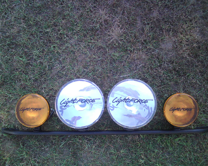

The first phase of installing a FRH to use my Warn XD9000i multi-mount setup on the Superu is complete.
A pair of 3/4" x 6" Grade 8 machine bolts secure a 2" step bumper FRH to the underside of the factory bumper.
Phase Two requires welding braces to the hitch and the underside of the body to keep from tearing the front end off on a hard pull! Hope to have it wrapped up and tested in a couple of weeks. :)
Those of you familiar with the Superu will notice the missing Lightforce photon cannons! Rest assured they will be back in a couple of days. I just got a lightbar for a Cherokee that will fit with some custom mounts and should be lighting up my little corner of the world in no time!
