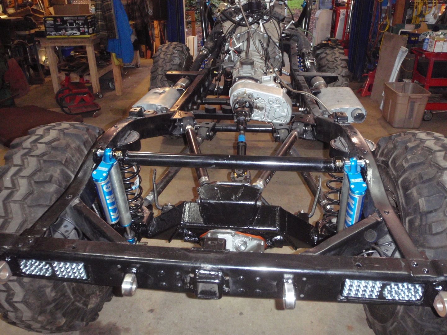

Neat chassis, what's it off?
I had a read... it sounds like pretty heavy duty stuff. How have you found its resistance to chipping / damage over time?
chosen
Crikey, that is one robust looking machine! Love the rims too!
Were the ROPS coated in the same material?
superbuickguy
yes, but it's there's another coating that has to go on if it's exposed to sunshine. The KBS coating is good for everything but UV, thus, they make another stuff you put over it that is impervious to the sun roll cage (I had to look up ROPS ;))
What I liked the most about it was its ability to spray through an paint gun - it uses the same size tip as more primers require
