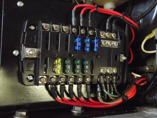

I just installed a 12 circuit blue sea aux fuse block into my truck. This is rated 100amp, so I have a 100 amp breaker in line with it. My original plan was to connect directly to the batter, however, I really like the idea of having it connected to switched power so I cannot leave my radios and crap on all night long.
My question, is there a switched power (acc power) terminal/wire/etc that I can tap into or connect to that will handle 100 amp (I am running 6 gage wire)? I was thinking I could use a 100 amp relay and tap into any acc power to supply the relay, but a relay that can handle 100 amp is very expensive.

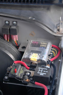

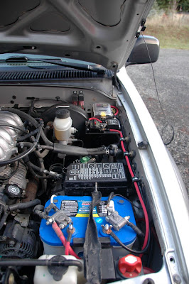

I have a 6 circuit Blue Sea block, and like you, I used 6GA wire so that if I wanted to, I'd be plenty safe running 100A through it. There is no circuit on your truck that can handle an additional 100A of power, so you'll need to make one. I wanted the fuse block to energize with the ignition switch, but also wanted to be able to energize just the aux. fuse block with the ignition switch off if I felt so inclined.
On my truck I have 6GA wire going from the battery to a 100A resettable circuit breaker, then a 100A relay, then to the aux fuse block. It looks like this:
To energize the relay, a DPDT on-off-on switch with a safety cover was used. There is one 'hot' lead coming from the switch to the relay, and two 'hot' leads going to the switch. The switch isolates the two 'hot' leads going into it, so that only one side is energized at a time. I did this so that I could have two ways to run the fuse block- ignition in 'on' position, and ignition in 'off' position.
In the 'on' position of the toggle switch (down), safety cover closed (normal operation), the hot lead energizing the relay comes from a fused switched ignition source. In the 'on' position of the toggle (up) with the safety up (aux. fuse block only operation, ignition off), the 'hot' lead to the switch comes straight from the fused side of the circuit breaker for the aux. fuse block. I could also deactivate the aux. fuse block altogether with the toggle switch in the center 'off' position if I like.
The relay was relatively inexpensive, as was the switch and cover, and I got them from Waytek.
100A Relay here,
DPDT Switch here,
Switch cover here.
Tip: when ordering from Waytek, try and think of everything you might possibly need now or in the near future, as they have a 'small order' charge of $5 per order.
Also, don't forget that if you're using 6GA wire for the (+) lead to your fuse block, you should also be using 6GA wire to ground your fuse block.
Good luck!
