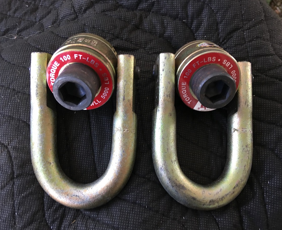

Hard to find without paying big bucks. These are new/old stock so might have dust or a shelf scratch but are UNUSED.
USA made. 25,000lbs+ breaking strength. Anodized and magnetically inspected. Tested before being shipped from factory. 100% rating even at 90 degrees. Full 360 rotation.
Waiting on payment for one, so one pair left! $425 new, SELLING FOR $150 pair. Pick up near LA or will ship for $10.

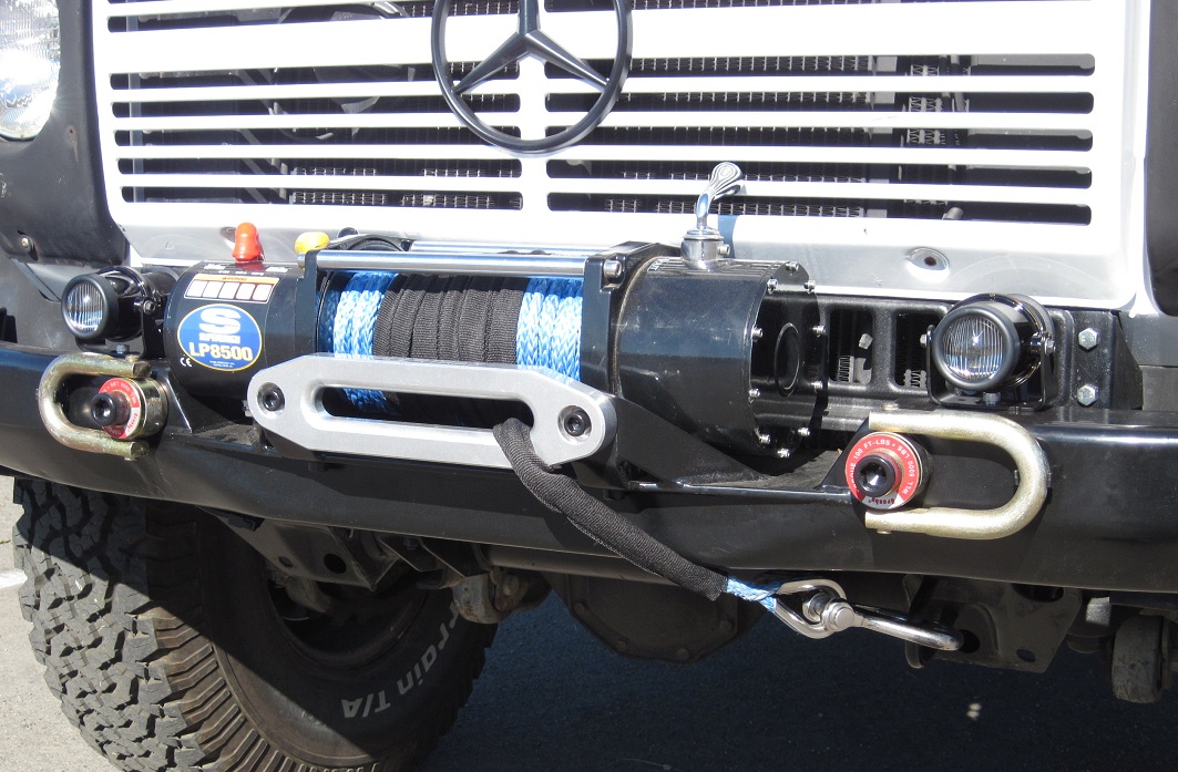

I’m interested but how do they mount?

Ok guys, quick lesson on this and industrial rigging gear in general: These are far stronger than the consumer-grade and usually un-tested recovery gear you are buying. They cost over $400 a pair for a reason. Actual lift ratings are far more stringent than any other rating, hence the pre-shipping testing and inspection process. The liability is far higher than for the 4x4 crowd.
These are rated at 5000lbs WLL, which means something very different than the so called "10,000lb+" gear 4x4 shops sell. They are rated a conservative 5:1 safety margin, and that is a real rating, not some assumed figure. Industrial grade rigging gear, used for things like when cranes lift heavy metal panels weighing 1000's of lbs. into the air 200 feet above workers heads, makes your little D-shackle made in China look like costume jewelry.
The next size up for these gets pretty big is more ideal for large rigs like Unimogs, etc.
Implying these are aluminum is pretty funny. 100% USA STEEL. Maybe I used the wrong word for the plating but you can see it in the pic. Someone suggested it was a form of galvanizing. I don't know. Point is, they are rust resistant.
Pass the bolt through a hole and put a big nut on the back. Easy as can be. The bumper pictured has a plate behind the facing of about 1/4 steel. I borrowed an extra large drill bit to make the hole and got a nut from the local hardware store and installed it in a minute.

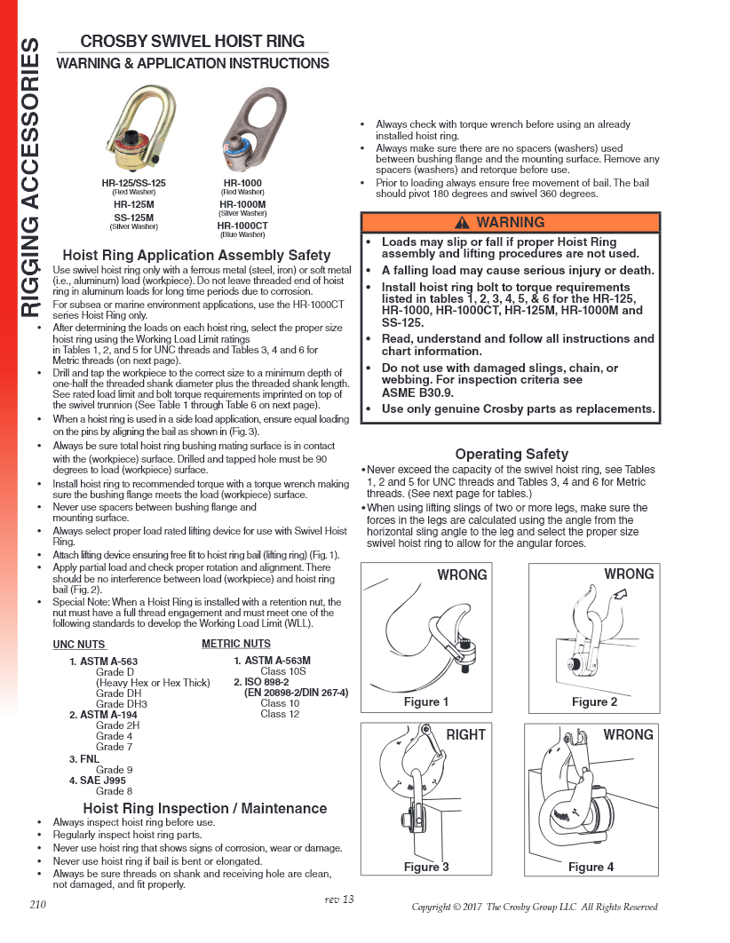

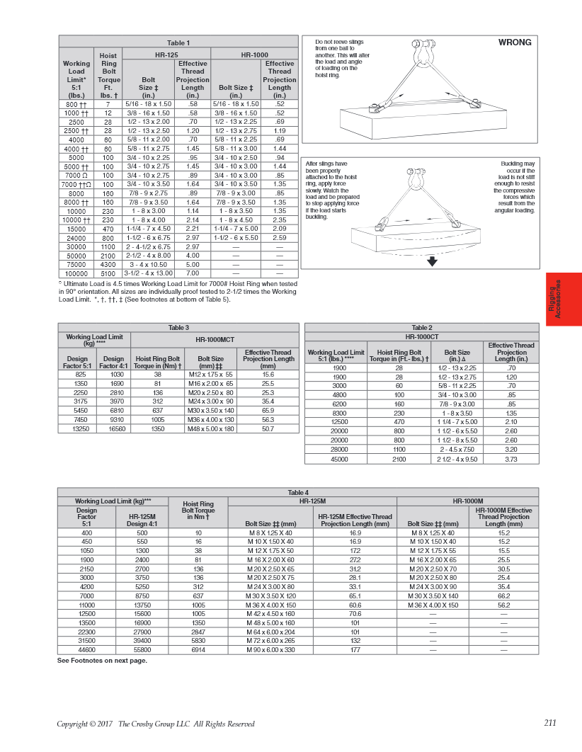

For reference... nut grade DOES matter....
Let me be clear: I have been wheeling, winching and recovering myself and others for 20 years BUT I am NOT a rigging expert or mechanical engineer, I'm just asking questions to try to not make any assumptions that might get someone hurt. I by no means mean to denigrate you or these items.
https://www.thecrosbygroup.com/cata...ions/?language=en-US&current_catalog_page=210
