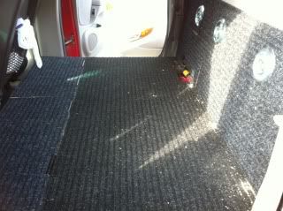

After removing the rear seat, I was amazed at the amount of room in the back. However, without a seat, it gets loud from the road noise. I wanted to use the existing bolts, but I didn't want to lose the floor board space so I had to come up with some interesting cuts. BTW, I am a complete novice at wood working with only a small deck off the front of my house on my resume.

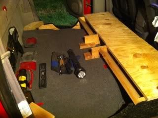

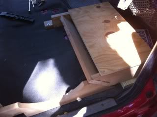

Here's a shot off the basic frame work for the platform. I don't have the main piece in place, but you can see the sides that I built off of the cupholder bolts. I tied them into the deck board that goes along the front and uses the existing front seat bolt on each side. The front has 3 cubby spots and the lids are set in place in this picture:

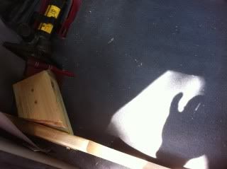

Each of the rear sides has brace that is bolted into one of the rear seat bolts. This is the passenger side:

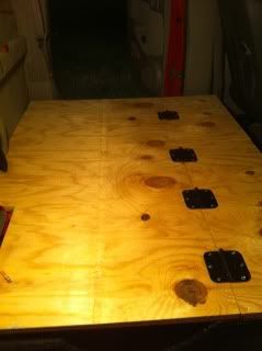

Here's how the platform looks laid out. It's not bolted in, but you can see the hinges and the basic fit. It will also be bolted in the back center with the existing seat bolt holes.

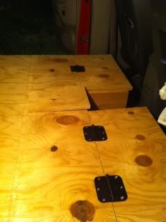

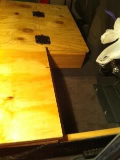

Passenger side with the door flipped back. I put the hinges on so I could flip the lids open 180 degrees if I had a large item to put on the floorboard:

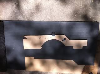

If you look at the space under the platform, I cut a semi circle so that I could stow stuff under there and be able to reach it. I thought about doing an access panel, but there wasn't that much space to access. Some recovery gear, first aid, etc..can go there and be easily reached. This is a picture of the shape of the side panel for one of the sides. I traced this onto some Home Depot indoor/outdoor carpet and applied with some staples and 3M adhesive:

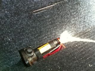

Jack location:

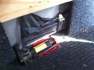

Like FlyingWil's , I left my jack in the stock location. If I would do the platform over, I would have raised it higher than the jack mount and then made another access hatch to it. Oh well. I made a hinged door to gain access to the jack kit:
This is a better shot of the side and the amount of space under the platform. I am thinking tow strap, first aid kit, recovery gear, spare batteries, rain jacket...the stuff you need to get at without unloading the truck.
