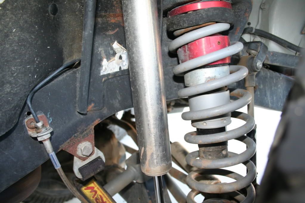

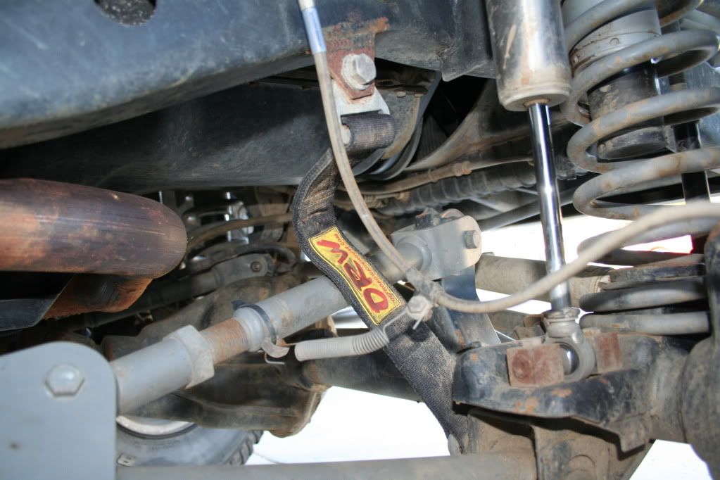

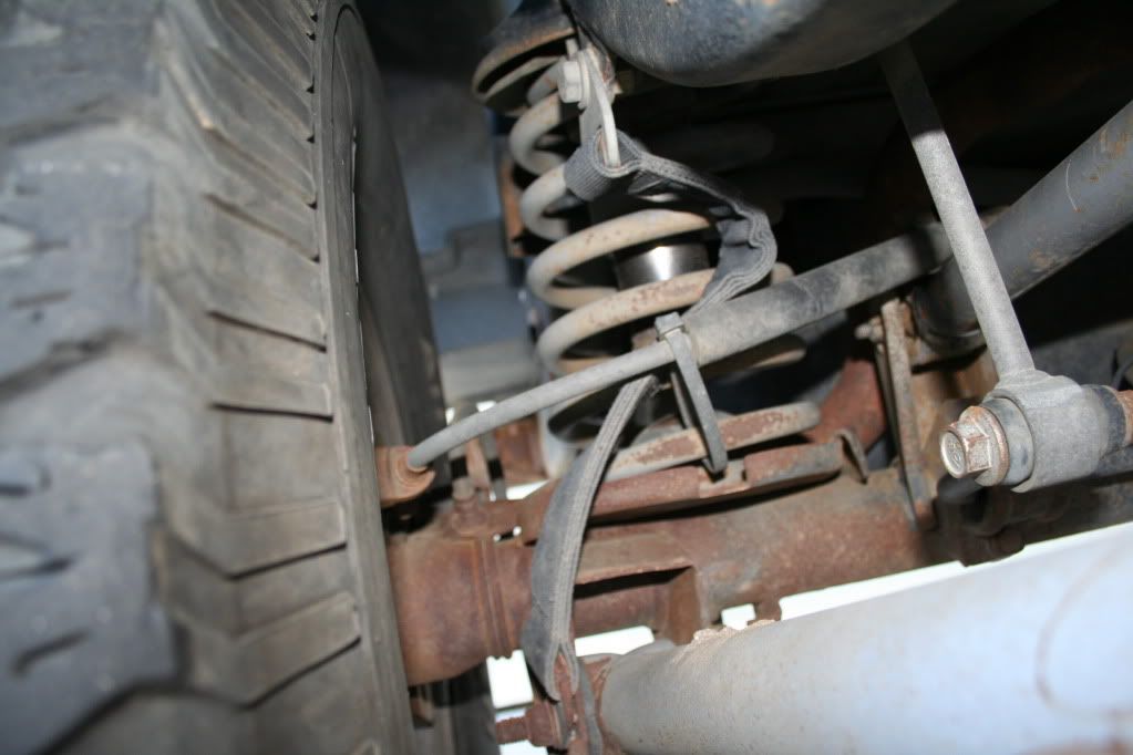

Don't intend to thread jack you, but here's some shots of my front limit straps/shocks/bumps for whoever might be interested. Not the greatest pics, next time I have the wheels off and it's on a rack at full droop I can get more/better shots if someone wants them.
Standard precut shock tab welded to the frame, the other end of the limit strap goes to the lower control arm mount bolt, inboard side. That's RE's version of the Light Racing Jounce hydraulic bump stop inside the coil spring. Turns out King bumps will fit inside a JKS adjustable spacer.
Frame mount for the front. Rear is essentially the same. We set them up so that 17" straps are used front and rear.
Same set up on the rears except that the strap mounts to the outboard side of the lower control arm.
Front set up.
Modified upper shock mounts, converted to a standard mount rather than the stock bayonet style mount. We tucked the reservoirs for the shocks up out of the way. Doesn't look as flashy, but I've yet to damage one.
Another look at thew bump install.
You can look at my shocks in the pics and see that they never bottom out, if I had droop pics, the straps are tight before the shocks are fully extended.
