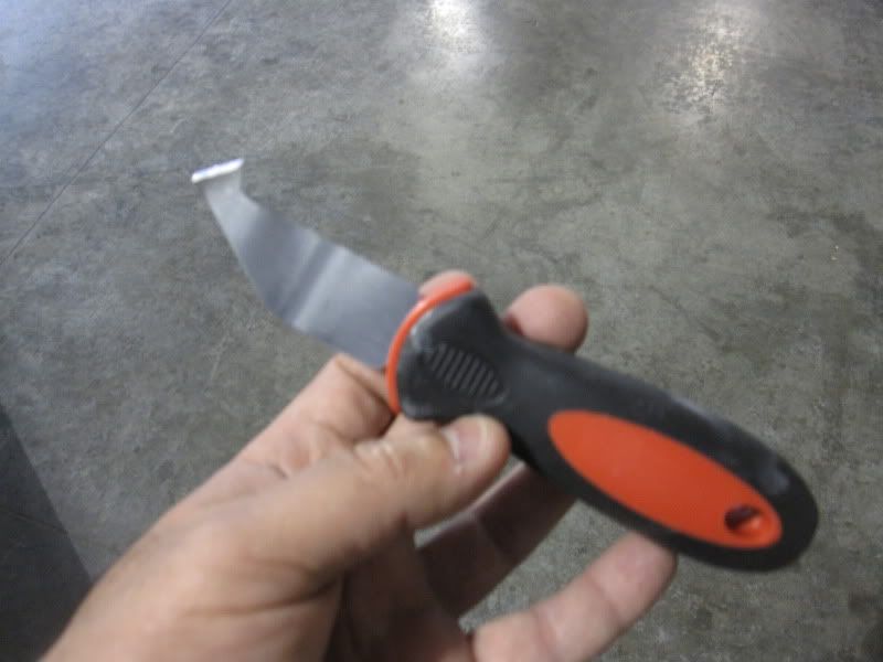

The broken window was shattered; urchin-like chunks and a fine glass dust rained down on everything underneath it. This was not safety glass, as the pieces were sharp and insidiously small. I donned safety glasses, put on a mask, and began removing the seal, and its attached shards, with a razor. As I pulled, tiny razor-sharp diamonds spat out at my face. If I had to do this over again, I would wear a mop suit, as glass found its way into my pockets, under my collar, and between my fingers. If you take one bit of advice away from this, please--glove up and cover up. I am, one week later, removing glass splinters from my fingers and neck.
Once the rubber was removed, I sanded the rest down with a 100-grit sandpaper sponge and went to work on shaping a replacement window.

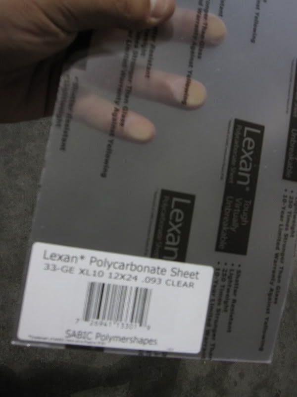

Lexan advertises that its product is 250 times stronger than glass. I think that's an understatement. The stuff is amazing. They should make bank vaults and condoms for teenagers out of it.
I placed the Lexan sheet over the remaining "good" window, and traced out, with a Sharpie marker, an imperfect but passable jig to fit in place. It wasn't pretty, but it just might work.
They sell a tool next to the Lexan glass sheets, a razor-sharp scorer that theoretically should cut through the Lexan sheet in a straight line, eventually. This might work for cutting a straight-edge piece of the plastic sheet, but did not work for carving out a Partridge Family icon. Basically, it was useless.
I did find Lexan's Achilles Heel, however...apparently, it is no match for a pair of rusty, dull shears that I happened to find in a desk drawer.
The old POS shears cut through the Lexan accurately, cleanly, and easily. Knowing this beforehand might have saved me a half hour of scoring and bending and cussing and kvetching. A quick sanding with a 100-grit sandpaper sponge removed the sharp spurs off the edges of the Lexan.
I slathered a layer of Lexan silicone around the edges of the window sill, and pressed my window in as best I could. It's certainly an inelegant solution, but it's functional. I will pick up a tinting kit from the auto parts store and see if that doesn't camouflage its homeliness and amateurish application.

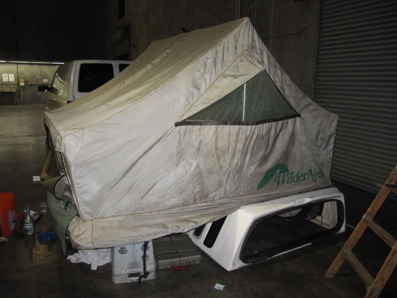

Once the tent was popped up, the smell was pretty bad. A quick sniff-test of the mattress indicated that it was the main culprit. Turns out, open cell foam is basically a big sponge, and it soaks up all the moisture and bacteria and makes a little colony of smelly critters. Note to self: Open-cell foam mattresses are a bad idea. After its removal and placement in the bin, the smell inside the tent improved dramatically.
I am lucky to have a space where I could de-mount the camper and have a dry, clean place to work on it for the next week or two.

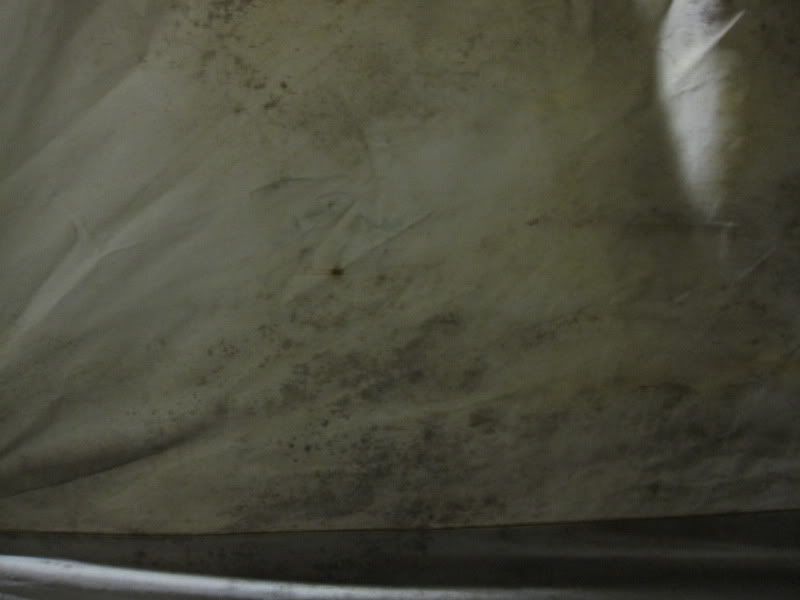

You can see two sections in the middle, as well as two corners, that are rather stained. This turned out to be a combination of mold and dirt.
The girl at the camp store recommended this product from Gear Aid (McNett), called MiraZyme. It is purported to remove odor and mildew, bacteria, etc. and is safe for use on water-resistant synthetics and impregnated canvas. In addition, it is apparently all natural.
I used a ratio of 1 oz. per quart of warm water in a spray bottle, double the recommended strength, due to the severity of the mold. Sprayed the tent down, inside and out, and left it to dry overnight.
The next day, I noticed a marked improvement in the appearance of the mold. It seemed to have subsided somewhat, even without scrubbing. I repeated the process again, and left the tent to dry overnight.
On the third day, I felt the moldy areas, and the mold was beginning to flake off as a dry powder. I made a ratio 4 oz. to 1 quart Simple Green, mixed with warm water in a spray bottle, and sprayed the tent down. I scrubbed it with a stiff brush. This was a mistake, as I should have used a scouring sponge or something with softer bristles. I wore a small hole in the tent just along one seam. Luckily I caught it, and quit using the brush altogether, opting instead for a dish sponge with scouring side. This, along with the Simple Green, proved effective in removing the bulk of the mold from the two most prominent growths. However, the mold had left stains which appeared to be almost tattooed into the fabric, so in the interest of salvaging what was left of the material, I rinsed it down and let it dry, stains and all.

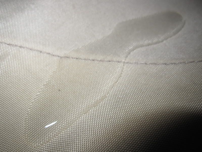

I had noticed that the previous owner had done a great job of sealing the seams of the tent, as every inch of the tent would get soaked, except the seams. I figured it was time to re-waterproof the tent.
My girl at the camp store recommended Atsko Silicone Water Guard. She said it was what she used, and she looked like the type who's spent many a rainy night in a tent, eating granola and humming Phish tunes, so I trusted her instinct. At ~$8 a bottle (as opposed to $4 for ScotchGard), it wasn't easy.
resize
She was right. I bought 4 bottles, and spent two on the roof alone, with another two for the sides and skirts of the tent. The stuff went on kind of thick, but soaked in quickly. I let it cure over the weekend, giving it 72-96 hours to bind up and get flexible. A test of the waterproofing, by making indentations along a seam, then pouring water directly into the depressions and letting it sit all day, proved to my satisfaction that the stuff is legit. Hopefully, it stands up to bending and UV and hot and cold and salt air and.....
