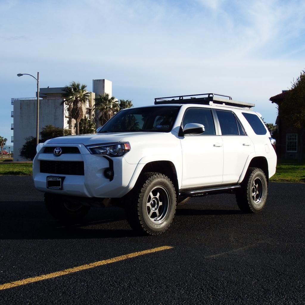

Fast forward and here I am it's a bit of a mild build although I am seriously thinking about Front and rear lockers along with shorter gearing. It currently has an OME lift 883s in front with Toytec 1/4" spacers and OME trim packer on the driver side and 895e's in rear with Ome struts and dampers. I swapped the wheels out today for FJ wheels and some BFG 275-70-17's. Next up I am going to mount the front runner rack I am working on in the garage I am swapping out all of the hardware to stainless steel and modifying an INNO Wind Fairing for the front. After this I plan on some under armor, 2nd battery, Awning and possibly Solar panels for the second battery. Here is a picture of how it currently stands with more to come.

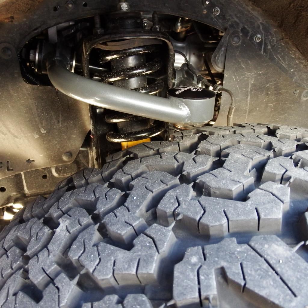

I have since changed a lot to the suspension as well I ditched the 883 front springs and spacers for a set of 884's since I went with a taller spring I went with Camburg upper control arms to get my alignment back to spec. Also added some Wheelers super bumps.

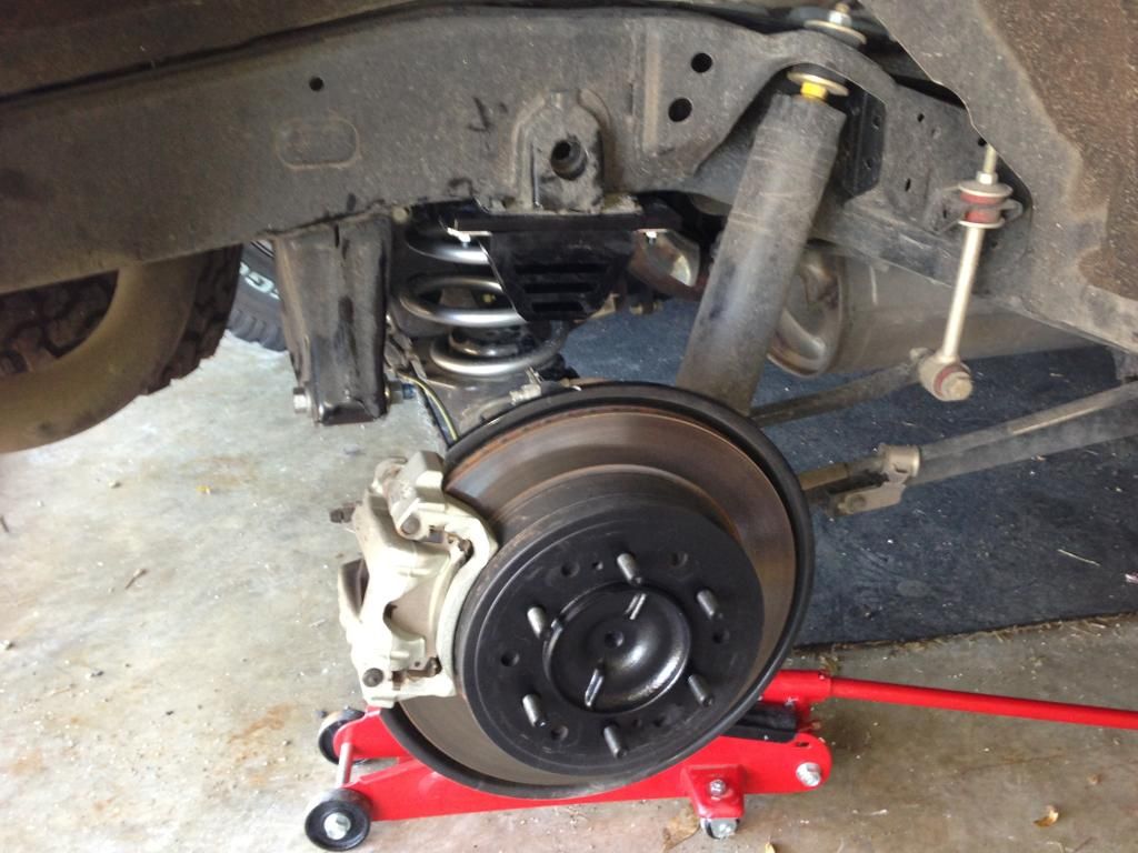

In the rear I am now running sway away rear springs instead of the 895e's. I have also added a Sonoran Steel Pan hard bar & bump stops and a set of longer links for the rear sway bar. Next I am going to replace those tiny lower control arms for some Sonoran Steels.

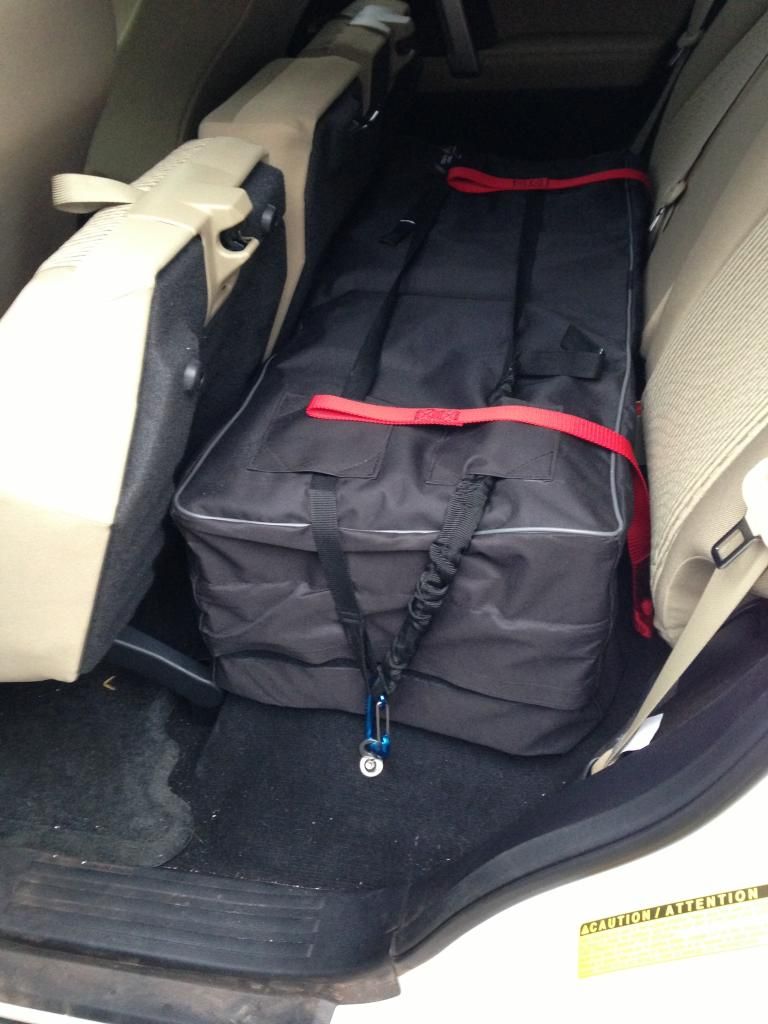

Also since I take the lower seats out when on the roam I came up with a way of securing a couple of Front runner wolf pack boxes I took advantage of their Christmas special and bought a couple of their transit bags for securing cargo. I found some nifty little mounts @ Expedition Exchange and mounted them with some fender washers. This plus some straps and D-rings mounted to the lower seat bolts secures the cargo. Below is a pic I took with the Transit bag in place partially secured.

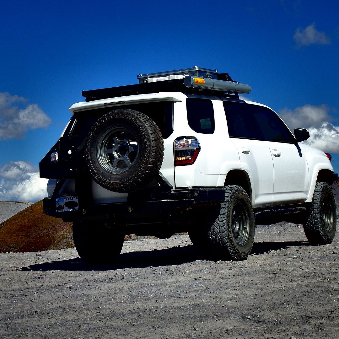

Another update and a few more upgrades. After deciding not to go forward on another auto related project it was time to get some bumpers on this rig. After lots of looking I decided on a set of Hefty fab bumpers with rear having dual swing outs. Since I live on the coast and have watched all of my steel bumpers rust away I decided it was worth the extra money to have them built out of aluminum. Another plus is it's a lot less weight on the truck since these 4Runners are such rocket ships! lol... Well the wife and I decided it was time to get out of the Tejas heat so I planned on just having the bumpers and winch installed at Hefty Fab in Colorado. After a quick Road trip I was at Chris's shop and him and his guys had everything installed and got me back on the road before I knew it. Everything went smoothly and I could not be happier I am really glad I went this route! Any way with some time to burn I decided to head up to the San Juans and hit some trails. I originally was going to head back early but decided on staying an extra day and just driving straight back. Here are some pics in all the usual spots!

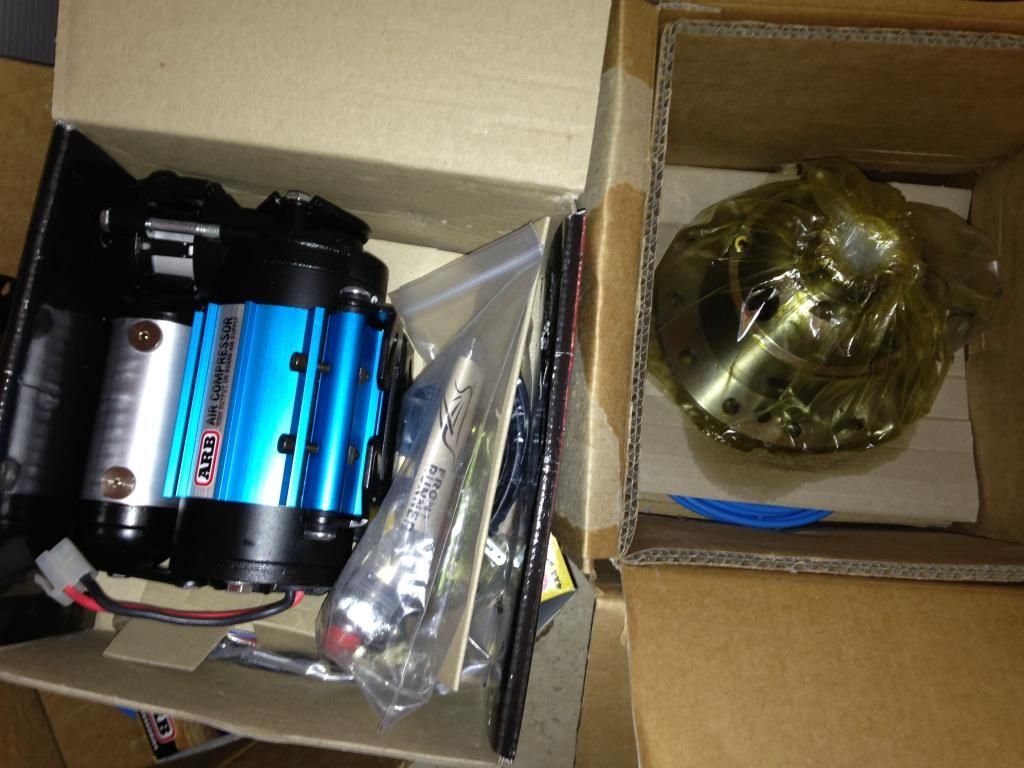

I have also gotten around to installing my ARB compressor so I have no real excuse not to install my gears and locker any more other than time. I have also started installing my Shrockworks dual battery kit which I need to finish as well.

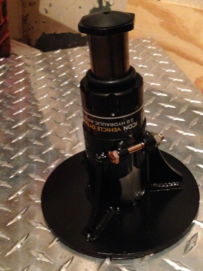

Tomorrow I will probably swap out my rear SAW springs back to my OME's along with a set of Icon Hydraulic Bump stops for smoother landings....at least I hope so lol... Below is a Pic of one of the rears should be interesting.
