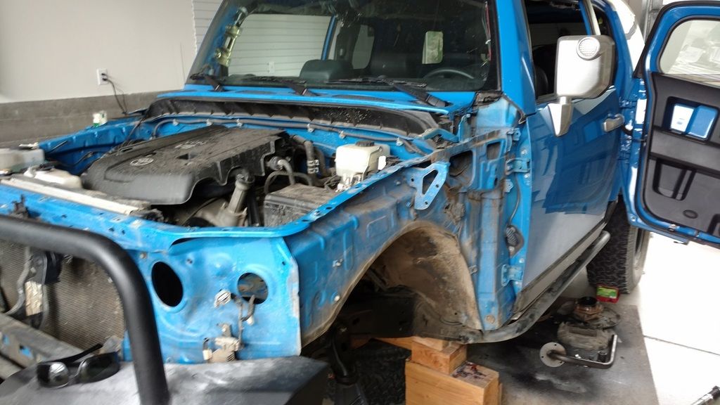

Toyota FJ Cruiser strip down

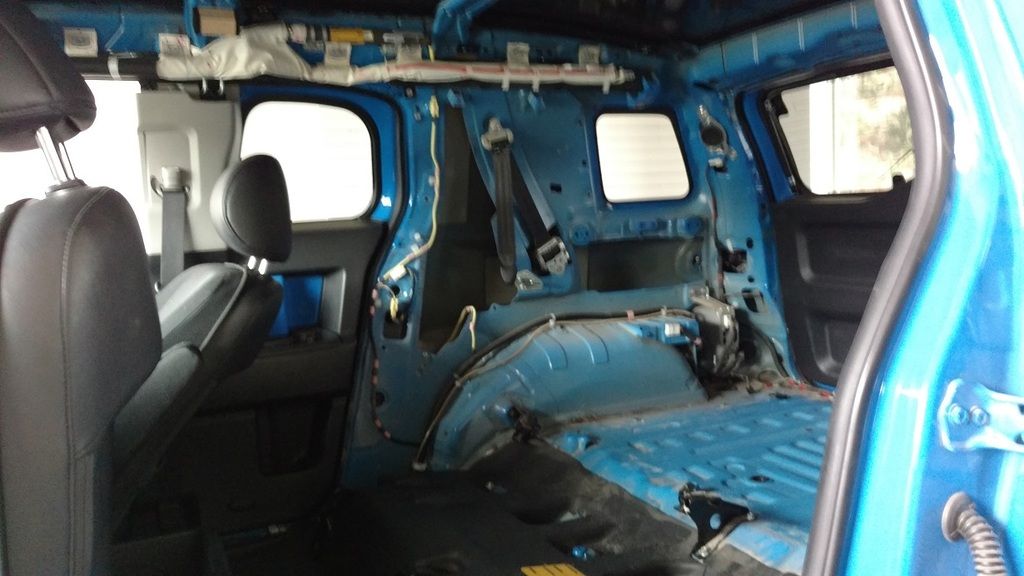

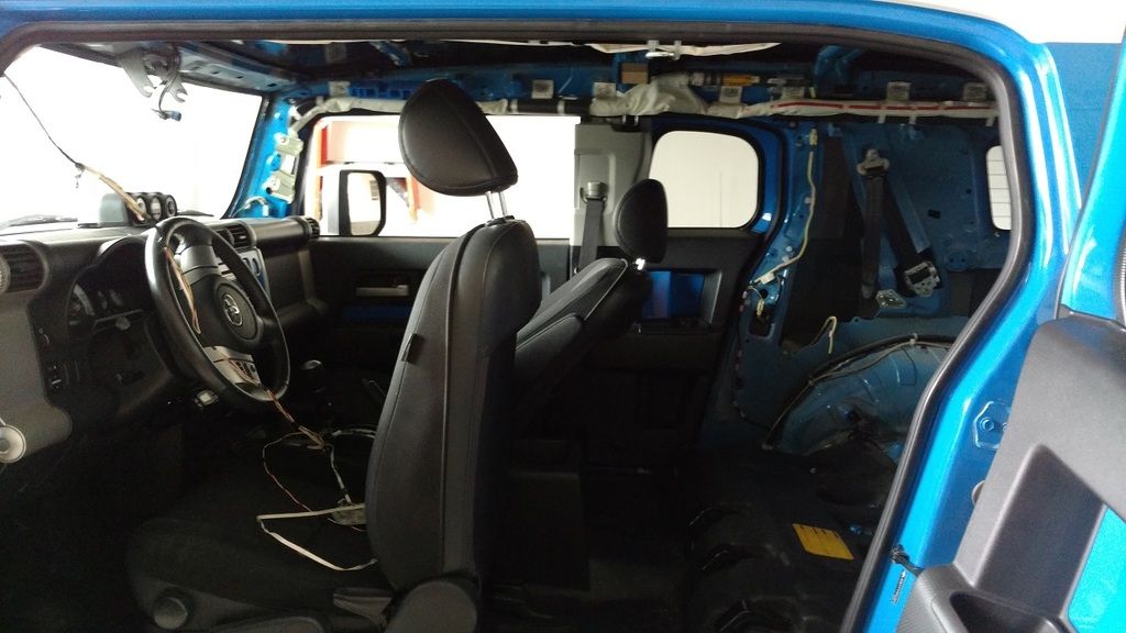

The first thing with this build was to remove all the unnecessary interior while we build the cage. We also are going to eliminate all the sheet metal in the front and build a tube structure.

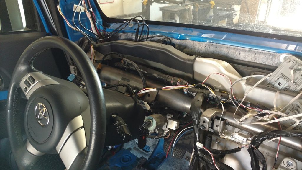

Lots of sheet metal to remove, along with the dash and windshield.

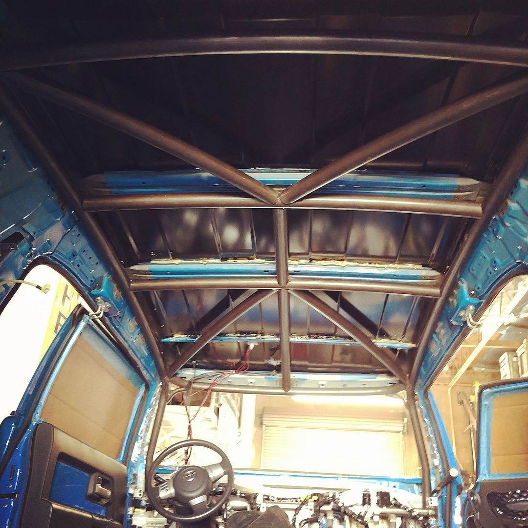

With the dash out and wiring moved around, we started on the interior of the cab cage. We are doing A rolled roof inside to really hug the roof line.
You almost cant see the tube... 1.75 x .120 cromolly tubing

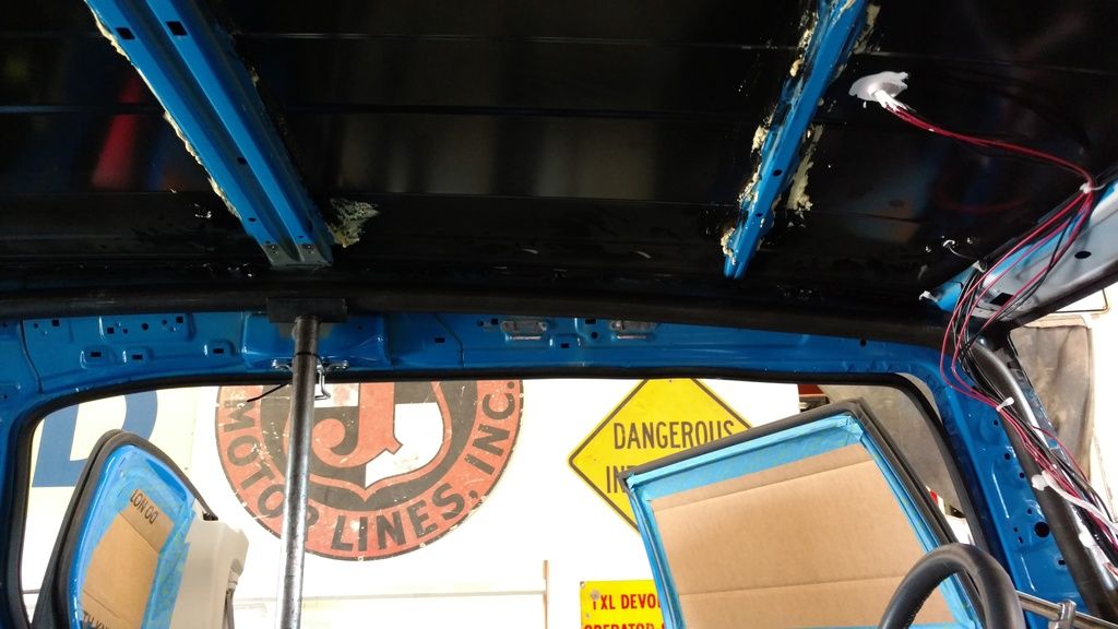

With the dash completely removed the main pillar tubes fight tight along the sheet metal and windshield.

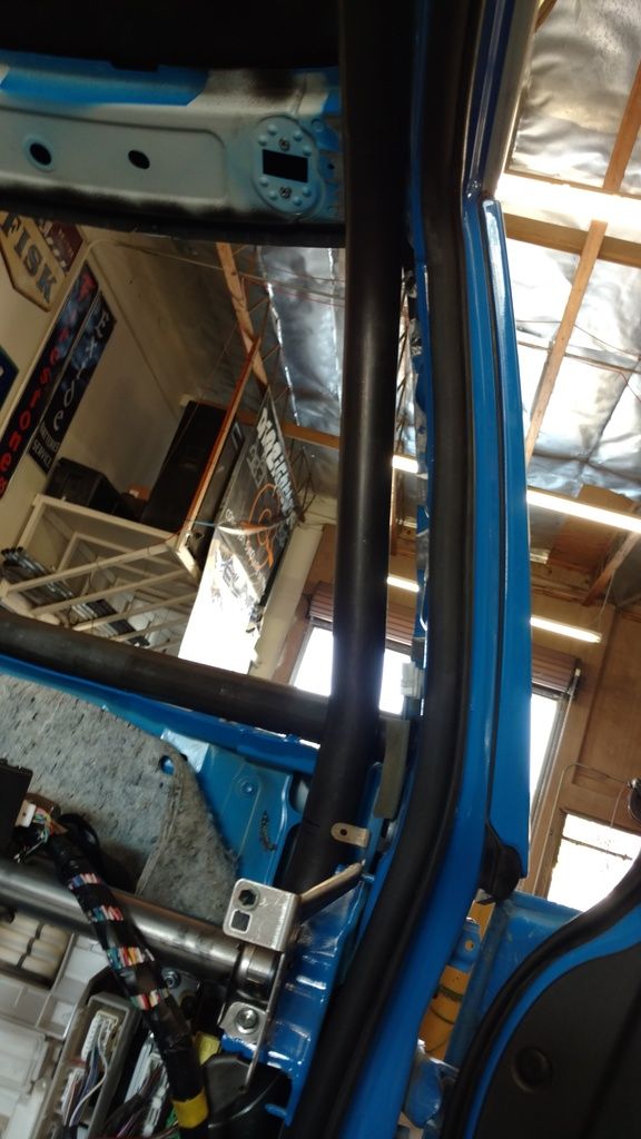

more roll cage work
The entire interior cab cage is rolled tubes to give it a really clean look and its strong. Here are more pics of the inside as we keep building.
All the tubes are coming together nicely and this cage is really starting to take shape.
