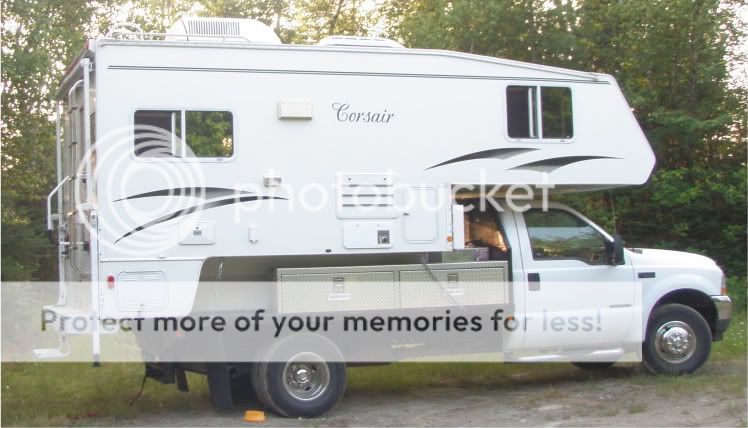

So we are planning on heading on a loooong 6 month trip with our ford f350 flatbed 4x4 with our corsair excella camper on the back.
We are planning on a long extended tour of the rockies and then the sierras, possibly baja for some surfing, the pnw, and then up to Alaska for some exploration and possibly heading up as far as we can go. As of right the itinerary is open as we are looking for a new place to live in the mountains, with a handful of adventure along the way.
The tires are some generic 235/,,,,/16 tires that were cheap, but newish, possibly only have about 1500 miles on them. The truck has 4x4. I am wondering if they are worth replacing before the trip with something really good or if I should just wear them down on the trip and then replace them while we are on the road if needed. This is my first dually so I don't really know what to expect. My last truck was a single rear wheel f350 that got plenty of use in work, plowing, and traveling, and I never had a tire issue, as I had good tires. So now having the dually and travelling through the snowy winters will be a learning experience.
How about some high load rated all terrain suggestions for a dually with a nod towards longetivity and drive-ability.

The tires are a 235/85/16 e rated mud and snow. The truck is a 2002 f350 diesel. Not sure of the rim width but it is whatever the stock steel ford rims are. Clearance is about 8 inches with the camper loaded and a full fuel tank for the auxiliary tank. The overloads are just slightly engaged. My instinct tells me not to put a taller tire on for clearance issues. I don't want to raise the truck higher to fit a taller tire. I would like to get some new shocks and airbags to help return the truck to closer to stock ride height and to improve the ride quality.
My inclination is to use up the tires until they need to be replaced and to spend the money on the above items and other things on my long list of things to buy for this trip.
