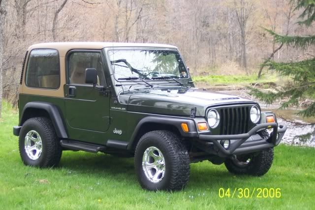

I came back and added this. Heres' my old 98 4 popper, 31s, stock, no lift. It was a fun ride but I've never looked back since I got the LJ.
