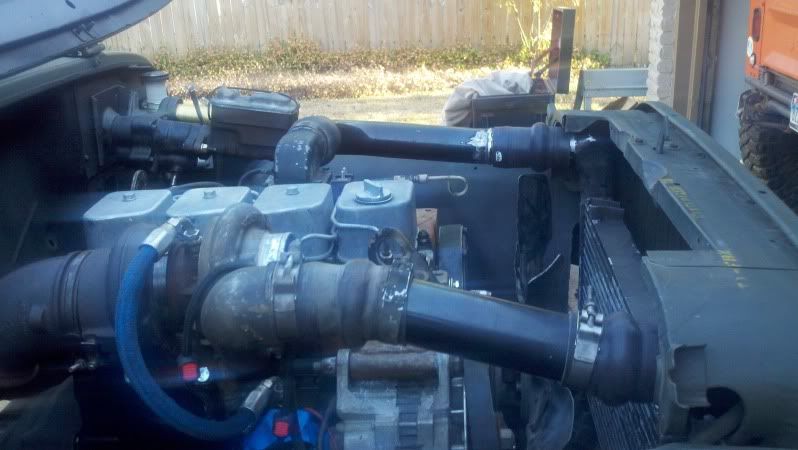

I went through this with my Jeep. There are choices out there, but a lot of them stink. The ones I can think of off of the top of my head:

Cummins -
4a -
Good little motor, phoenix castings makes a good SAE4 adapter, parts availability is good from Cummins, but can be sketchy from anyone else. They were never put in road vehicles, so you are on your own with an accessory drive, unlike all the rest of the motors listed. They have an alternator, but AC, power steering, etc. is going to have to be fabricated.
4BT -
I am a little biased because this is the motor I want with, but I think it has some really good things going for it:
My accessory drive is from a 89 Dodge Cummins truck. Parts are easy to find.
It makes good power, and it is easy to turn up if you want more. Most of the modifications are well proven from the big brother, the 6BT.
My adapter is a factory Dodge adapter, so flywheel, starter, etc. is all very available.
For my application, the 4BT was an easy somewhat bolt in swap with good parts availability, which is what I was looking for. With some more creative work any of those motors would work just fine.
Besides, a 4BT looks great in a Jeep engine bay!
