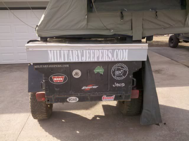

I agonized for a while on whether to cut in a tailgate or not.
I decided against doing it, since I can still open the lid even while the RTT is deployed.
And, since my table hangs off the back, instead of over the fender like some folks do, I can reach almost everything in the tub.
Things I cannot reach, I use a small stick to get them within reach. (but I try and put the action packers/coolers on the far side, so I can reach them easily)
Closed:
Open:
Table placement:
While I think a tailgate would be nice, and I know I could fab up a decent one, I just haven't been able to bring myself to do any permanent mods to the trailer.
As it sits now, everything could be easily reversed, and bring the trailer back to stock specs.
