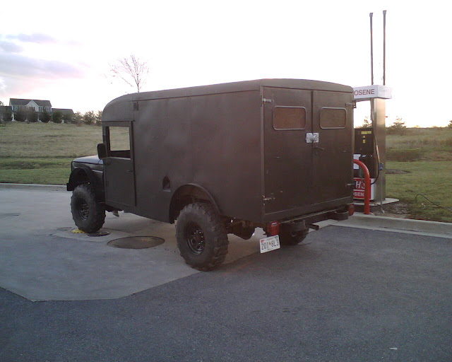

A few years ago we picked up a jeep M725 (5/4 ton ambulance) to use as a parts truck for our offroad shop. Being completely stock we had a little fun with it
Before:
After:
Updates:
2005 Hemi/545RFE (30k miles) from dodge durago. ECU reprogrammed and tuned.
Chevy 14 bolt rear with disk brake conversion (needed to clear the rear springs on the 725).
D44 front (to be replaced with a D60). Complete 2nd Gen Dodge 2500 front suspension. Yes, its now a coil spring front end.
What I've been thinking. We're out growing the Jeep (1997 TJ) and need something bigger. I've been seriously looking at a J8 though it puts a hurting on the budget. I've also been looking at importing a D110. The next option was to pickup a diesel 2nd Gen ram and start building that.
Out of the current 'add a vehicle' ideas I like the 2nd Gen ram cummins the best. But, I already own the 725. Downside being gas, but the upside is that it isn't all that bad on fuel so far (much better than my TJ).
What I'm thinking:
Swap in an Atlas t-case, D60 front. Lock the front and rear, ensure decent cooling system is in place, and start modding the box area for expo travels. Would probably raise it another foot or so behind the driving area to make sure you can stand up in the back.
I'd question reliability of such an old vehicle, but honestly its got less rust on it than any of the parts trucks we worked with when building it. The engine is nearly new and has low miles to it. The frame is VERY well built. The drivetrain also has all nearly new and easily serviceable parts.''

You pretty much gotta go with the jeep! You've got the engine and tranny done so what is a bit more for axle and t-case? The coolness factor is way high as well! Best part... you own it already!

I love the M725 so I would continue with the upgrades. Maybe making the rear box a pop-up to keep a lower profile during transit.:smiley_drive:
You could always swap in a 6BT cummins+drivetrain out of a wrecked late model dodge later on if a good deal presents itself. I'm hating most of the newer vehicles these days.

This truck was originally supposed to have a full 1989 Gen I cummins drivetrain swap. But the deal fell through and it was getting to be pretty expensive to source all of the necessary parts to do that swap.
The 6bt is a tight fit in those trucks. Its long enough that you need to go cutting into the firewall to get it to sit back far enough to have a reasonable size radiator. After that there's pretty much no room for a reasonable front mount intercooler. Could possibly source a water/air one so who knows.
Got the Hemi, 545rfe, and t-case for $1200, couldn't pass that up. Was looking at 5-7k for the Cummins once I had all of the odds and ends figured into it. Not to mention how much heavier that engine is.
This truck would honestly be powered pretty well by a 4bt, but finding one of those at a price that makes sense just hasn't happened yet.
At least with the Hemi, its a pretty common engine. Its got better oil pan clearance then I'd be able to manage with a cummins. With the nearly 37s and 4.10s the truck really gets out of its own way.

Ah, no.. haven't out grown the 725 Jeep. Starting the outgrow the little Jeep (1997 TJ) for the longer trips. I'm not getting rid of my TJ if we go this route. Still need something to play with for the more technical trails and shorter trips.

The engine is done, running and happy :).. Not really looking to mess with that in this version of the build.
If it becomes and issue later I'll play with it, but there's plenty of room under the truck to carry enough gas to get the range needed.
