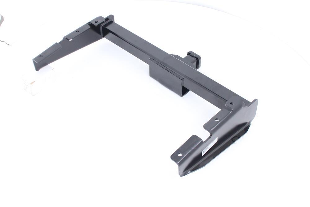

This is the hitch receiver the OP has, it only attaches to one small area on a cross bar:
This would be a hitch receiver designed to carry a heavier load. It attaches to far more of an area than the one above. This helps to distribute the weight better.
:Wow1: Wow... I'd consider that hitch to be decorative, much like a bumper hitch. You couldn't pay me to ever attach a trailer or another vehicle to it!
