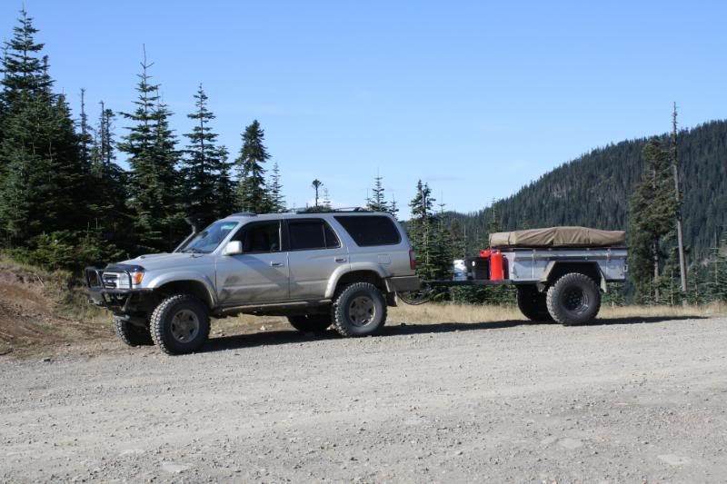

OldSven
I have pulled my trailer with my old Badland bumper and now with the one I made for the 4runner. Neither are DOT approved but will hold up better than most DOT bumpers out there.
