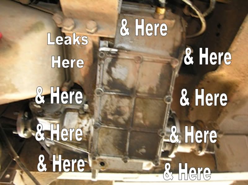

This first photo is of a typical LR t-case (this one is actually from a Range Rover w/ the drain plug in a different location than the series but you get the general idea. I've highlighted areas prone to leaking.

So basically the stock part leaks at every bolt hole? Are they thru-threaded holes in the case, or blind threaded holes?
I can see dumping the cork gasket, especially in favor of the "Right Stuff." In some cases loosing such a gasket results in interference. I'm guessing not here?

They're blind 1/4-20 holes. The pans on the Series trucks are tin and are usually bent up from use and over-tightening. An aluminum pan is stronger and flatter and also helps add some strength to the transfer case as a whole. I also use studs on mine and as such can tighten the pan down tighter than you'd dare with just bolts.

No, not the holes specifically, usually it is the edges because of it's thickness and variations. I just put the photo for comic effect. I should've made the "& here"'s smaller and put more so as not to confuse w/ the bolt holes. :D
