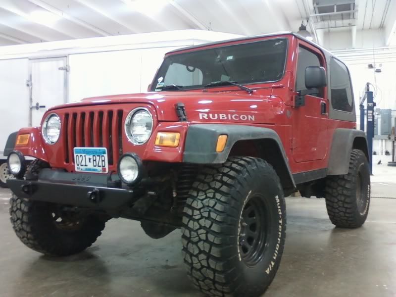

Here's my buddy Daves rig. I'm pretty sure he has no body lift, just a 2" BB right now.
He has since removed the wheel spacers and swapped the flares for stock Rubi ones. Tires are 33"
