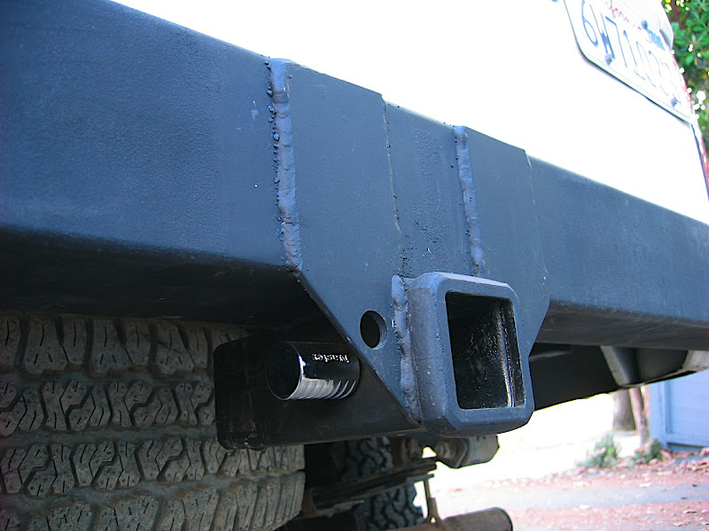

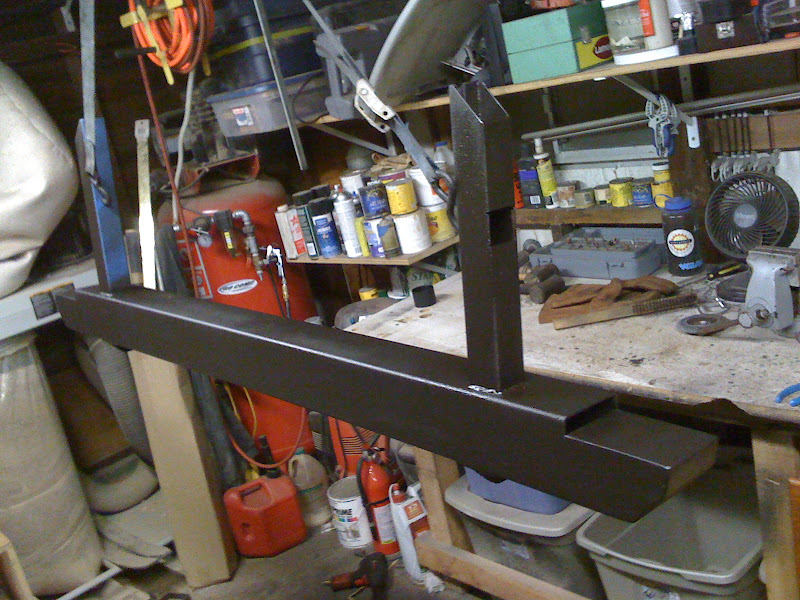

nice looking bumper, got more pics?
thanks, take a gander:
here's a link to the build pics

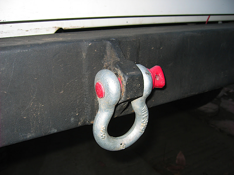

It's changed a bit since the build pics, I added the 2" receiver, and the shackle mounts had to change, I notched them out and welded on big 1" nuts. I would never powder coat any of my modifications for the simple reason that they never seem to be quite finished...
