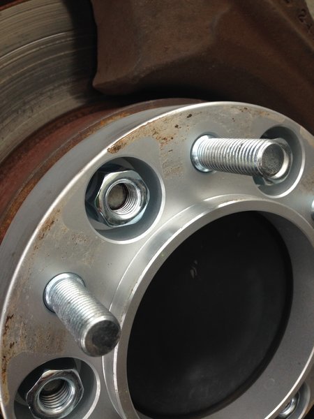

Well I tried some 1.5" spacers from Supreme Suspensions and this is the result I got:
I'll likely return them and try another set from a company known to produce spacers that don't result in lacking thread engagement.

I'd call the company first. Do the nuts have extended threads?
bkg
Go with a quality vendor. Got mine on amazon (1.25") that are hub centeicm and came specifically with extended nuts for the front and clear instructions that engagement is critical.
I would order a set of Spidertrax Spacers because they will fit out of the box (unless something is funny with your Tundra). I have them on my 06 Tundra as pictured and have full engagement of the nuts. They are very popular with the Toyota crowd: http://www.spidertrax.com/Toyota-Hub-Centric-Spacer-Black?sc=2&category=9983
Wheelers Offroad or Toytec are also great online vendors that do a ton of Toyota stuff and can sell you spacers that will fit without stud or nut mods:
wheelersoffroad.com and http://toyteclifts.3dcartstores.com/
toyotech
Most hub centric spacers everyone is running are 1.25 spacers. I'm wondering if the 1.5 spacer is thicker where the studs are. I know my 1.25 Spidertrax worked with original studs with full engagement with supplied nuts on my 2004 tundra

It's my understanding that for whatever reason the studs on the back don't have the same problem. I haven't test fitted them back there yet so I'm not sure.
I wonder if brake rotors were different sizes? Here is a post from back in 2012 detailing a similar issue.
I'm still a bit leary of ET Nuts. I feel like your still shifting the weight of the load out to the end of the stud, and while you might achieve proper torque, you've still got the load on a spot of the studs where it was not intended.
I actually kinda like the idea of getting longer studs and open ended lug nuts for if I ever run the stock wheels without the spacers.
