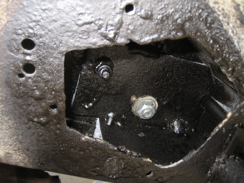

popping sound

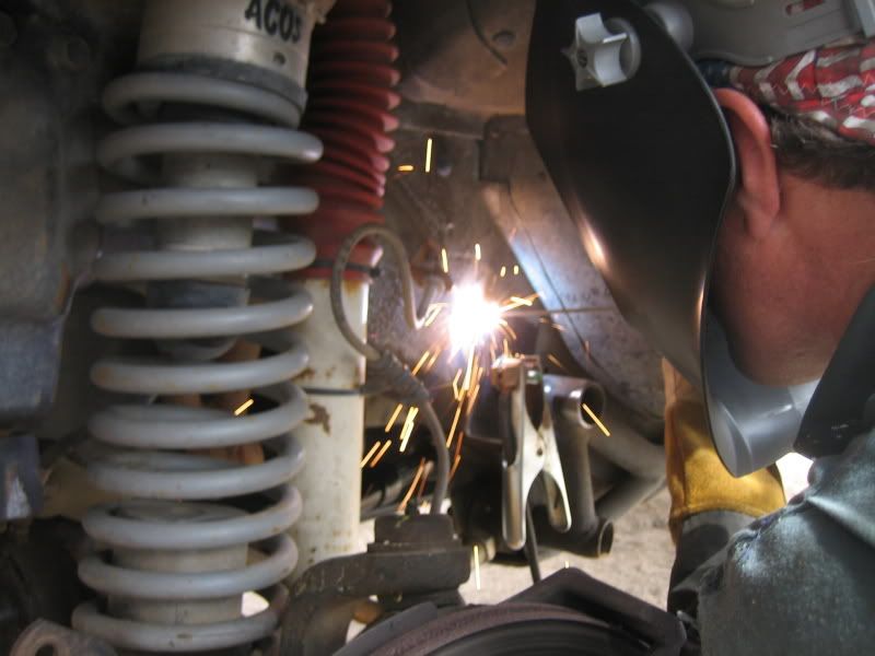

The popping sound was the sheet metal snapping at the crack. Because it was behind (inside of the arm) you really couldn't see the crack. Here is the trail fix that lasted the rest of the 2 days and 250 mile trip back home (the boalt broke about 10 miles from home but the other three ams held it together until I made it)
Thanks,
Fred

It's kinda a common problem with a 4-link/panhard front combined with flex... There's a huge amount of inherent bind, and eventually something is going to give.

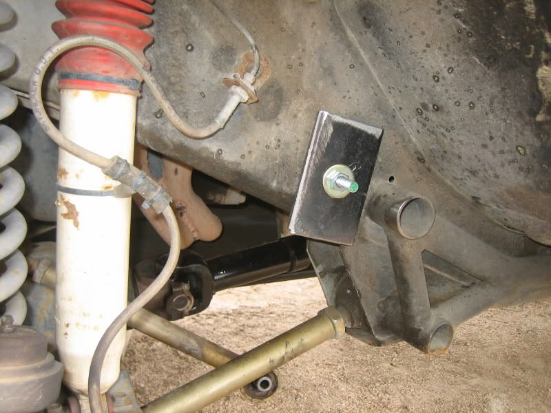

Kinda bummer that you were being proactive with the lower stiffener capturing the LCA area in JeepSpeed style (T&J Stiffener?) but there was nothing on the upper arm area. I don't even think there is a product on the market to do anything like that. Have to roll your own.
Do the JeepSpeeders have a work around?
Eric S.
I knew the bottom brackets were subject to cracking but I guess if you brace them the next weakest link is the upper bracket. Looks like my plans for reinforcing the bottom bracket will have to be revised to include the top as well!

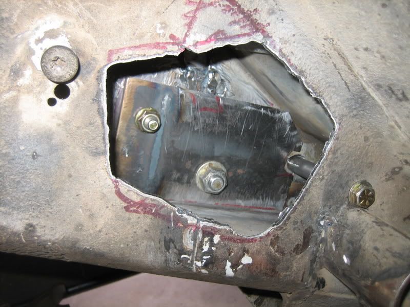

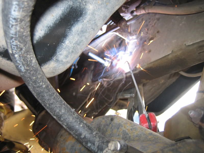

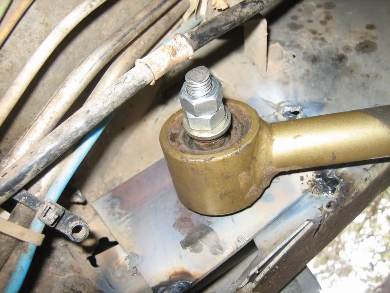

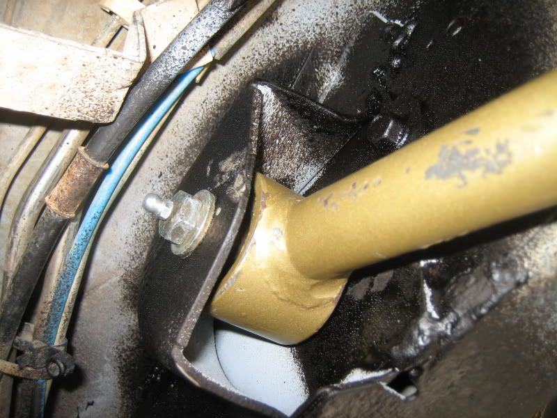

Final Fix

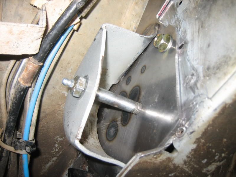

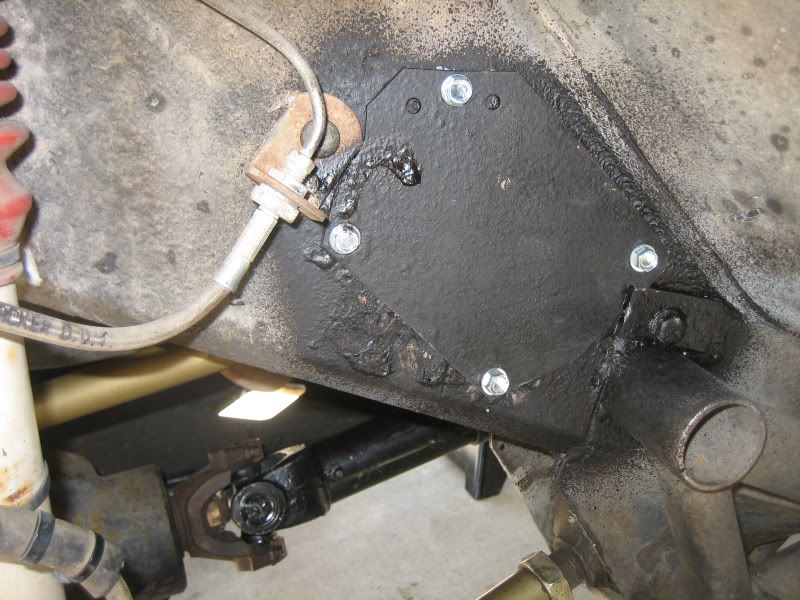

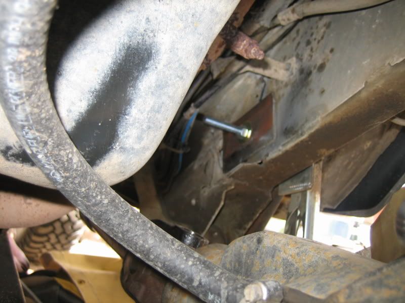

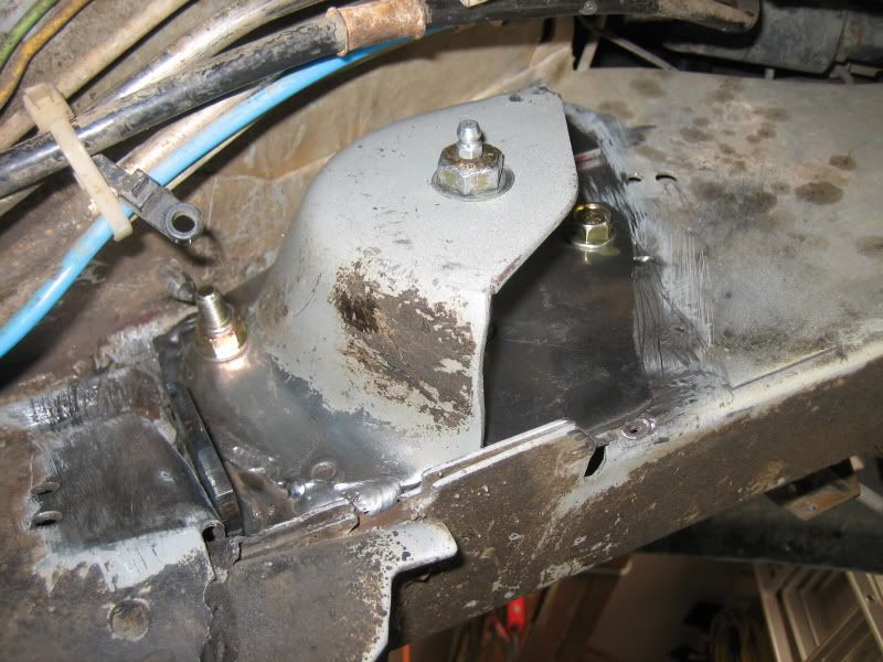

Here is my final fix, hopefully it will be stronger than it was originally. Worling with torn sheet metel was a bit of a hassle. I had to make/fab parts to attach to the uni-body and then figure ways to reinforce the weak spots.
Maybe over kill, but I go to Moab next month and didn't want to deal with this problem ever again.
