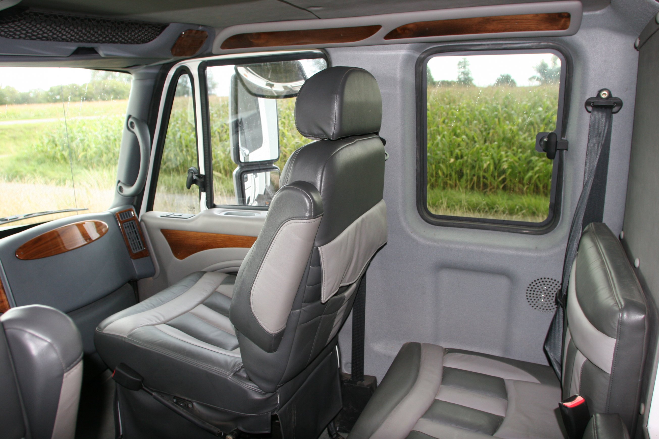

Cab
Upgraded cab - leather & wood trim, additional insulation
SS fire extinguisher at floor on left side of driver seat
Seats - adjustable air suspension front
Cab rear suspension air bag type
Power windows & doors w/remote control
Full gauges & instrumentation
Cobra CB radio
Alpine CDA-9857 AM FM XM CD Ipod stereo system
GPS – Garmin 7500 w/rear view camera and weather fax

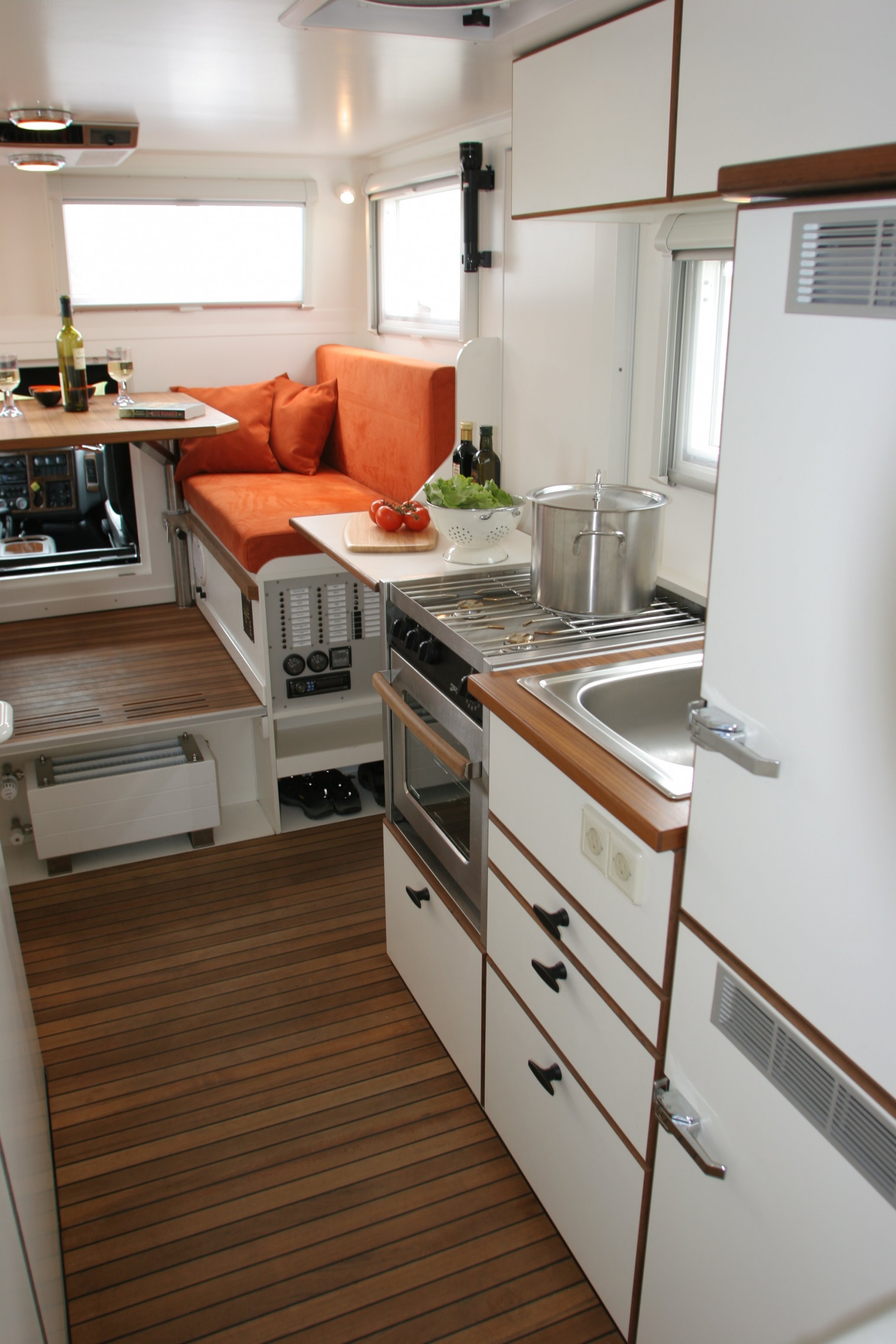

Seating area
Seating area for 2 - 4 people with adjustable swiveling table on pedestal in the front of the cabin
Seating unit converts to double bed

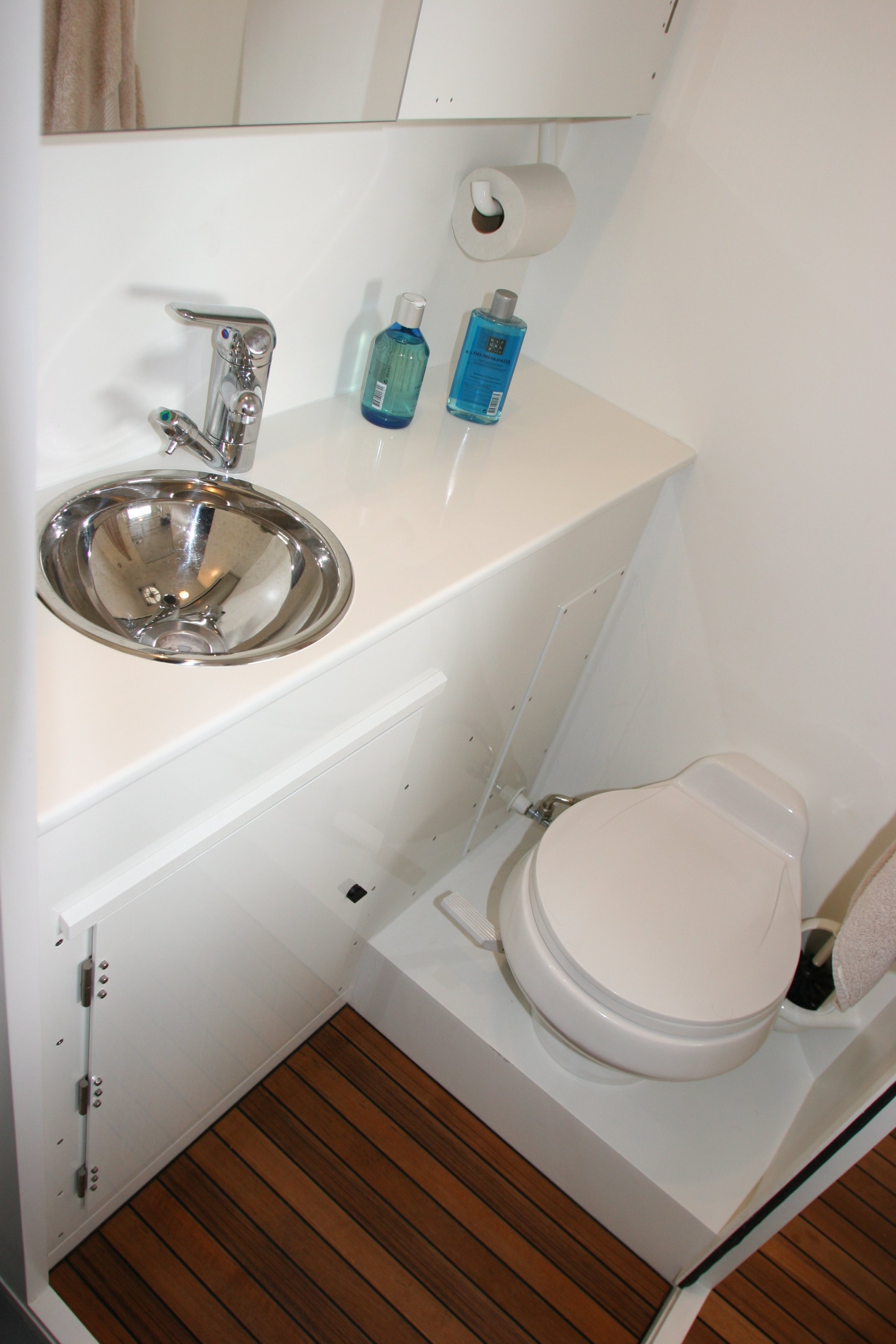

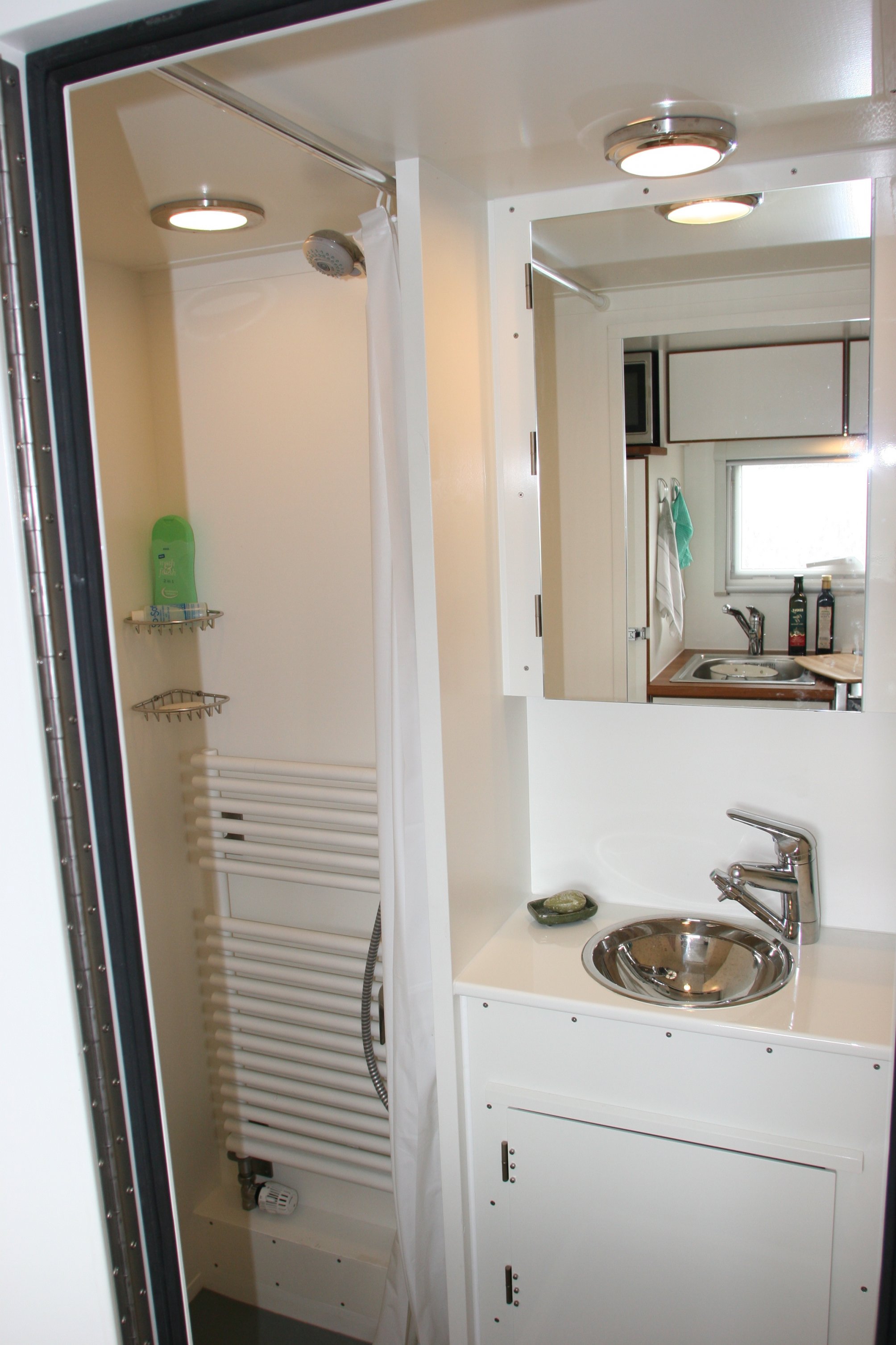

Sanitary room
Sealed fiberglass door to isolate bathroom from living area
SeaLand ceramic toilet system
Bath sink – SS w/extra faucet for filtered water, soap dish, towel hooks
Shower – full size w/adjustable height head, 2X soap/shampoo dishes, SS overhead drying bar
Medicine cabinet and storage under sink
Kitchen
Countertop with integrated SS sink
Collapsible counter top leaf to left of oven/range
Single handle faucet for warm and cold water, separate faucet for filtered water
SS soap dispenser, soap dish, towel hooks
Force10 LPG 3-flame range/oven
Sanyo 1.2 cubic foot SS microwave oven
Kitchen cabinets with locking drawers on ball bearings
Built-in drawer organizers
Overhead cupboards
Refrigeration – 2 X 113 liter Kissman w/small freezers, 45 qt freezer and in under bed storage compartment

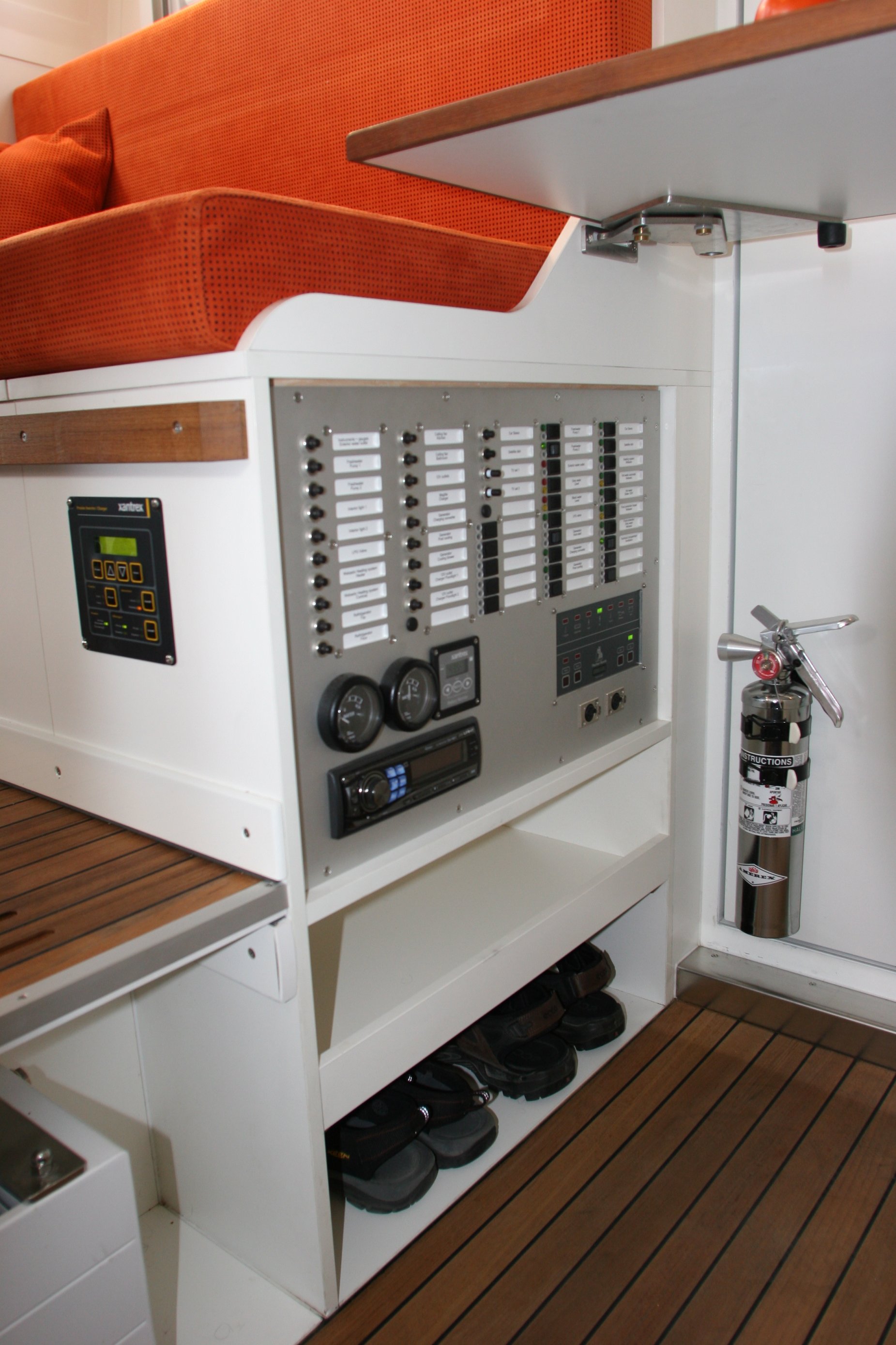

Technical equipment
Electrical equipment
Solar panels – 3 X 123w Sharp
Control panel for power management and monitoring of liquid levels
Battery main switch, safety cut-out, residual current breaker
DC power supplied by (4) AGM batteries bank, automatic regulated alternator and AC automatic I-U charger with cell temperature sensing for shore power hook-up
Battery capacity: 12V 840Ah
Shore charge rate: 14V 120A
Inverter – Outback 12V / 115V, max output 3.0 kW
Power plugs for 12V DC and 115V AC

Alarm system and emergency equipment
Fire, smoke and carbon monoxide detector/alarm
Mag-lite flashlight/charger at door
SS fire extinguisher at door

Sanitary room
Kitchen
Overhead cupboards

Technical equipment
