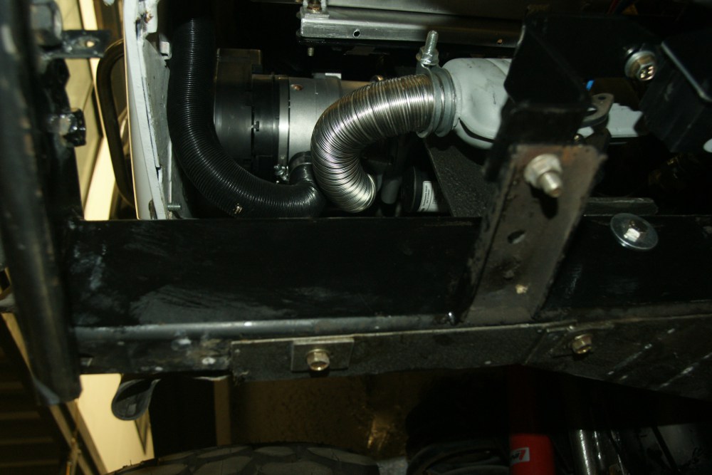

I plan to mount the D5 under the air filter housing as I has seen someone else on here do to also still allow for the cab to tilt when required.

I have the Webasto equivalent in my U1250. Are you planning on fitting a hot water tank, if so, then you will want to enable the engine coolant loop will provide heat to the hot water tank as well. My coolant loop system is extra complicated as I have a water cooled turbo as well.
This is my system.
I have fitted it under the air filter as well.

Well we got it in on Saturday and within 45 mins or so if run time the engine temp was up to 80deg.
We were fortunate that the fuel tank had an extra fuel draw, which I suspect was for a FM1 shelter as some point.
The Espar check valve also made it much easier to complete. About 6 hours total to install including raising the cab a couple of times to fix the seal around the bottom of the cab, fixing the signal lights.
Were using a friends shop and really needed to have it completed in the same day. I didn't get as many pictures as I was planning but I will try to get more in the future.
