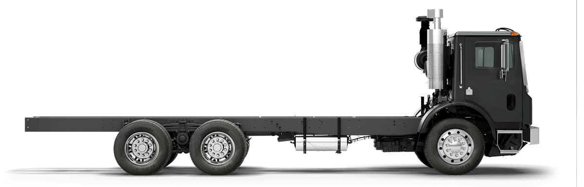

However, driving into work today, I saw a Mack truck with a cabover design. Their website shows both the LR and the TerraPro models. The LR looks closer to the "medium-duty" range of the Kenworth, but looks like it has serious ground clearance issues in the cab - it's made for crew getting in and out of it all day. However, the TerraPro looks more interesting. The marketing scree says it's designed for construction, which would imply some off-road usage. I've searched these forums, and found one thread from 2011 where it was discussed. Nothing since. Anybody know why the Mack TerraPro just isn't even on the radar in these build discussions? Is it too heavy for the application? (It can't be too far off the Acela, can it?) Is there some reason it can't undergo a custom 4x4 or 6x6 conversion like the Kenworth? Crazy expensive compared to the other options? Some other reason?

Well, I have at least a partial answer to the question - specs say the cab is optimized for a single operator. None of the pictures on the website show a second (passenger) seat. I wonder if that's fixable ...

Look at the astronomical GVWR.
I see that. But I'm a total rookie. Help me understand :) The low end of the Mack TerraPro GVWR range looks similar to the Acela Monterra 6x6 to me ... which was the platform for a beautiful SLRV build featured in another thread. And the Mack has several suspension options, including "vendor", which I suppose means you could adapt it to ride well at the lower end of the GVWR range?

Overland trucks want a softer suspension for comfort and better grip on uneven ground. Comes down to the weight of your camper. Many folks end up downrating the suspension by removing leaves or changing springs.
Do also note that a camper tends to have a constant weight, that is, it is not loaded and unloaded, but rather tends to run at a constant, heavy weight.
The chassis has possibilities…
Although I wouldn’t want something longer or heavier than what I have now due to mobility considerations.
The transmission options are good. I would consider the Roadranger 11 speed 9ALL in either manual or automated manual form. Even with a 2 speed transfer case.
And of course with full locking rears. And pick axle ratio carefully, with consideration to front driving axle that is planned, tire size, and transmission top gear.
PS: just looked up specs of available Mack 14 speed which is available as automated manual. REALLY good ratios: 0.78 top gear, 32.04 1st creeper gear. Better than 9ALL!!
Believe me, with something that big and heavy, you will be glad to have it eventually.
