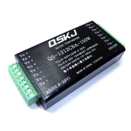

Very good! 12A/100w max output is the stumbling block but I'm very unfamiliar with these Webasto appliances and that may be more than enough. Bucks are cool but can cause interference issues with sensitive electronics and generally send RF noise through anything. Not saying that makes it unsuitable, just that it's something to consider. Nice find, DWH
Also, see the pair of big heatsinks on there? Heat = Inefficient.
Finally, that tiny brass screw in the blue block must be adjusted each time input voltage varies, or in this case, every time the battery temperature changes from 70° (or whatever the OPs battery charger/solar controller uses for default STC). Not super convenient, compared to say a big 4 position knob...anybody know if the Webasto has a low voltage cutoff?

i just ordered this DC-DC regulator/converter for a project: http://amzn.to/1HpynWJ
the specs say it should work for you - it's actually a wide-input buck/boost converter with an adjustable output in the range you need. i don't know for sure if it lives up to it's specs or not, but for the cost it might be worth a shot. it's made in china and sold on Amazon by RioRand and DROK, and also on eBay by a few sellers.
a thought - with this one, you'd want some sort of low voltage cut-off monitoring voltage directly on the batteries... since this is a step-down AND step-up device, your heater probably would run off it till the batteries were brought down so far that they might never recover (at night, when not solar charging).
