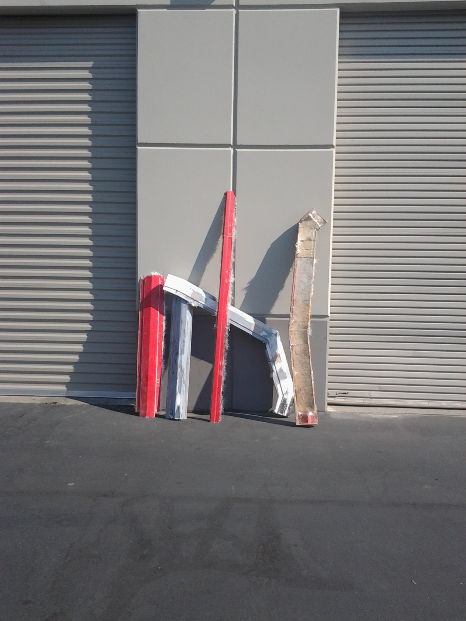

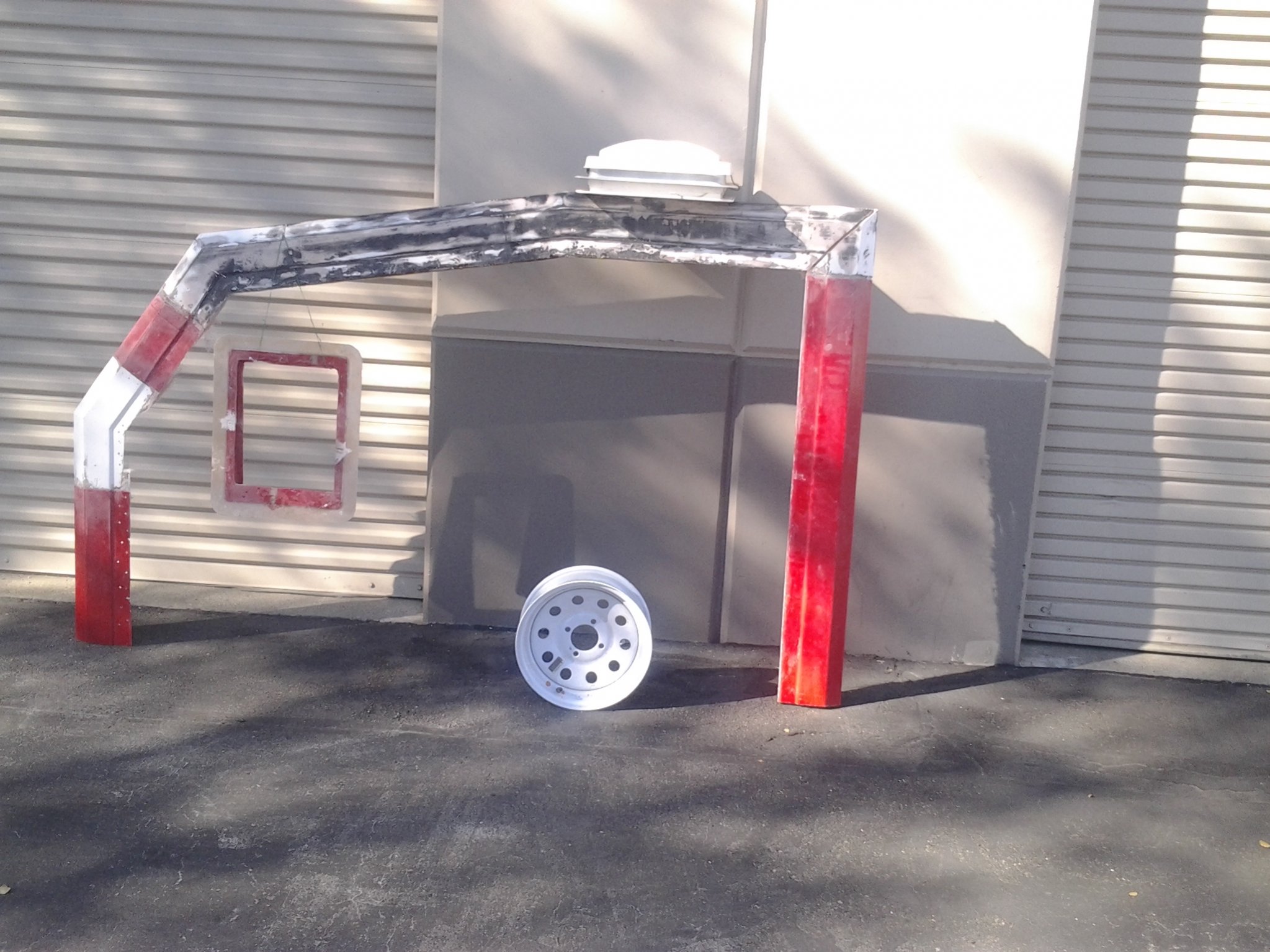

Any sides jeep wheel with big hole will work. . This side with one inch of foam is 24 lb 7 feet long made using rail top fiberglass components
opp
Had few inquiries about information how the fiberglass parts where made. This was used in 1950-60 Became out of flavor when the fiberglass pull extruder came out.
. For using a single profile. Someone has made it in a bathtub, heater, wastebasket, for inside curve.
Then add http://www.homedepot.com/p/Woodgrai...olid-Pine-Lattice-Moulding-10004466/206178822 for the tabs. If you can not find a inside curve.
You can make plaster of pairs casting then added http://wwwe.homedepot.com/p/Woodgrain-Di ... /206178822 to the casting to make the lip. . To release the fiberglass. The plaster is broken apart.
If you have a hard time getting your head around this. Take a box .Place some tape two inches from the bottom on the inside side. On the bottom of the box place tape two inches from the side. You will have tooling .If you pulled a part it will have the reset lip.
For the jeep people look at old bath tubs. trash basket at 99c store It has the older jeep profile.
