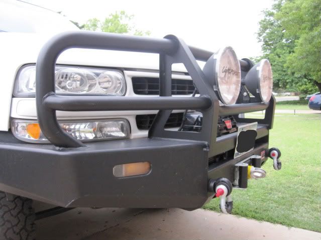

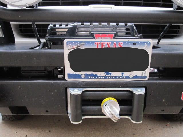

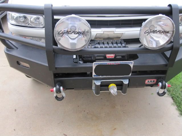

Like cruiserlarry said most of the ARB bumpers do not work for the PowerPlant. The bumpers are made for winches that mount feet forward. I believe ARB only makes a couple of bumpers for Jeeps that will fit the PowerPlant. But, you obviously can modify one to fit it. That's what I did for the ARB on my 2003 Tahoe.

Tahoe and Dual force
That looks good. What did you have to do to modify it? Was it just cutting the a hole to fit the higher profile? Did you have to re-drill or drill the mount ing holes through the base of the bumper so the winch could be bolted down? DO the mounting holes on the bumper match the the mounting holes on the winch?
brasskey

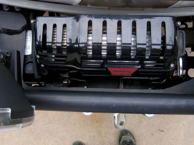

On this ARB bumper it was a few things. First, there was a rectangular plate or door that you could take off to access the top of the winch. This was taken out and the hole that was left was made a little larger to accommodate the height and width of the PowerPlant.
The next part was the most important. Since the bumper is made for winches that mount feet forward, there were not holes on the bottom of the bumper to mount the winch (the mounting holes are behind the fairlead). So, a mounting plate (with four new mounting holes) had to be welded in the correct area in order to line up with the winch line hole. I have a friend that welds for a living, so he knew what he was doing. If you're not fairly familiar with welding, this is where you would want someone that knows what they're doing. As the winch is mounted to this plate, is has to be strong enough to take the pulling force.
That was basically it. Looking back, it's much easier to get a winch and separate onboard compressor. Plus, an onboard compressor has more flexibility (being able to hook up other equipment).
