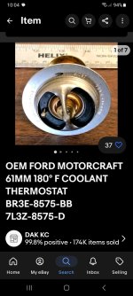

I don’t think it’s a bad idea, add a thermostat to your cart as well. I like slippery slopes for some reason so I’d likely do the radiator if planning on keeping truck into the 200k+.
I will probably do the radiator too but not sure which one to get.
Rock auto has a OEM raptor radiator for 250 and the heavy duty fans for 300 but still trying to figure out it they will work.
